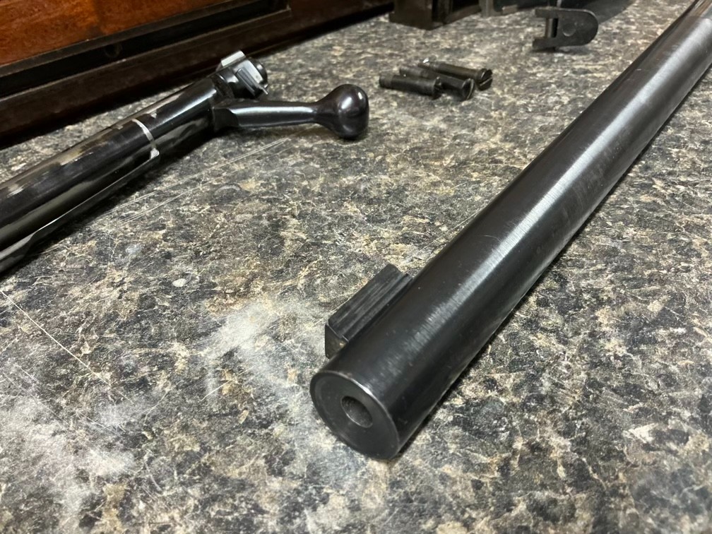

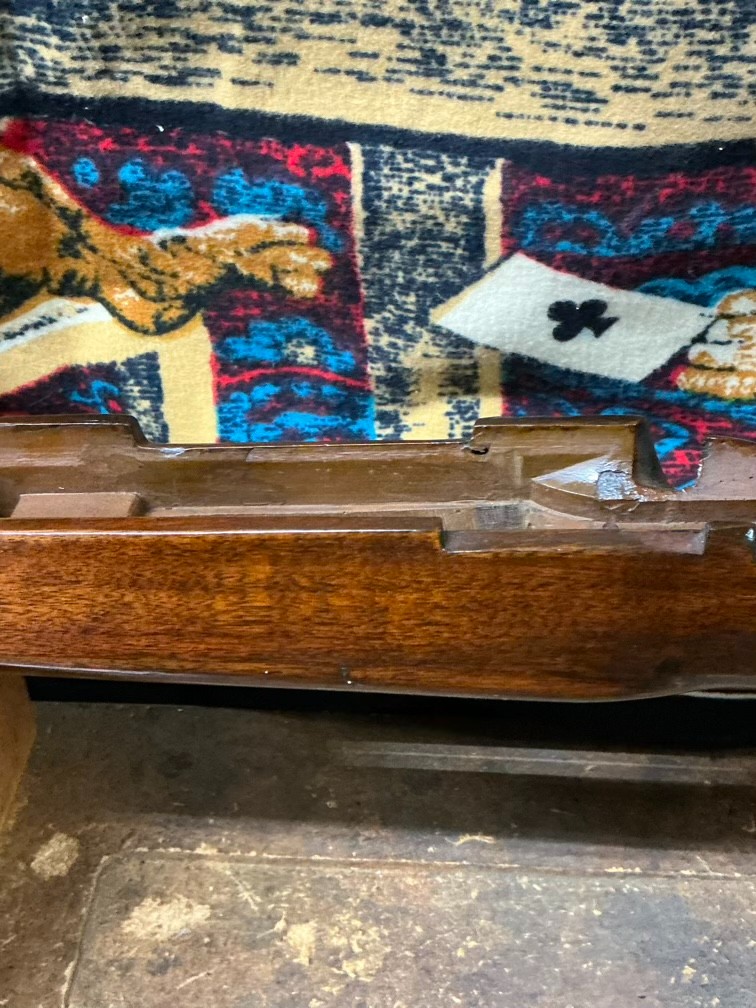

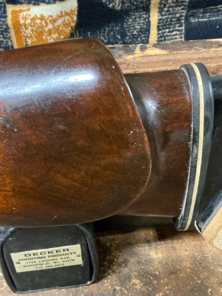

Here are several photos of Chris’ Father’s rifle.  If anyone has any thoughts, speculation, information to share about how the rifle came to be or its use, please contribute.
338764-1.jpg338764-2.png338764-3.jpg338764-4.jpgUnknown-0.jpegUnknown-1.jpegUnknown-2.jpegUnknown-3.jpegUnknown-4.jpegUnknown-5.jpegUnknown-6.jpegUnknown-7.jpegUnknown-8.jpegUnknown-9.jpegUnknown-10.jpegUnknown-11.jpegUnknown-12.jpegUnknown-13.jpegUnknown-14.jpegUnknown-15.jpegUnknown-16.jpegUnknown-17.jpegUnknown-18.jpeg
A couple interesting things…  The S/N 338764 is right in a block of M70 30-06 Target receivers. Actually several Van Orden Snipers that were sold to USART are very close to this one, but this rifle is not on the list of VO serial numbers.  I cannot see if there is a clip slot in the receiver bridge (like a 30-06 Target receiver), but it does have a “T” trigger, suggesting it was originally a Target rifle.  At present, I do not know what the rifle is chambered for, but I’m guessing it was converted to 308 WIN based on the magazine box/follower and the clip loading attachment affixed to the bridge.
I do not (yet) know the length of the barrel, but it’s 0.875″ at the muzzle.  FWIW the M70 Bull Gun barrel (28″ long) is 0.845″ at the muzzle, so this barrel is indeed HEAVY!!!  It might be bull gun contour but shorter???  The non-factory stock is glass bedded at the recoil lug and first couple inches in a way that reminds me of what was done to most of the “US PROPERTY” M70 Target rifles coming out of CMP these days.
All-in-all my guess is that this was originally a 30-06 (???) M70 Target rifle (???) that was rebarreled, converted to 308 WIN, and restocked by US Army armorers (???) for some unknown purpose, possibly related to shooting team training, since Chris’ Father was a shooting coach.  Whether all the changes present today relate to the rifle’s time in the service or not is unknown pending discovery of further information.  How’s that for a WAG????  LaughLaughLaugh

Just a thought here, but I bet it does have a factory stripper clip slot in the receiver, which would be correct for a 30-06 Target mode., and most likely is a 308 now. I see it has an aftermarket clip slot adapter mounted on the receiver which extends a bit further to the front than the factory slot. This would make sense for a 308 which is shorter than an 30-06. The added adapter would put the slot just to the front of the bolt head at the full open bolt position and thus facilitate the charging of the magazine which is also shorter than an ’06.

Only a guess, but I believe that the rifle was made up after it saw service use.  The receiver was reblued after it was marked US Property.  The gun was most likely  a Target .30’06 when it left the factory as others have suggested. The .308 Win Chambering seems right since it was and still is a favorite for tactical or match use.  A chamber cast would be necessary to determine this.  A neat gun that would be fun to shoot.  We may never know who built it, but if it belonged to my Father I would be proud to own it.
