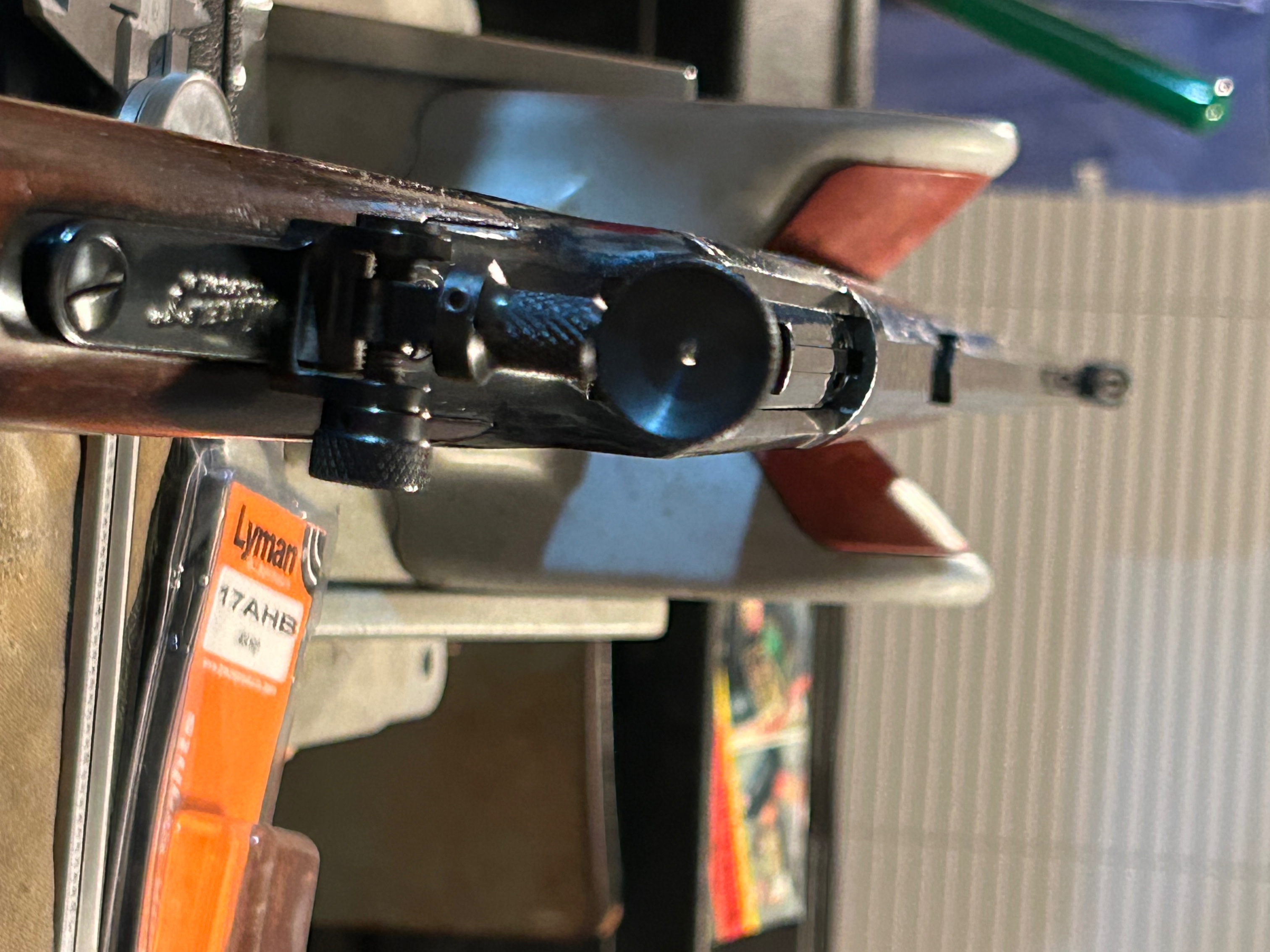

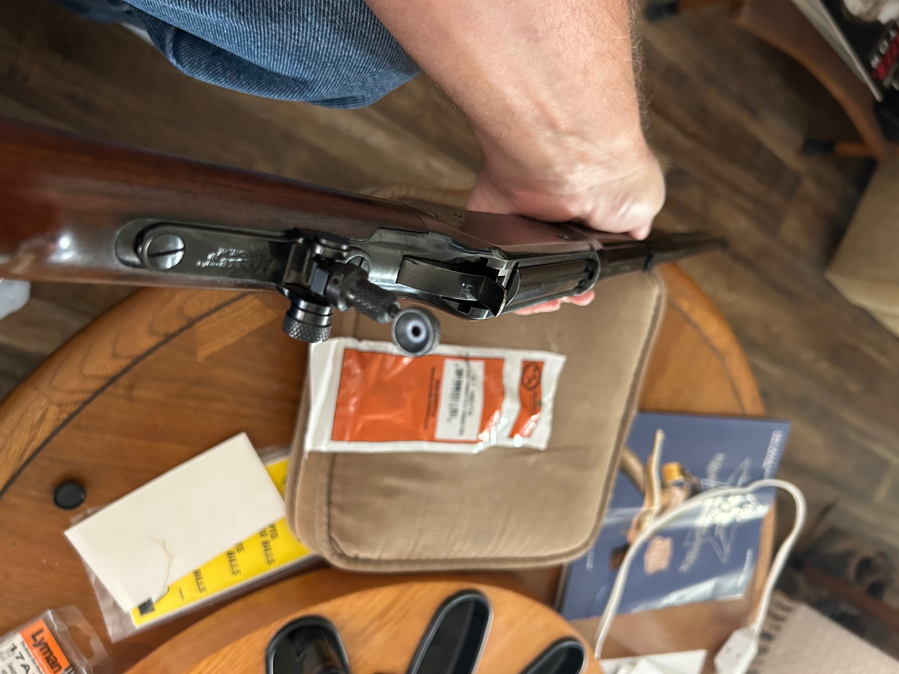

Y’all purists better skip on to the next topic. Zeb and I had a score to settle with some paper at the club today and I had a rear sight disc that I needed to check out. As a result my 52C Target now was a larger rear aperture (5/64”) and my shooter 94 in 38-55 got a new aperture and the lowest Lyman 17 in my parts box. This 1894 (1904 vintage) had a poor quality metal refinish quite awhile back but it has a very nice bore and trigger. Good condition, just not original enough to interest any serious collector. It had a Lyman bead side securely glued in the front dovetail and it wears an older Marble sight on the rear tang. At this rate I may need some more rear sight discs!
Pics below, purists have been warned. This post is for aging shooters who aren’t afraid of accommodating their old eyes with a shooter-grade old Winchester.

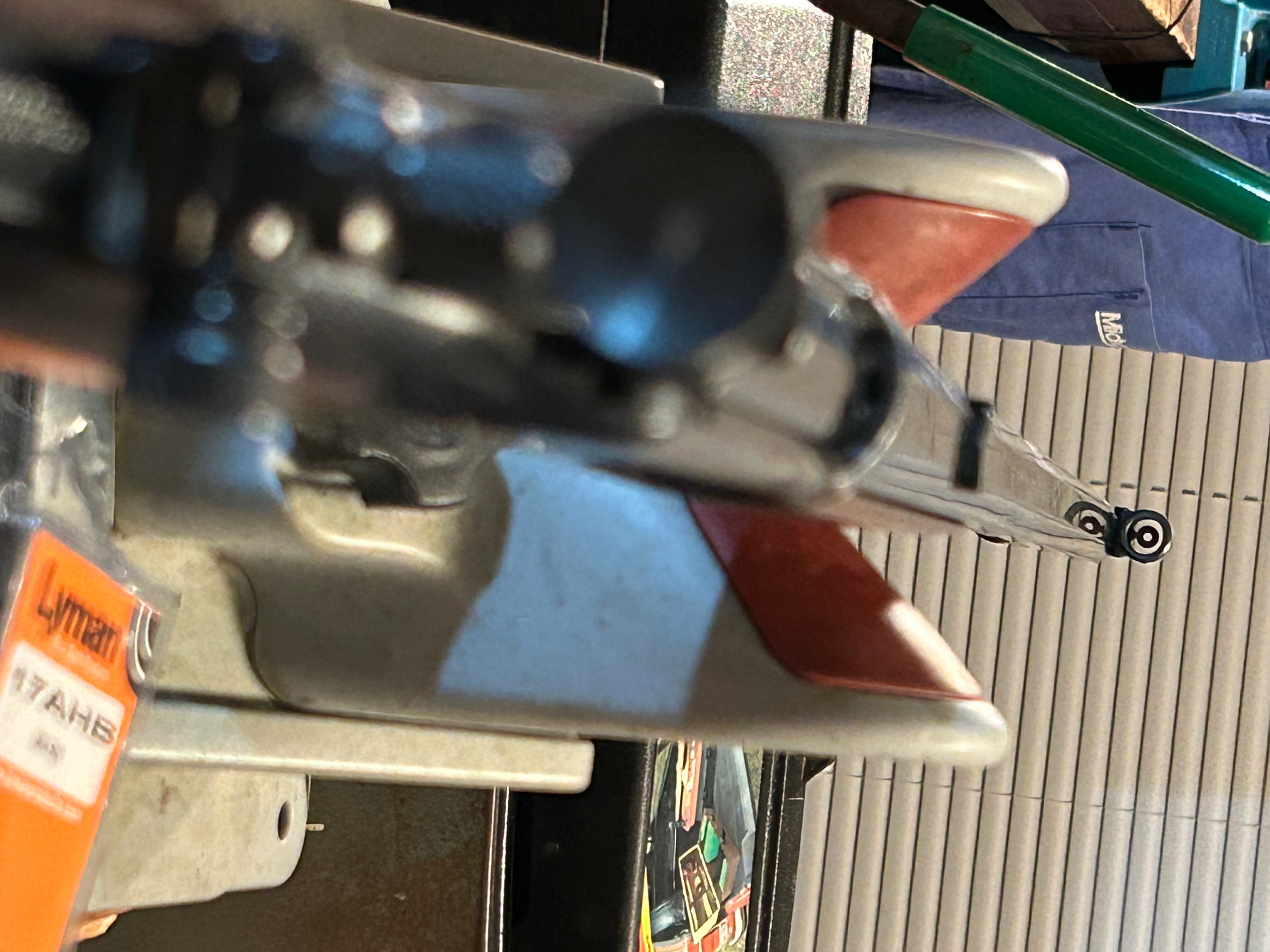

I shot better with a much larger rear aperture and the Lyman bead sight. I had a spare rear aperture with a larger disc which along with the Lyman 17 front sight will give me a very similar sight picture to the one I have worked out on my Target 75. I saved the original discs, I had a few new spares in my parts box to open up. I just finished the alterations, a bit dark and stormy for test firing tonight. Patience, Grasshopper. Wink
Will add pic of the large aperture in a few minutes from another device. It’s more suited to hunting but it told me what I needed to know.

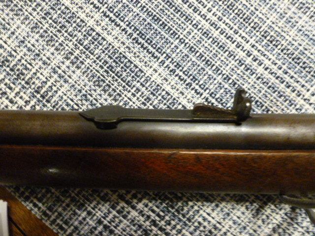

Speaking of sights, is this the correct rear sight for my 1873 Winchester 38-40 rifle (SN 148996 A) DOM 1885 per WACA? Thanks DonP1040631.JPG
Forum Posts: 7785
September 24, 2025 - 2:23 am
Don-
A top view may be more helpful to the folks who can help.
Forum Posts: 6936
September 24, 2025 - 4:25 pm
Looks OK.  But a rear view would help.  This vintage would not have the adjustable leaf.
