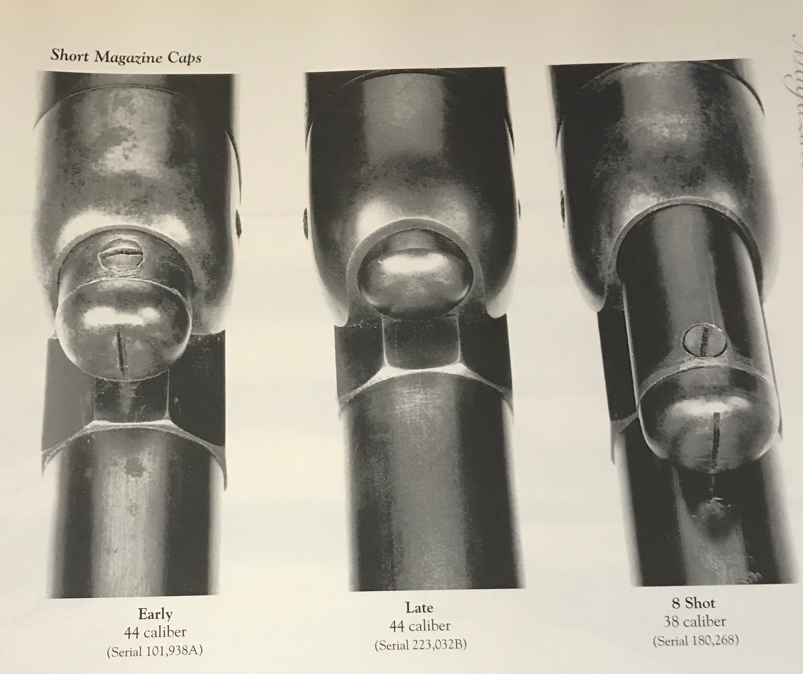

Steve, here is a picture of caps that were offered for short magazines.  The 2 that stick out farther are attached differently.  So your gun was probably made in the later half of the 1880’s or later.

Chuck – that is a very helpful photo.  And you’re right on as far as when my rifle was made.  My factory letter states it was shipped on 5-21-90.  Also specifies the 38 caliber, octagon barrel, plain trigger, case hardened and 1/2 mag.
Lately I have learned that a lot of things happened in the mid 1880’s to most of the Winchesters.  It makes me wonder why?  Maverick helped out with info on forend caps for a 76 a member is restoring.  Come to find out the same happened on the 73’s too.  We also found out that stocks were changed from thick to thin in this period.  I wonder what other changes were made during this period?  Was there a cost cutting program or were they just trying to be more efficient?  I now know why I had such a problem finding a butt plate for my thick wood 1887 shotgun that was manufactured in 1889.
