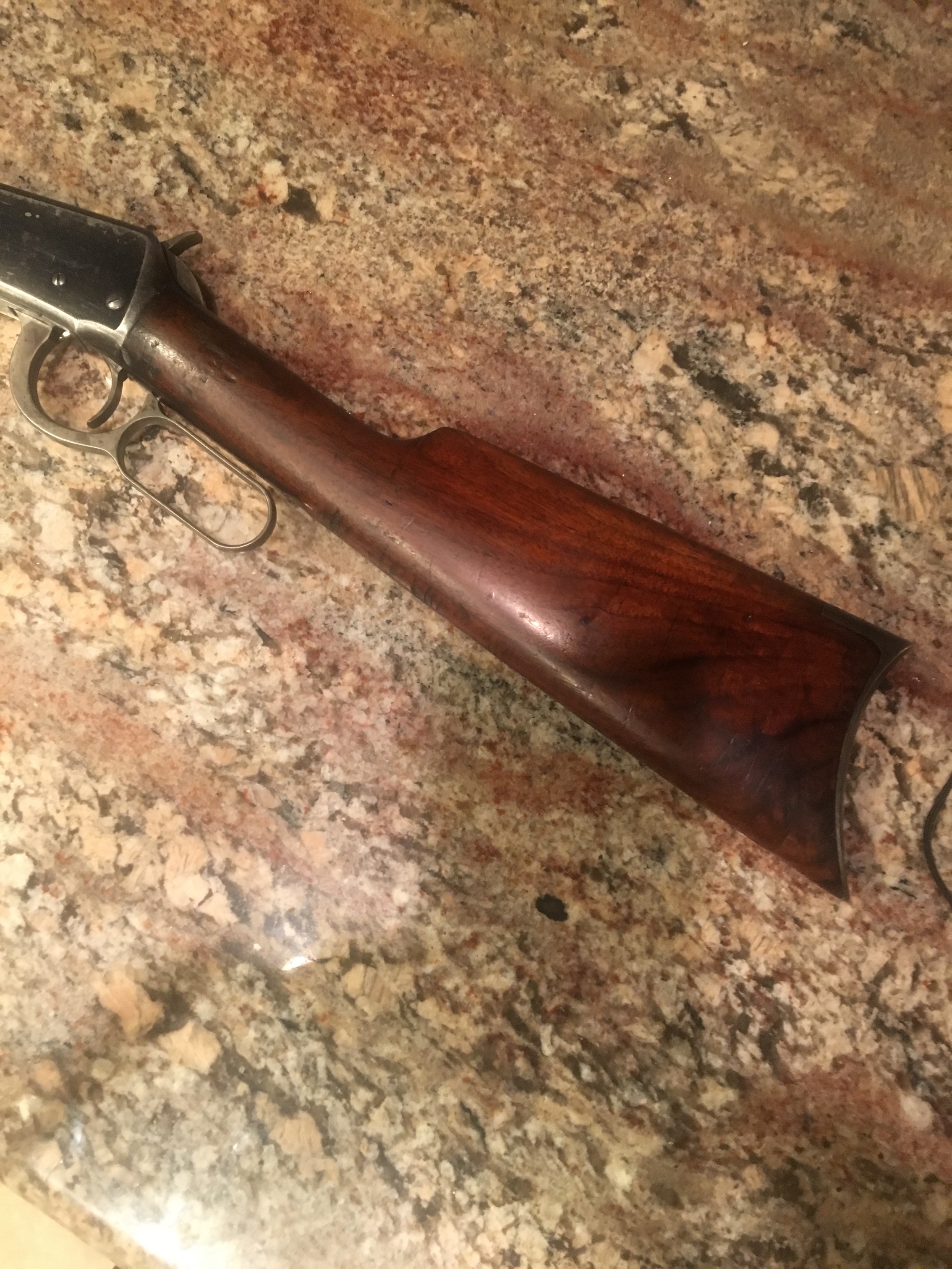

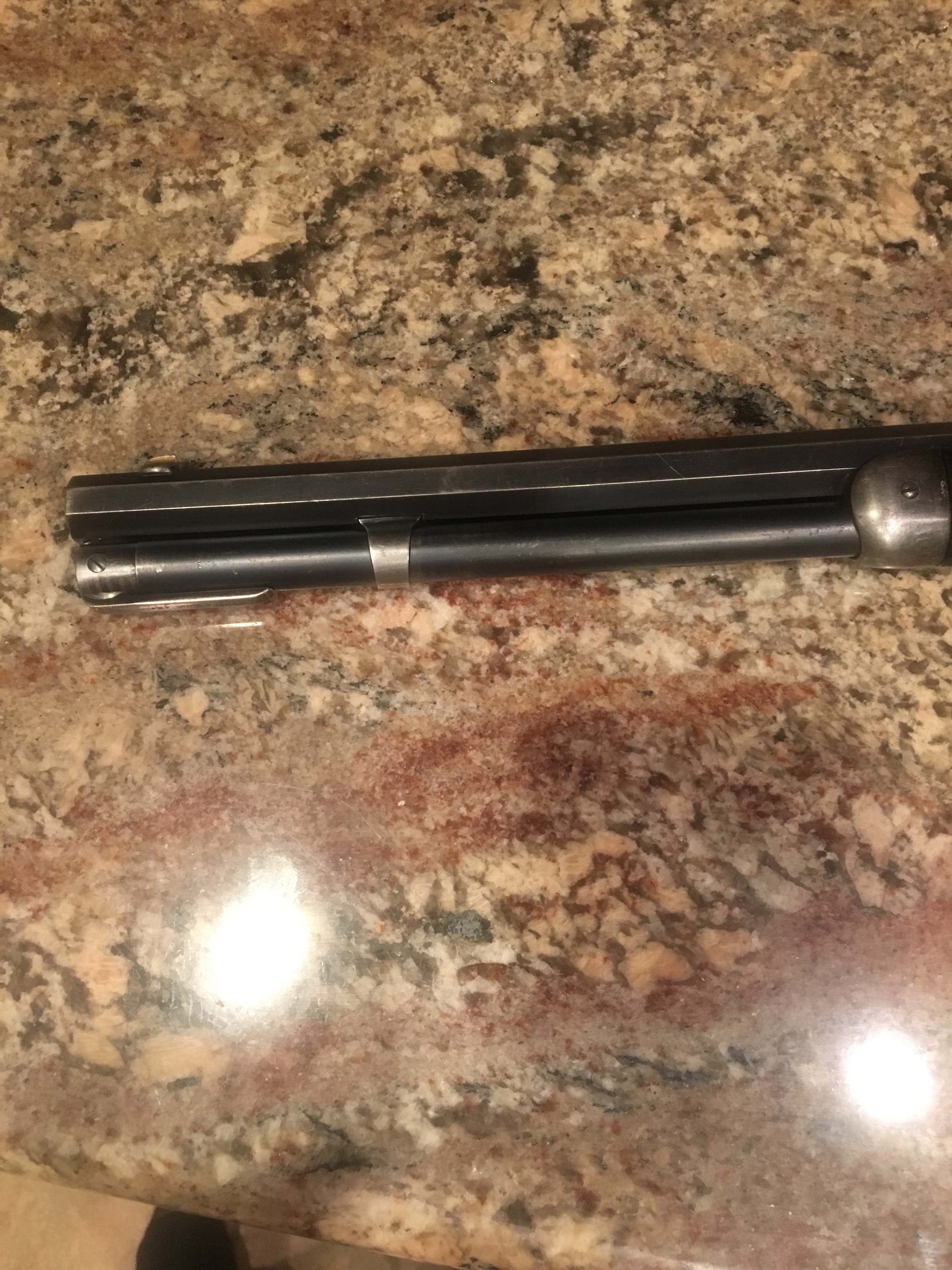

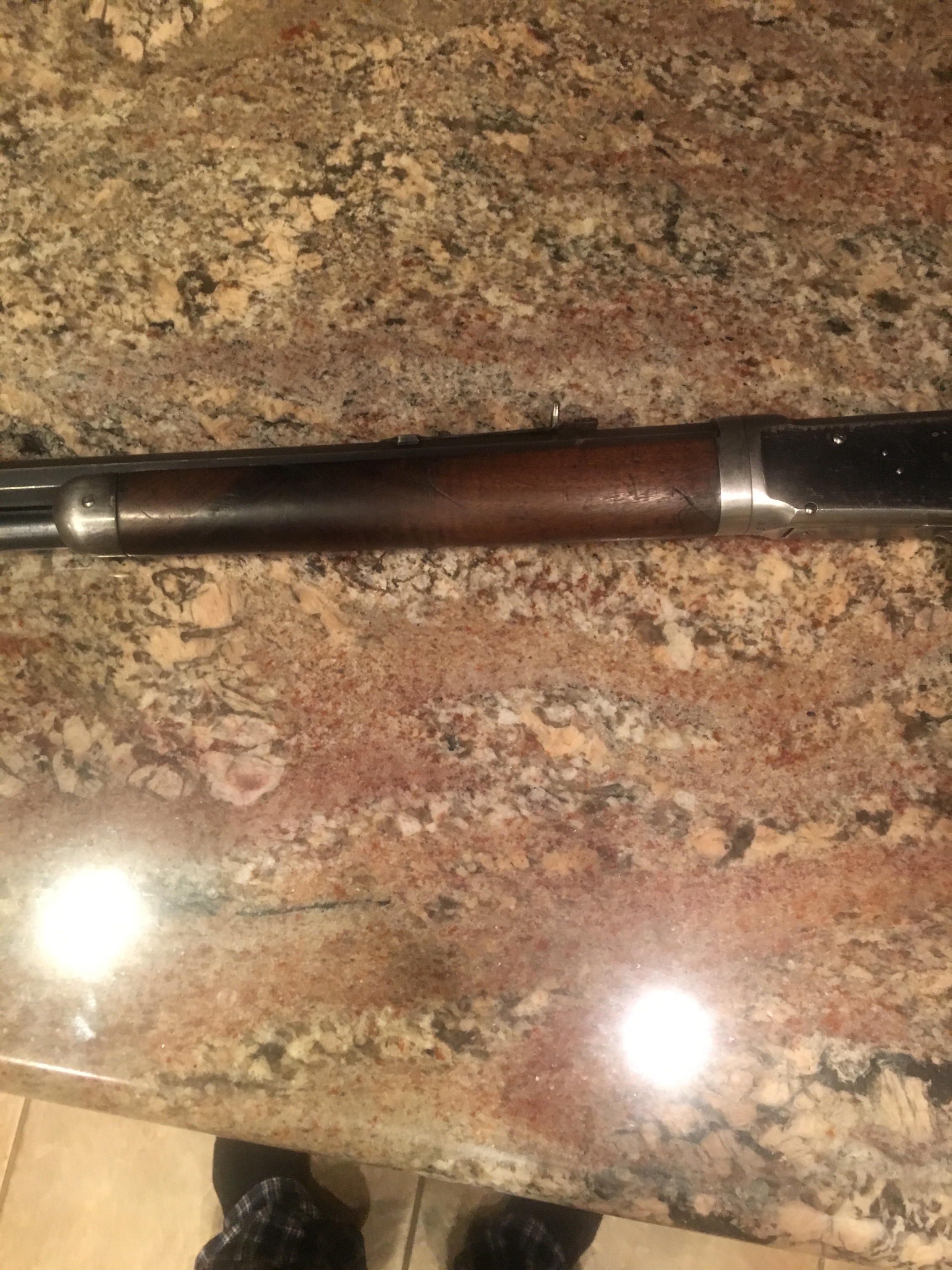

IMG_3826.JPGIMG_3827.JPGIMG_3828.JPGIMG_3829.JPGIMG_3831.JPGIMG_3833.PNGI recently acquired a model 94 Short Rifle, take down Model in 32-40 caliber.
it has a letter verifying characteristics and Year of mfg.  Serial 341052.
my question is:  Is there a way to determine how many like 94’s in this variant were produced.
rear sight is 5″ from receiver.
forearm is 9 3/8″
front sight is 1″ from crown
Barrel is 20″

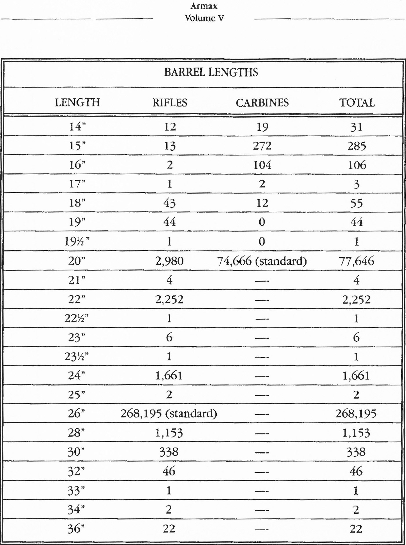

How long is the barrel?  I was surprised the museum letter didn’t specify the barrel length.  I’ve seen M1894 short rifles with barrels from 14 inches on up.  Is there one length that is considered, “standard” for a short rifle?  By the way, very nice-looking and rare/desirable rifle Cool
Steve,
The common “short rifle” barrel length was 20-inches, though there were a lot of them made with a 22-inch barrel, and a fair number with a 24-inch barrel.
This is the what was recorded in the ARMAX survey;

With the 9 3/8″ Forearm I would guess the rifle is a standard rifle off of the rack cut down to fill an order. Look at the front sight dovetail cut and the rotary magazine tube holder cut and also the end of the magazine tube to see if they are in the white and beautifully hand dressed to remove burrs from the cuts. The muzzle may have a hand cut chamfer on the edge as well. It is my opinion that the long forearm short barreled rifles (that are factory original) were cut down from rifles in inventory when ever possible or expedient to fill an order.
Bert –
Thank you very much.  I really enjoyed viewing this table.  The biggest surprise to me is that the 19 inch barrel length is not as rare as I had thought (with 44 in the survey).  Another big surprise was the 16 inch barrel length is much more rare than I thought (only 2 in the survey).

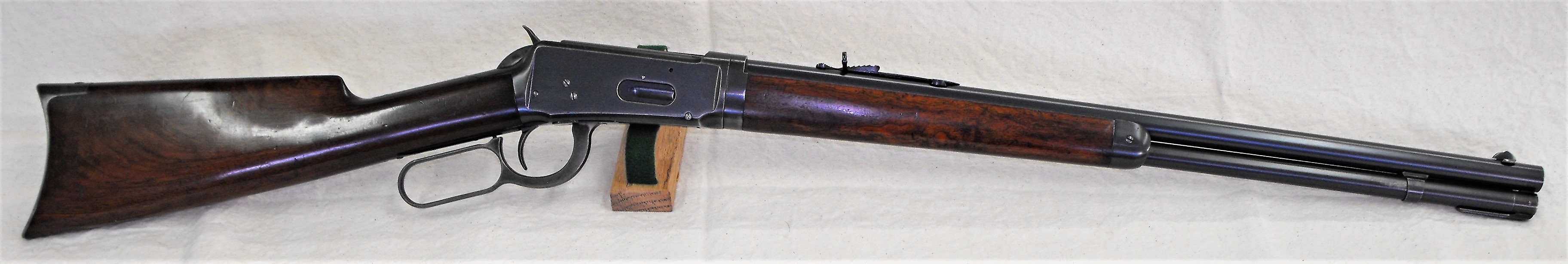

Here is a 32-40 TD I have, but with a 22″ barrel……….. wish it was 20″ like yours.
