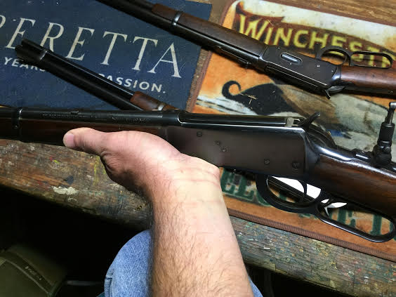

94tang.jpg9442.jpg1st two are the July 42 M94. The last two are the 1946 flatband  4694.jpg4694tang.jpg

 close up of the Flat band Lyman sight, As I said probably not original.Frown

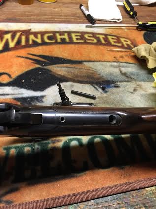

Take the tang sight off and inspect the upper hole.  Most people can not drill & tap the hole as cleanly as Winchester did.

Big Larry, in the bottom shot the one im holding is  1380733  1946 in 30WCF , next up is 1340492 1942 in 30WCF and the other one at top on bench is the “w” marked 1242437 1940 in 32 W.S.   Still looking for a 25-35WCF 94 to come along.

I attached a pic of the Flat band without the Sight attached.fbtangscrew1.jpg
