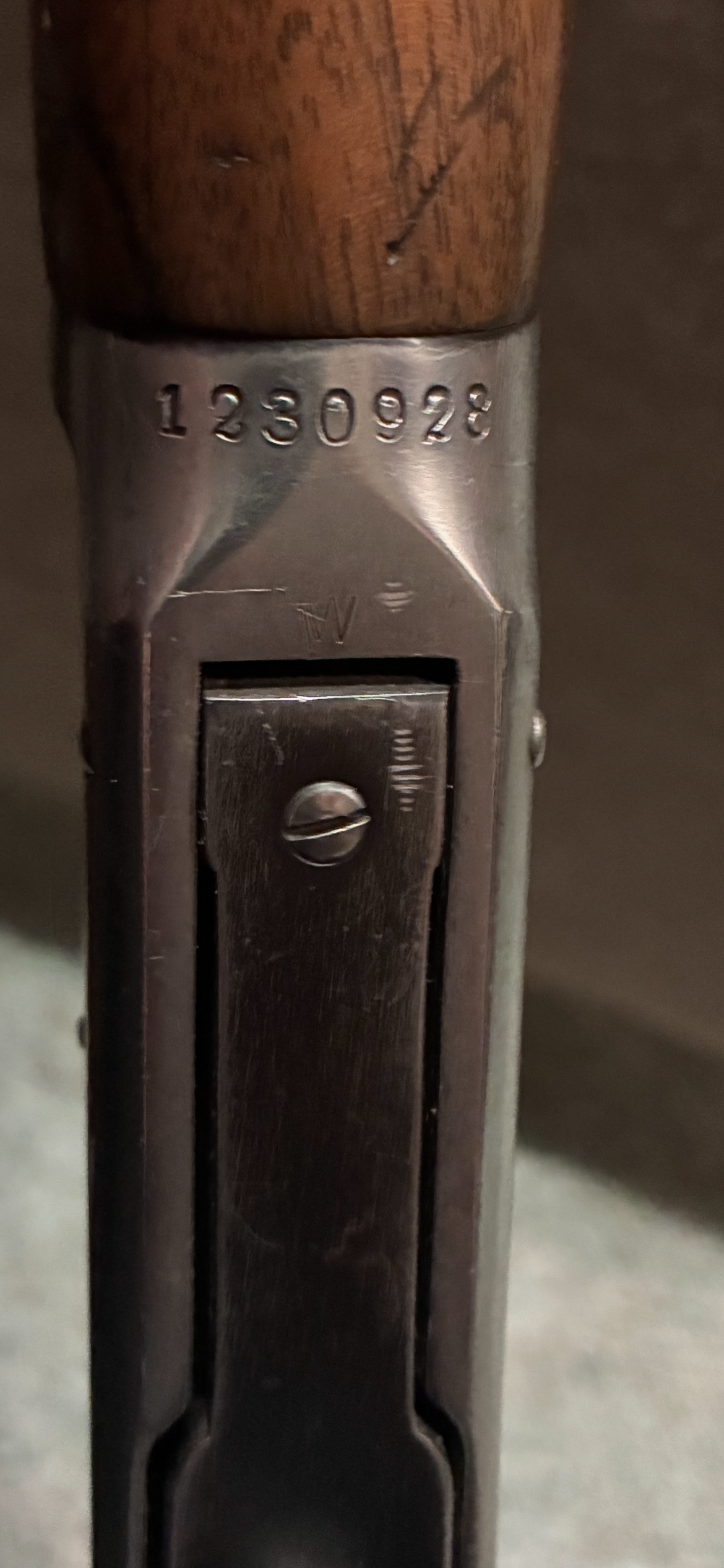

IMG_6728.pngWas going through some model 94s this evening and saw this W mark on the bottom of one rifle. It looks to be just the standard rifle.
April 15, 2026 - 3:52 pm

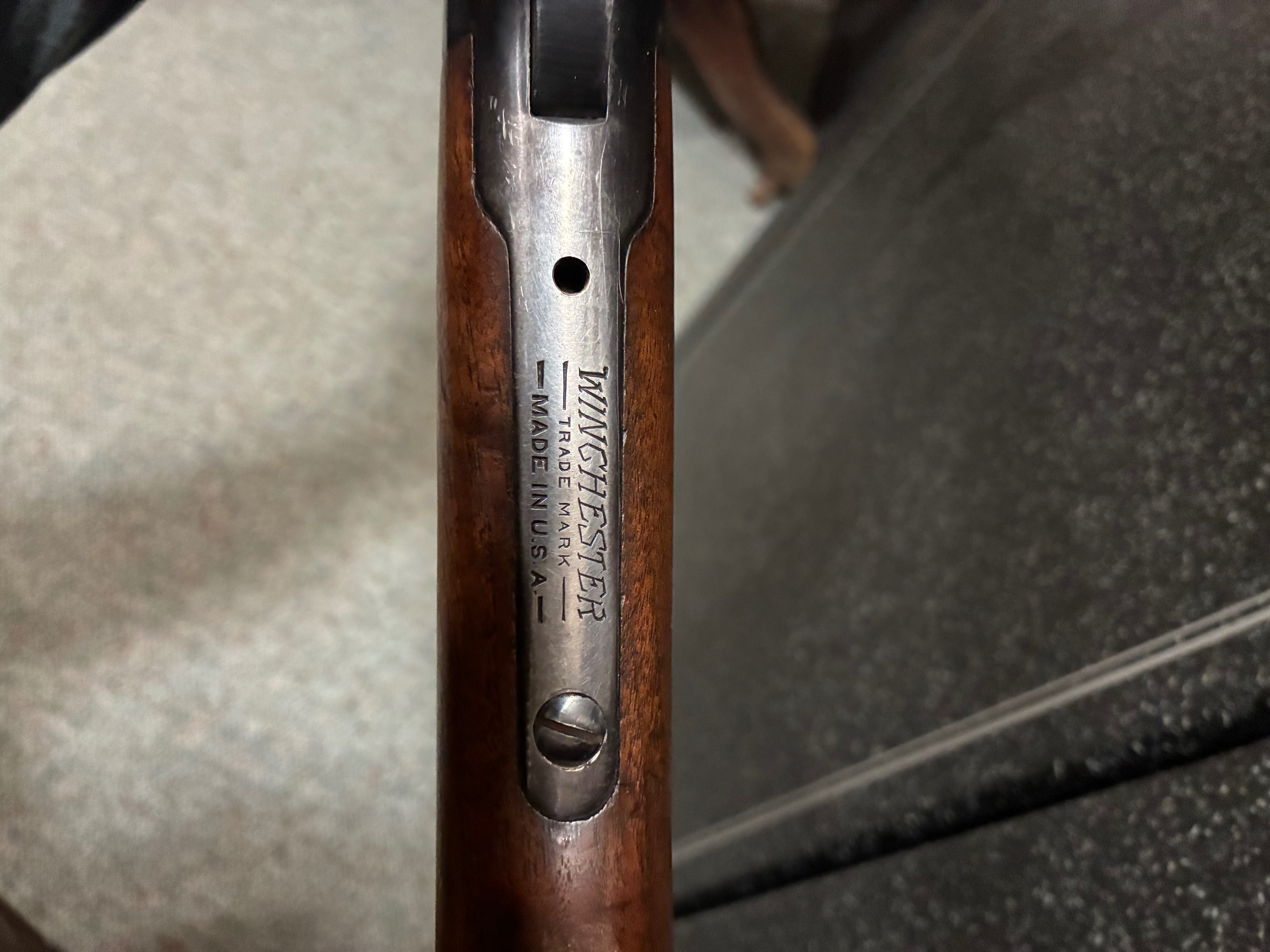

Winchester stamped the “W” on many thousands of Model 94 (and Model 64) receiver frames from February 1939 through February 1941.  Serial number 1230928 was a manufactured in June 1940, and it is more than likely a standard Carbine.  Can you post a picture of the factory roll marking on the upper tang?  I suspect that it has a Type 6 marking, but it could be a Type 7.

Type 6 UT marking…
Thanks for the pictures.
