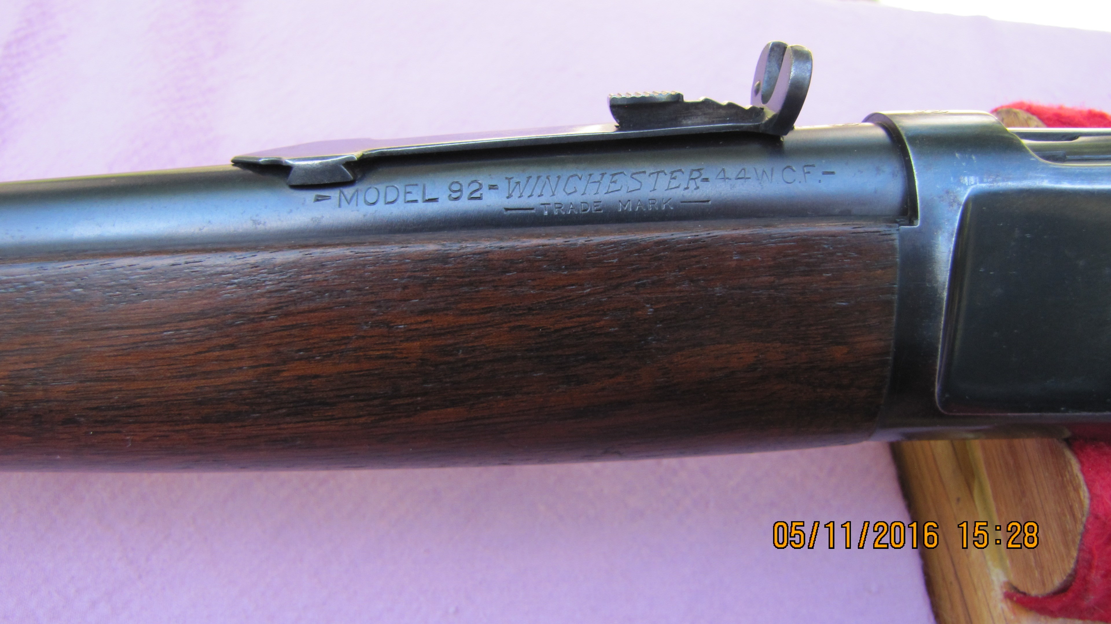

Does anyone have any information on 92s with ramp front sights?   These three do not show the usual re-done characteristics and all are from pre 1920.  Is it possible they are from a ‘parts clean-up’ period?  The only barrel date I have checked is the 44 with the 1/2 mag, ’38 barrel date.  The bottom gun is pictured in the 1892 section of the ‘Madis Book’.  I showed Mr. Madis this gun at his last Reno Show and he wrote a note in my book clarifying the incorrect serial posted in his book.
Top Ser. #668706  Center Ser. #765249 (Has bolt peep)  Bottom Ser. #873505 (not 87350 as in the Book)
Any ideas?
Thanks,  RDB
