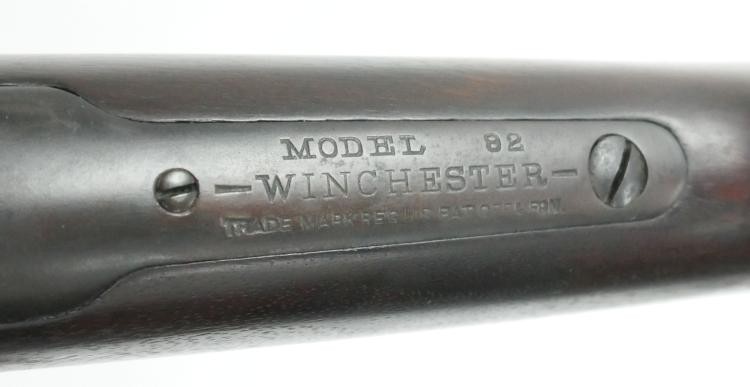

Looking at a 92 src from 1926, yes I checked our dating tool here. The model is stamped in the barrel with the caliber. However it is also model stamped in the tang. Is this correct?

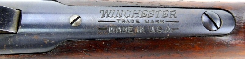

Based on what I have observed, a 1926 production Model 92 should have a Type 6 UT marking…
Just to double check, a 1926 production Model 92 should have a serial number in the 938034 – 955600 range.

Hopefully Michael (2bit) checks in on this topic and provides his educated input.  I certainly would not expect to find that UT marking on a late 1926 production Model 92, but stranger things exist.

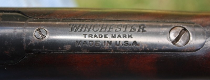

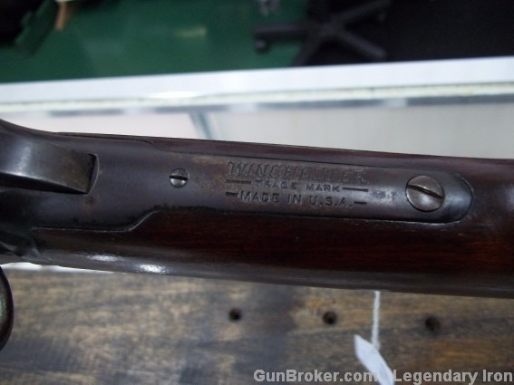

I was traveling for a week without my computer and I am trying to get caught up.  That Model 92 is absolutely correct.  And pretty nice looking.  The Model 92 upper tangs were consistently stamped with the Type 5 style right up until the Model 53 rifles began being numbered in the Model 92 serial number sequence (right at the end of 1927) at which point they pretty abruptly begin to use the Type 6 style.  But then in 1928 you can find batches of Model 92’s with Type 5, 6, and 7 upper tang stamps.  It is a mess in that year!
