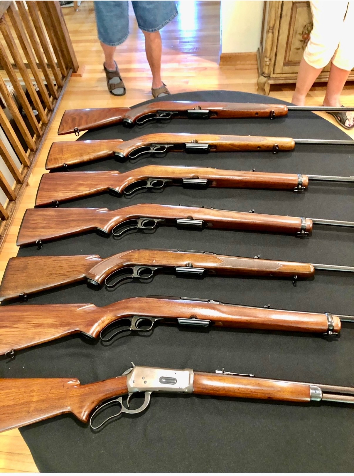

He had a high condition model 88 in both Rifle and carbine in every caliber.  I’ve purchased a couple of the rifles already, but he has one carbine that sits in a hand checkered stock.  Is there any way this could be factory correct?  Everything that I can find on the 88 carbine has no mention of hand checkering.  Possible to special order?  If so, would there be any way to validate?  This is the only photo I have…. The carbine is third from the bottom.  I’ll take a closer look and more photos tomorrow.

I see 7 items in the photograph, of which 6 are Winchester Model.88s. Of the 6, I see only 3 with carbine barrel bands and none of the 3 appear to have checkered stocks. The photograph does not show full barrel lengths.
The third from the bottom is a rifle, not a carbine. Does it have a shorter than standard length (22″) barrel?
Yes, it has the carbine length barrel.

The stock on the rifle that is third from the bottom is not a carbine stock. It is a standard Model 88 rifle stock. The forearm is not milled for a carbine barrel band nor does it have a barrel band.
Could you please photograph the muzzle end of the barrel close enough to see the front sight and its ramp.
Is there any feature of this rifle other than length of barrel that indicates the barrel is a factory carbine barrel rather than a rifle barrel that has been cut back, re-crowned, and had the sight ramp sweated to the shortened barrel?
I’ll let you know after I visit him tomorrow 😁

In my opinion someone’s put a rifle stock on it. Easiest way to tell is take the action out of the stock and see if there’s 2 dovetails up front under the stock. Rifle and carbine stocks are not interchangeable and this must be done to put a rifle stock on a carbine. The other option is make a new hole in the front of the stock where the front bolts on. The other option the barrel has been shortened and sites put back on and touch up blue but hard to tell in the pic. Best bet take the action out of the stock and you’ll know for sure. I have seen this done a few times it’s easier to find a rifle stock than a carbine stock
Just my thoughts anyways
