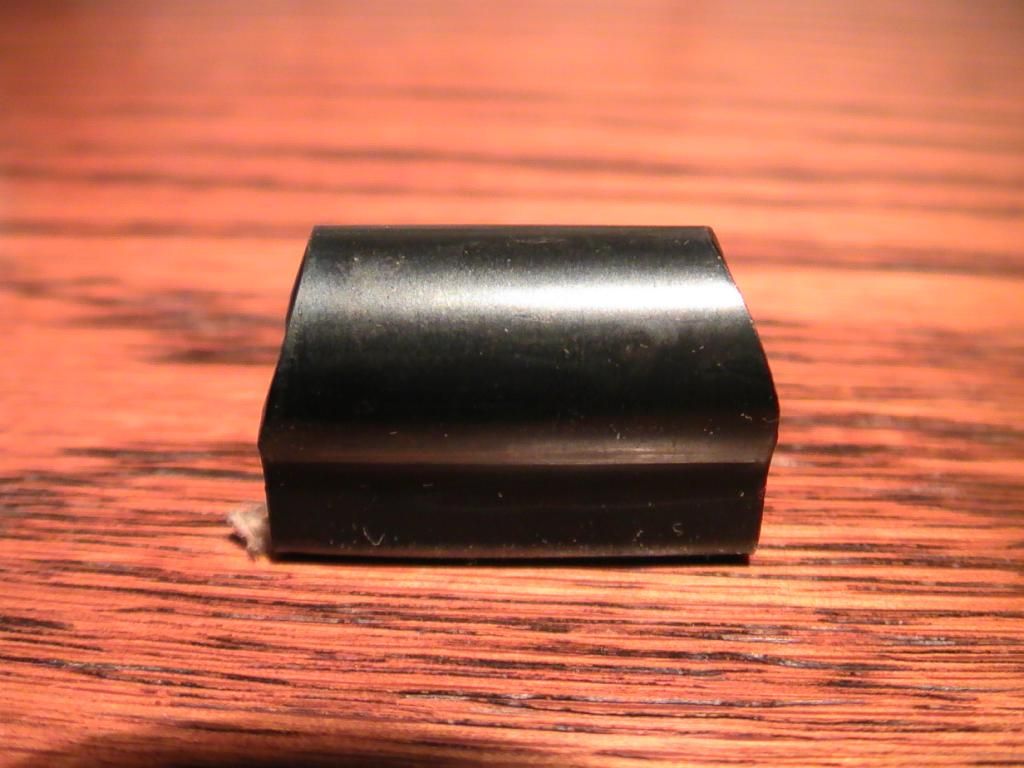

This is the hood I purchased off ebay. Does it look correct? The height is 0.665 inches, a little shorter than what you described as being correct. Thank you.

I don’t think it’s the right one.
