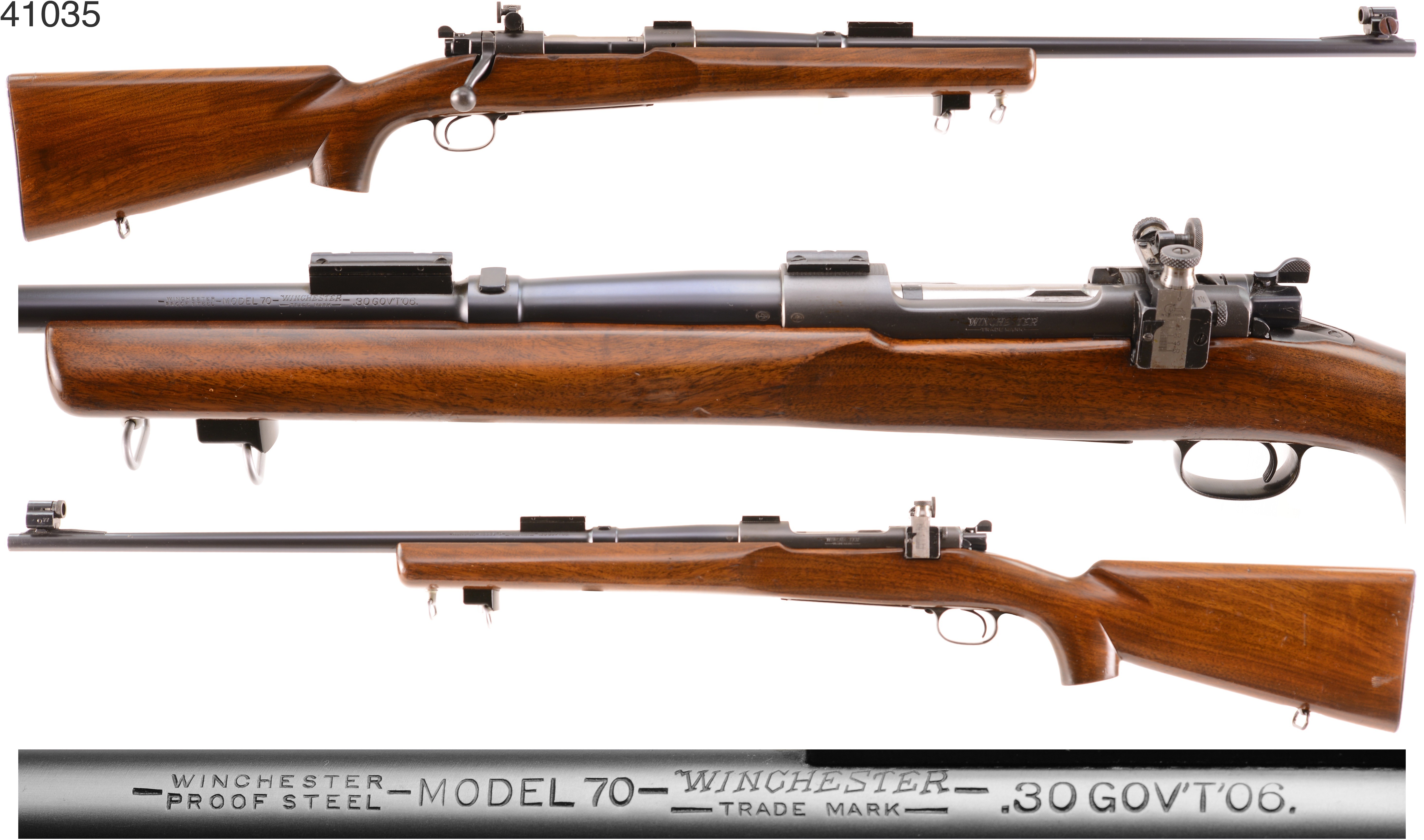

Your Model 70 is a National Match rifle.  The barrel is what defines it.  The National Match was built using a 24″ standard contour barrel with a unique low front sight ramp that is not grooved on the sides to accept a sight hood and drilled for a barrel mounted scope block forward of the rear sight boss.  The rifle would have originally had a pair of telescope sight bases; one on the barrel 0.470″ tall, and the other on the front receiver ring 0.185″ tall.  Similar to this one (s/n 41035)…
The front sight is a Lyman 77R globe installed using an AK height cross dovetail block. This was the factory sight.  The receiver sight is probably not original, as it is an early (circa 1947-49) “half block” Lyman 48WJS with the flat return spring on the left side.  The factory sight would have been a Lyman 48WH, which looks the same except for a 0.100″ “step-up” in the cross bar.  Is the stock inlet (square cut-out) for a “full block” receiver sight?

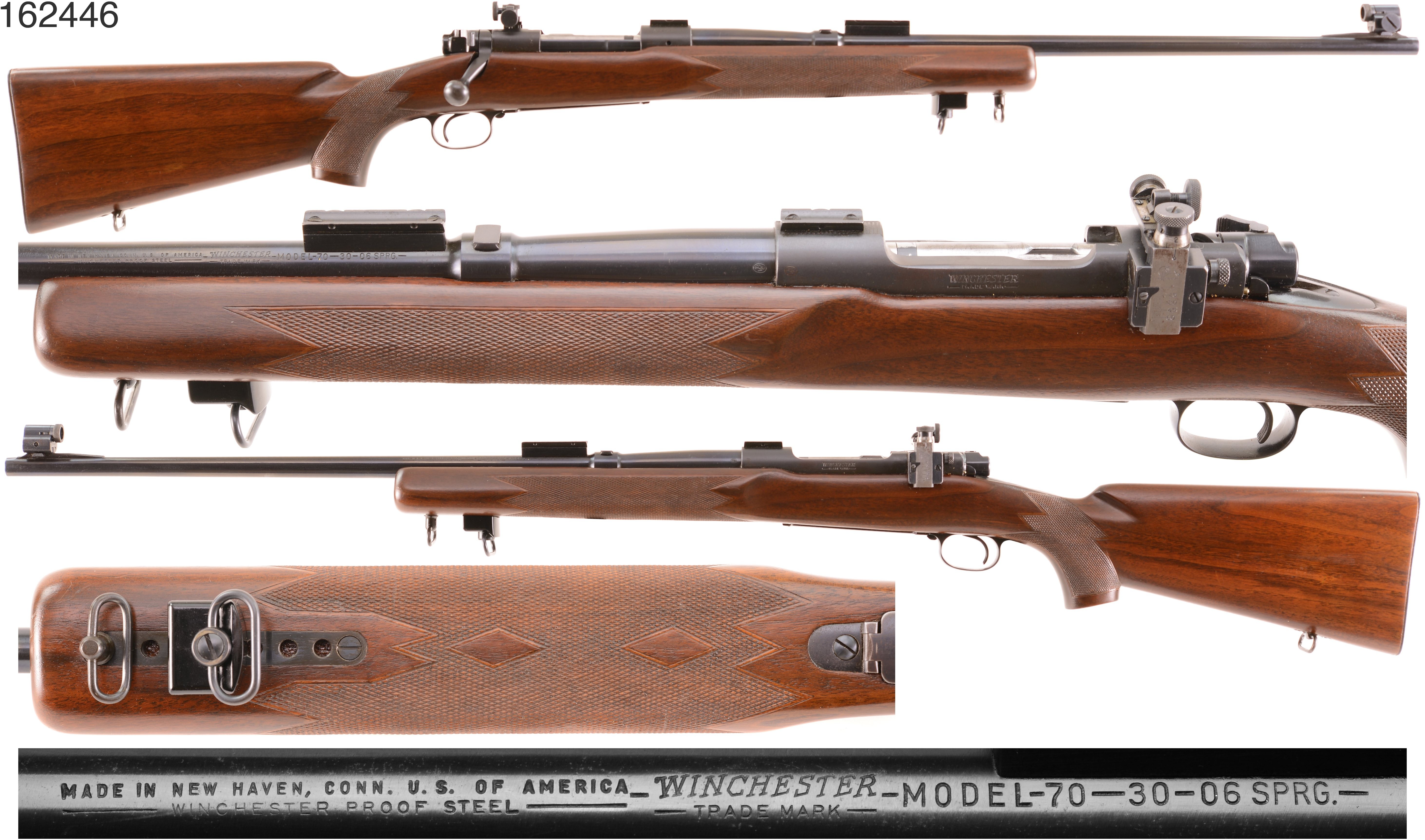

Your rifle appears to have a modified Winchester Marksman stock.  It does have the hand stop adjustment rail in the bottom of the fore end, but I believe that the fore end has been slimmed down somewhat (the usual Marksman fore end is about 2 3/8″ wide) with added checkering.  Such modifications were quite common on target rifles.  Marksman stocks were not regularly checkered, although checkering could be ordered.  When they were checkered it typically looked like this (s/n 162446)…
