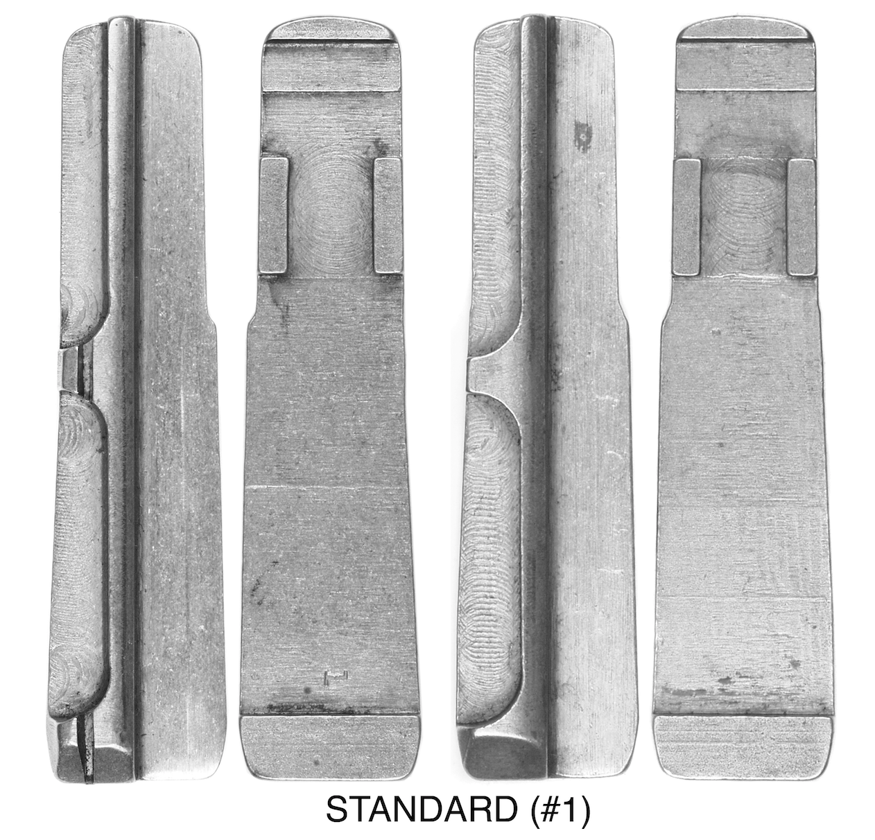

I have a pre-war configured M70, mfg’d. in 1946.
It has a follower that has “the mystery mill-cut” thru the two ribs. (As stated in Dean Whitakers’ book, page 86)
Has anything come to light lately, explaining the reasoning for this cut?
Thanks-a-bunch.
Forum Posts: 1540
February 3, 2026 - 10:16 pm
Jim-

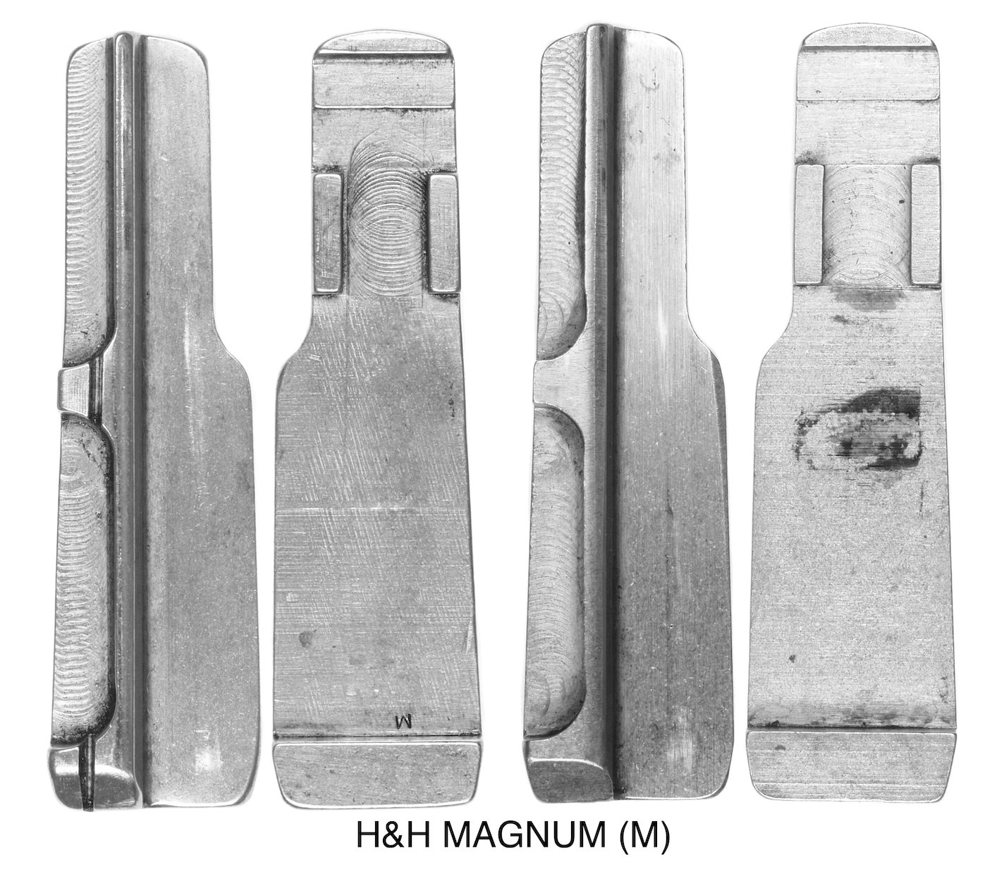

My understanding is that those slots were used to secure the metal block (work piece) to a fixture during milling operations.  They serve no purpose in the finished part. I guess Winchester came up with different fixtures by the time they were making parts for M70s because they usually turn up only on some (very far from all) pre-war M70s.  It would not surprise me at all to see one on a 1946 gun, however…
Are these the slots you’re talking about?  Pics are of Standard and Magnum followers each with/without the mill cuts.
Jim F in CT
Forum Posts: 103
December 13, 2006
February 4, 2026 - 1:21 am
Yes, Lou . . . .
Those are the slots I’m referring to.
Thanks
