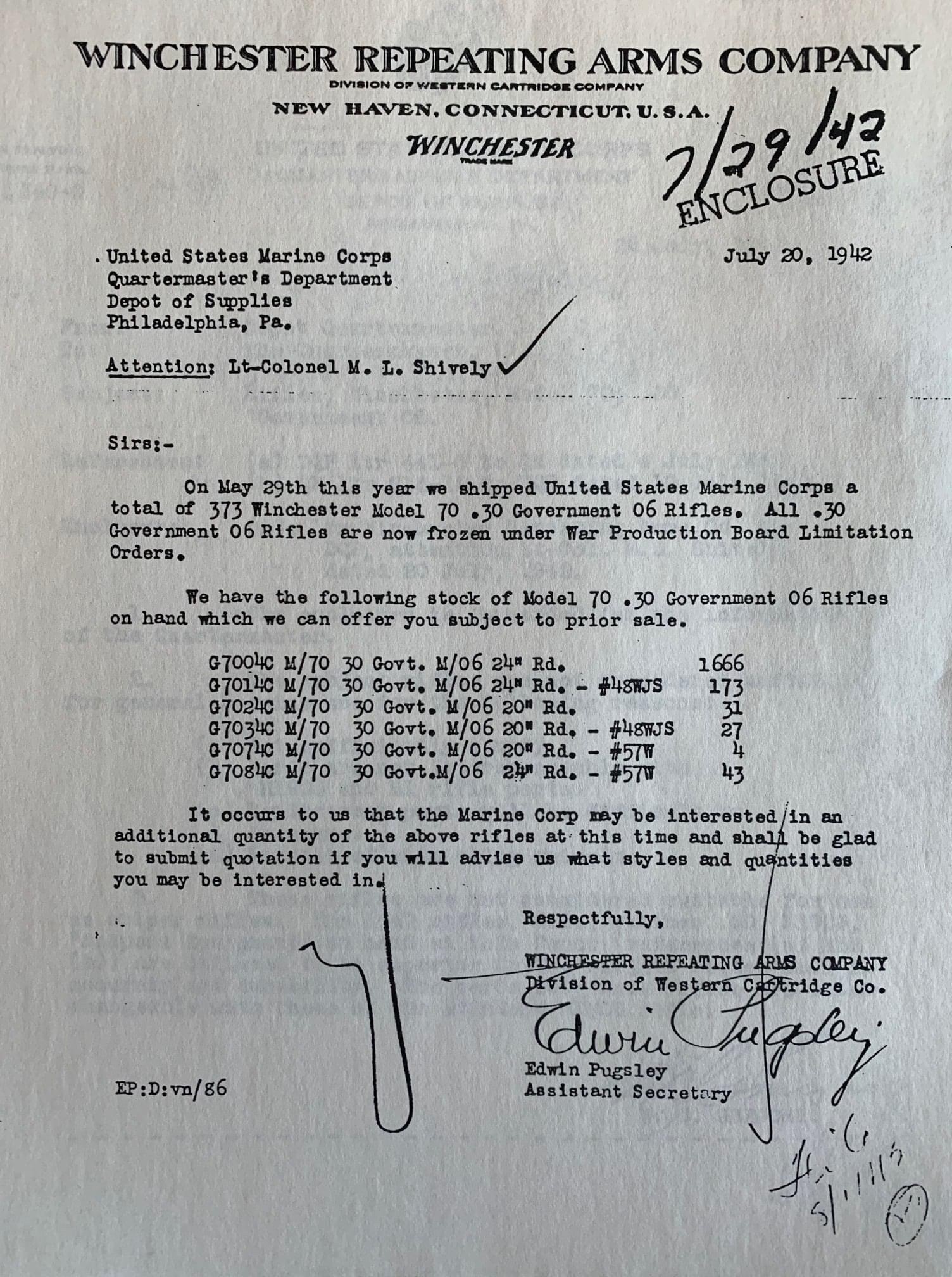

The only source of information on military purchased Model 70s during WWII (by catalog symbol) that I’ve found is in the Quotations and Orders ledgers.  These do not cover later sales of target rifles for Marksmanship Team use or anything acquired from Evaluators Ltd.  The ledgers don’t go past 1945…

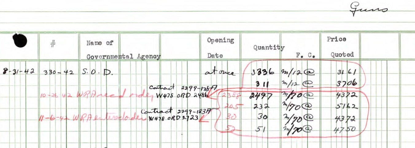

Look closely at the clips below…  FWIW… G7004C is a 24-inch barrel 30-06 Standard Rifle with 22 GG sight, G7014C is one with Lyman 48WJS sight, and G7084C is one with Lyman 57W sight.  Important to note is that when asked, Winchester QUOTED prices on everything they had available in inventory (new production having been frozen), but the ORDER received (if any) is what’s written in red.
First is the quotation for the (373) rifles USMC ordered April 24, 1942.  While Winchester QUOTED prices on Carbines, what USMC ORDERED was (260) Standard rifles with 22G and (113) Standard rifles with Lyman 48WJS.  No carbines…
The (373) number from the USMC order was confirmed in a letter from Edwin Pugsley to USMC on July 20, 1942.  He lists still available inventory, including carbines, but there is no evidence that there were any follow-up USMC orders.
The wild card is a record of an SOD order placed on November 6, 1942 that suggests that the Military ordered an additional (2674) Model 70s.  This ledger entry does not include catalog symbol.  So if any M70 20-inch barrel Carbines were sold to the US Government in WWII it would have likely been part of this order.  You can’t draw much from the prices in the quote (except that prices went up), since rifles and carbines were priced the same.
Unfortunately, there is no follow-up documentation that I’ve yet found either to clarify what was sold or even whether the order was actually filled.  If it was, then there would be over (3047) WWII “military” Model 70s.  Which would mean they aren’t exactly “rare”…

G-7024C to S.O.D.                   8/31/42 QTY. 30 -11/6/42 rec’d order Order number W478ORD2723 2299-183-A
G-7024C to Anniston Ordnance 4/29/42 QTY. 200-  (with note at once ) Order is a hyphen or continuation of the previous order number.
So I believe the in the ledgers 4-13-42 ” the vertical hyphens are a continuation of the same order which included carbines G-7024C & 7034C (QTY. 39) in the ..USMC 4/13/42 WRA rec’d order  NOM 35297 2299-59A 104
You will also see symbol code  Carbine G-7034C  ( 48wjs)    written in pencil on last document WRA received order QTY 27 which supports the vertical hyphens are a continuation of the same orders  the number quoted 27 matches the number received.

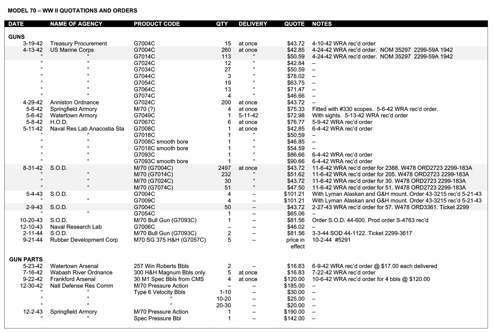

Like I said, that 11-6-42 order is the “wild card”…  Catalog Symbols are not listed on that quote, we can only “guess” (from the quoted price) that the (81) rifles you reference are G7024C and G7034C.  It may be true…  Laugh
Given that you mentioned the 4-29-42 Anniston quote, I’m presuming either that you’ve been through the ledgers yourself (they are available via the McCracken Library digital archives) or you found a Table I put together a couple years ago and posted on this site.  In that table, I added the (parenthetical) catalog symbols to the S.O.D. quotation.  It was my “guess” based on the quoted price.  The actual ledger entry is what I put above…
For others, here’s the table.  Everything I found in the Quotations and Orders ledgers pertaining to M70s:
As for the Anniston quote, there is no subsequent entry in the ledger indicating that an order was received.  As I interpret the ledger, the only orders recorded as received were the 4-24-42 USMC order (NOM 35279 2299-59A 1942), the 11-6-42 SOD order that MIGHT include (81) carbines (W478 ORD2723 2299-183A), and a subsequent 2-9-43 SOD order for (50) G7004C.
I have not followed up on this by trying to track down the Government Contract numbers on the National Archives side.  If they could be located they might clarify what the guns were.  If anyone is facile with finding WWII Government Contracts, PLEASE let me know…  The truth (may) be out there!!!  Laugh

More importantly, what did the Arsenal need 257 Roberts barrels for, did some general need his hunting rifle upgraded at government expense? LOL
5-23-42
Watertown Arsenal
257 Win Roberts Bbls
一
$16.83
Forum Posts: 1540
February 25, 2026 - 5:06 pm
Steven-
The one I like BEST was the quote issued to the Rubber Development Corporation for (5) 375 H&H Magnum Super Grades (G7057C)!!!  What was that about??? Maybe some bigwig Government Contractors were planning a little trip to India to scout out potential sources of natural rubber and decided to take in a little Bengal Tiger hunting??? Laugh
I didn’t see record that an order was received, only a quotation.  Maybe their plan got “DOGE’d”???  LaughLaughLaugh

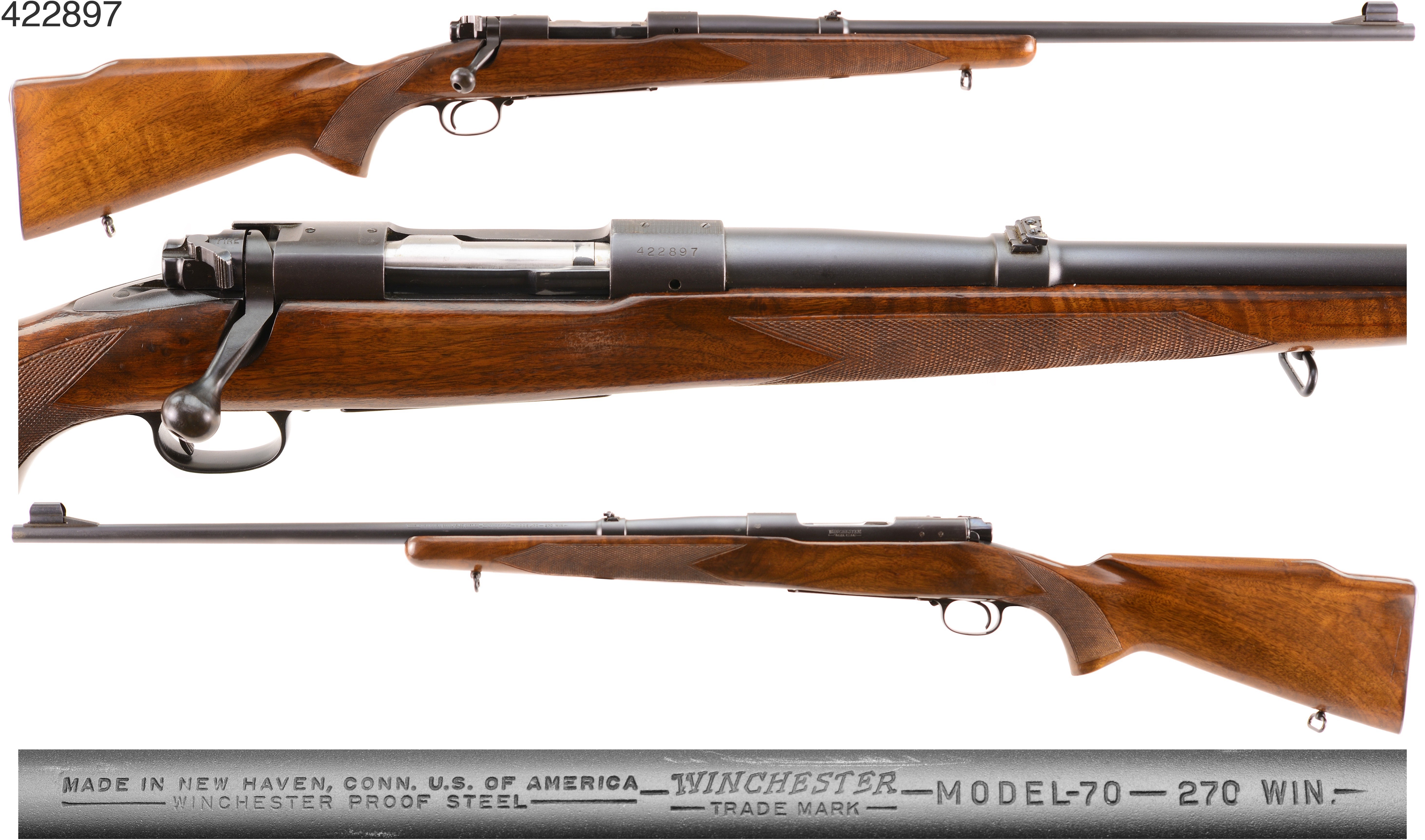

What Ted’s referring to is that during the 1950s, a fair number of Model 70s in 270 WIN were made with special order stainless barrels.  The only special order stainless barrels that show up in the survey in any kind of numbers are in 270 WIN, 300 (H&H) Magnum, and 30-05 Target Rifles…  Others were undoubtedly made but I suspect they would have been one-offs…
As for the stainless barrel 270 WIN rifles, they tend to fall into serial number “clusters” that suggest they were made in batches.  Possibly the result of orders placed for a group of similar rifles (or a factory whim???).  The first batch is between S/Ns 240xxx and 245XXX (4 examples so far).  The next batch is in the 328xxx to 366xxx range (11 examples so far).  There are also a couple in the 421xxx to 422xxx range.  Pretty much nothing else in the intervening gaps…
Anyway… There’s a “story” that at one point an oil exploration company working in South America ordered stainless barrel 270 WIN Model 70s from the factory.  Maybe they were afraid of Jaguars???  I am not aware that there is any truth to this story, any more than I am aware there’s any truth to the notion that batches of Model 70s in 7.65 M/M Argentine Mauser were manufactured and exported to South America in the 1930s.  If ANYONE has any documentation related to either of these (or other) Model 70 “Urban Legends”, PLEASE get in touch.
In any event, Ted, I doubt that the stainless 270 WIN Model 70s had anything to do with the “Rubber Development Company” of the 1940s.  As far as I know South America was not a big producer of natural rubber, and synthetic rubber had been invented by the time the stainless 270s were made in the 1950s.  Oil exploration, OTOH, is at least plausible…  Think Venezuela… Wink
If anyone cares, here’s a Standard Grade Model 70 with factory stainless barrel…

Why are the Model 70 Stainless Steel barrels marked “Proof Steel”… they most certainly are not the same thing!
