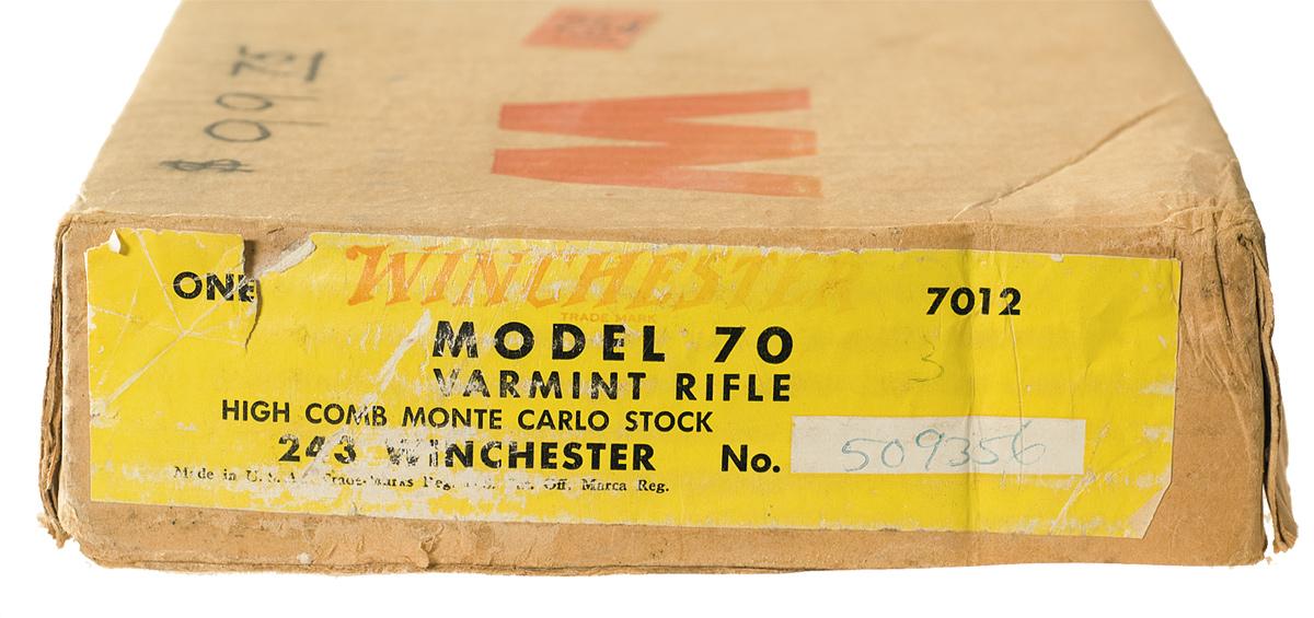

You are simply too skeptical.  There certainly ARE varmits all over the American Southwest.

Very funny!!!  At least somebody at Winchester (probably an Easterner) knew how to spell “VARMINT”:
On the other hand, each batch of labels is specific to the catalog symbol number, so I suppose “VARMIT” is possible.  Thank goodness nobody has to spell “wascally wabbit”!!!  Laugh

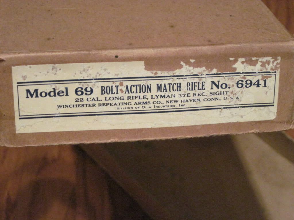

I have been watching this thread with interest hoping to learn something.  Unfortunately I have little to add on this topic other than I have seen errors on other Winchester box labels.  I have one on a 69 Match rifle that lists the receiver sight as a Lyman 37E instead of 57E so I know there is precedence for label errors.  Thanks for the interesting topic.

I am going to firmly claim that your label #2 is fake.  I first saw these labels emerge in the 1980s after M70 collecting took off and prices rose.  I’m pretty sure I know who produced and used these labels.  I’ve seen a lot of them over the years.  I absolutely would not buy a boxed M70 with this label.
I am also going to claim the “Varmit” rifle label also is a fake.  One of the other posters had a long list of “maybes” that might explain how it could be real.  I’m not convinced.

Regarding Box #2, I’ve seen that label format pop up at least one other time and have always had issues with it.  The ‘Varmit’ thing is just funny… A label ‘faker’ having a joke or a factory ‘typo’… Strange either way…
