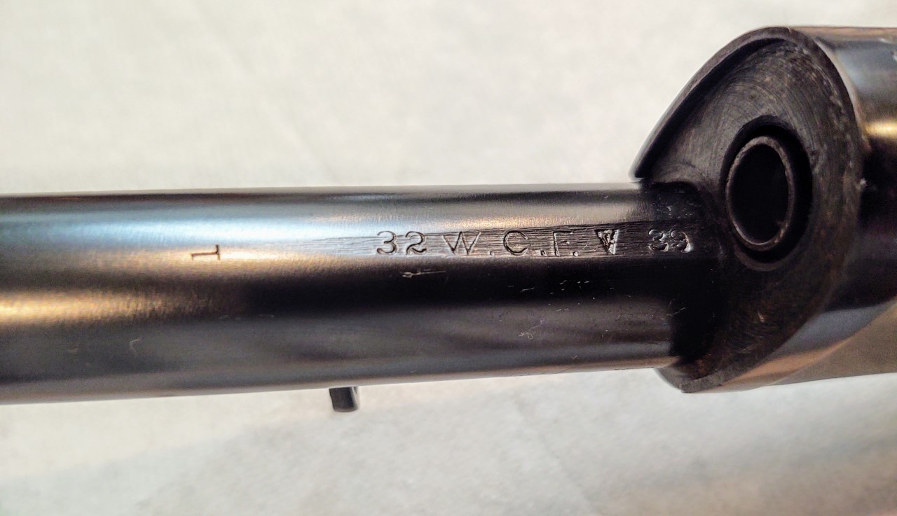

Curiously I removed the fore end to see the barrel date and found “39” on it.  I sent you picture since I’m still unable to post pics successfully.

Production of the 25-20 WCF and 32 WCF was much slower than the 218 Bee, and Winchester manufactured their barrels in batches in advance of when they were needed to assemble the rifles.  It is not unusual to find barrel dates 1-2 years older than the receiver, especially on the lower production models and calibers.
For those who may not have seen a Model 65 barrel date, the picture below is Scott’s rifle.
