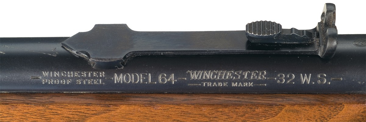

I just learned about the *64 Carbine rear dovetail & sight location* versus Rifle location
I could not view the article on particular elevators used for each model.
When I look at Carbines via online auctions, it appears the sight elevator will crash into receiver face at the higher settings???
What’s the deal
February 14, 2025 - 12:03 am
What’s the deal
The 20-inch Model 64 Rifles (carbines) use a 3C elevator versus the 1C elevator used on the 24-inch rifles.  The 3C is much shorter, and it sits in a reversed direction.  The sight and elevator are adjusted for maximum height, the tip of the elevator is slightly forward of the receiver frame ring.
Model-64-30-W.C.F.-1124835-Deluxe-Carbine.jpg Model-64-32-W.S.-1091897-Deluxe-Carbine.jpg
