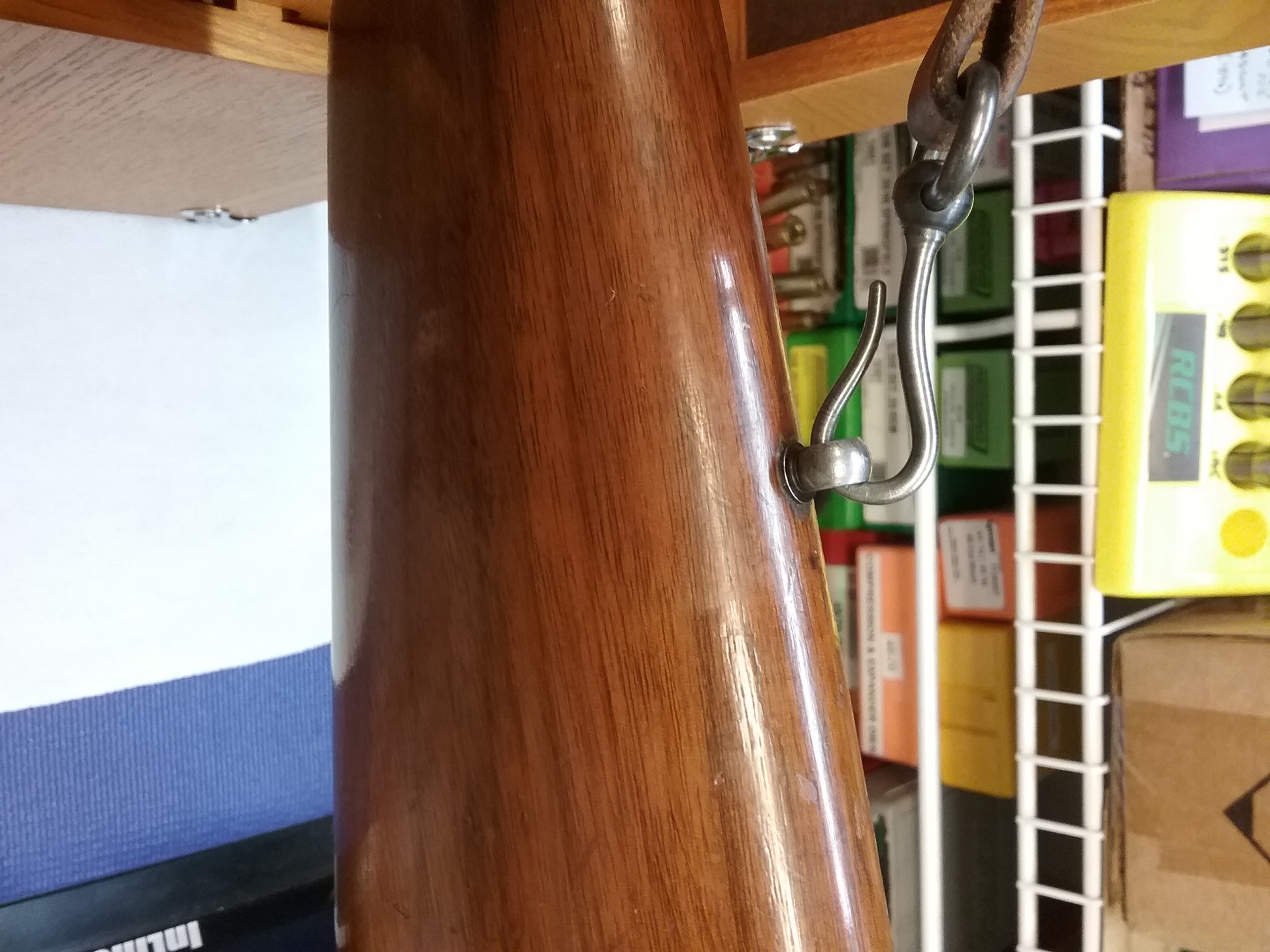

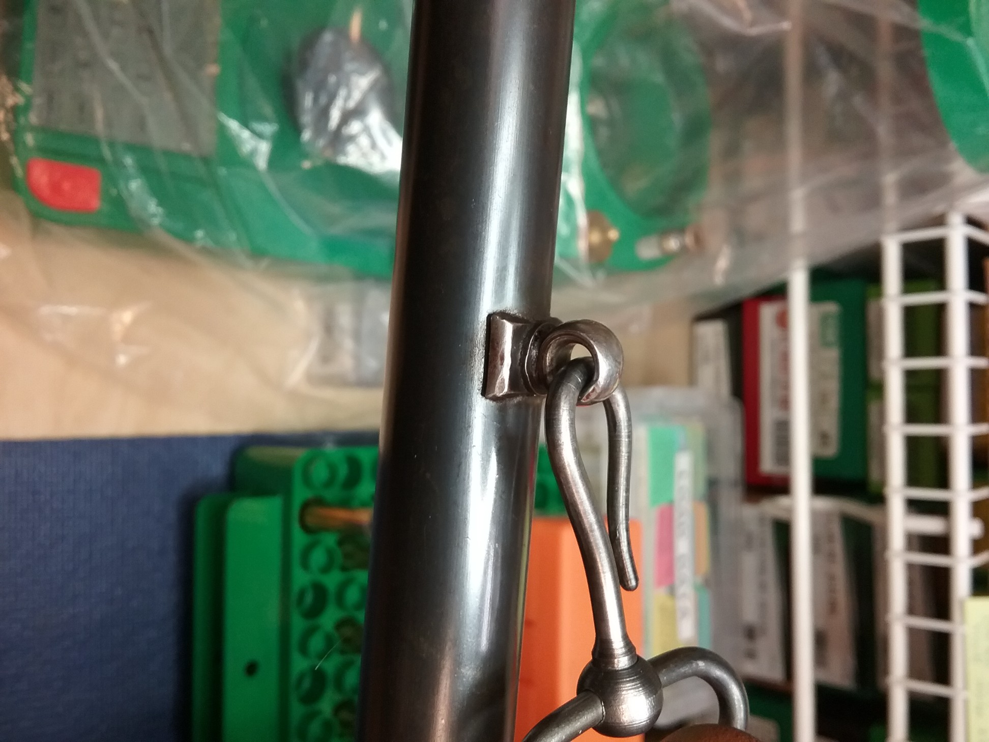

I have a1903 vintage Model 1895, .30 US, that has fish hook style sling swivels. The front swivel mount is dovetailed into the bottom of the rifle’s barrel. The rear swivel mount is threaded into a threaded metal grommet inletted into the stock. I have a factory letter for the rifle, but it doesn’t mention the swivels. Any opinions on whether these are factory? Also, the factory letter states that the rifle returned to the factory in 1904 to have a shotgun butt replaced with a crescent butt plate.
October 4, 2026 - 6:17 pm
Gus,
Does it have a crescent butt?  What is the exact distance from the butt to the center of the rear sling eye?  Have you pulled the fore end stock off and checked the bottom of the barrel for a work order number?

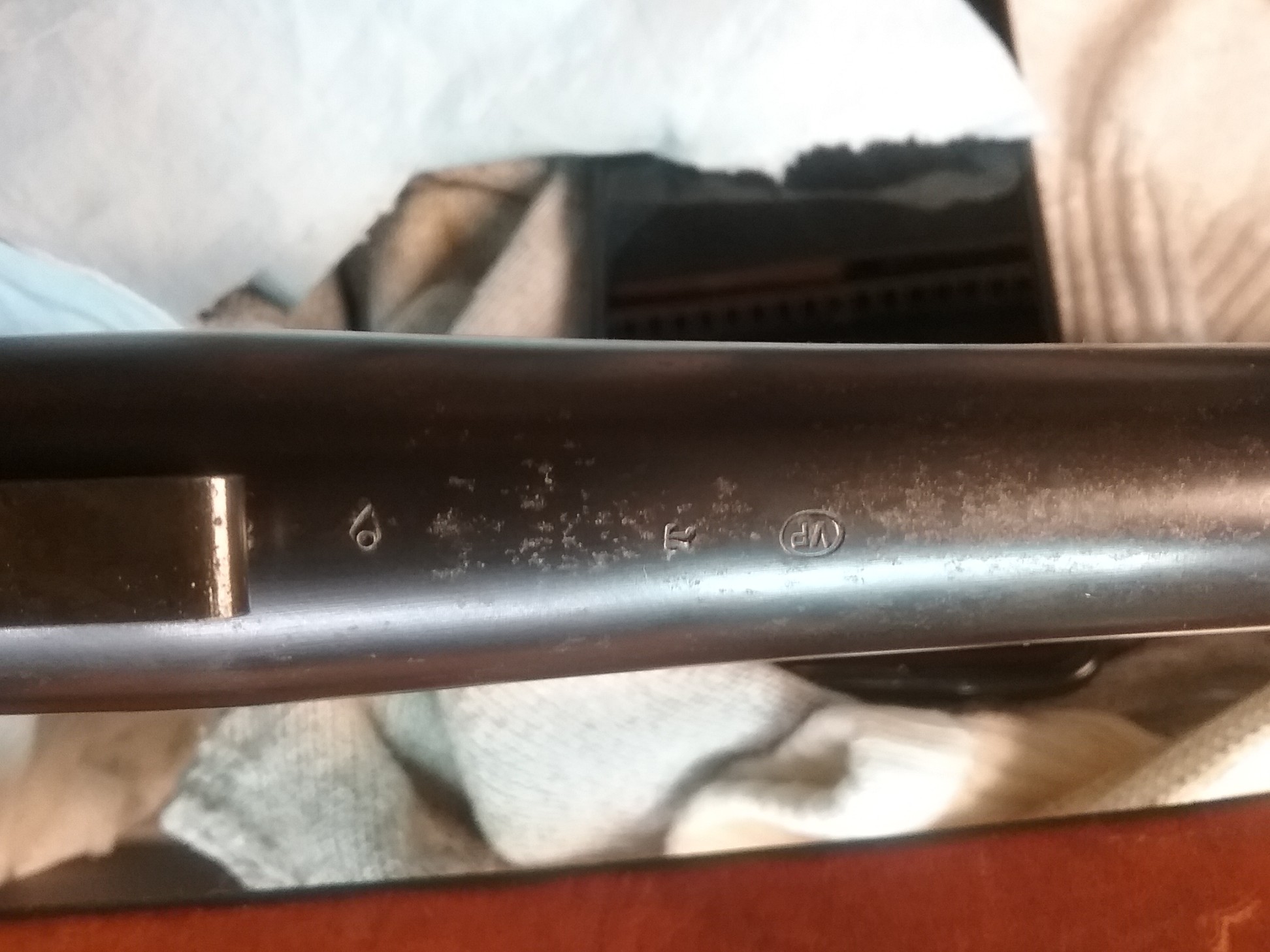

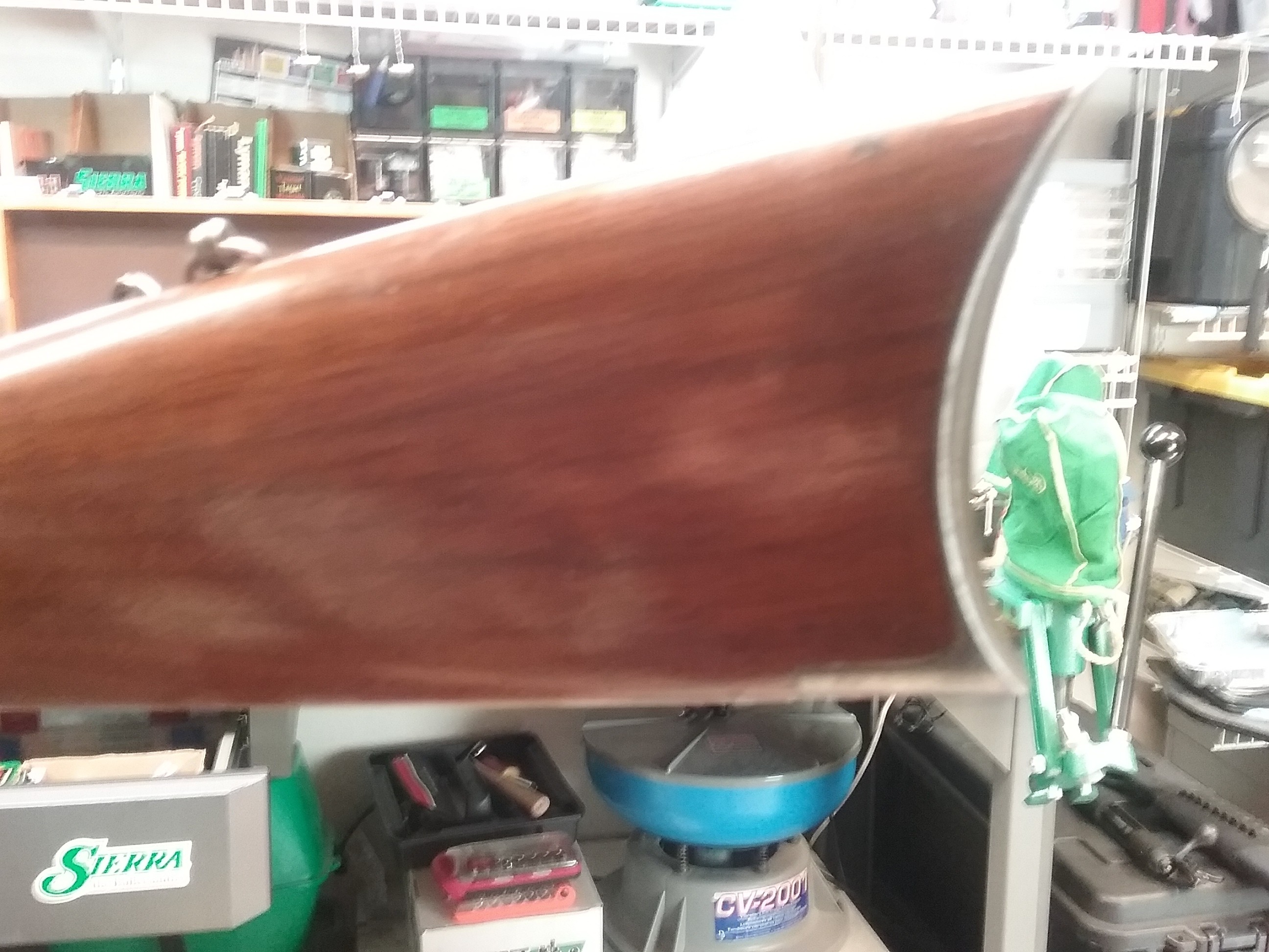

The measurement from the crescent butt plate to the center of the sling eye is 6-3/8″. There are marks stamped into the underside of the barrel (see photos). Underneath the flat v-type carrier spring is stamped a small heart, a small triangle, the letters NS (nickel steel?), the number “3”, and a capital letter “H”.

October 4, 2026 - 9:28 pm
Gus,
The sling eyes are definitely aftermarket additions.

Gus,
Just curious what indicates that to you? I’m not disagreeing I’m just trying to learn.
October 5, 2026 - 5:36 pm
helidriver72 said
Gus,
Two things;
(1) the physical position of the rear sling eye is not correct.  Fortunately, very few people were/are aware that Winchester positioned the rear sling eye very precisely
(2) the fact that there is no mention of the sling eyes in the factory letter.
