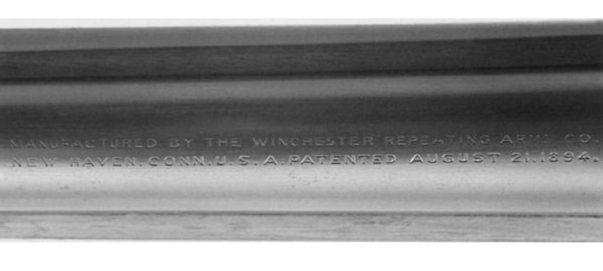

It has most certainly had a new barrel installed at a minimum. The s/n dates to 1909 as you know. The barrel should be marked like this for that era:
Unfortunately, you’re out of factory letter range so you won’t be able to tell what it was when it left the warehouse.

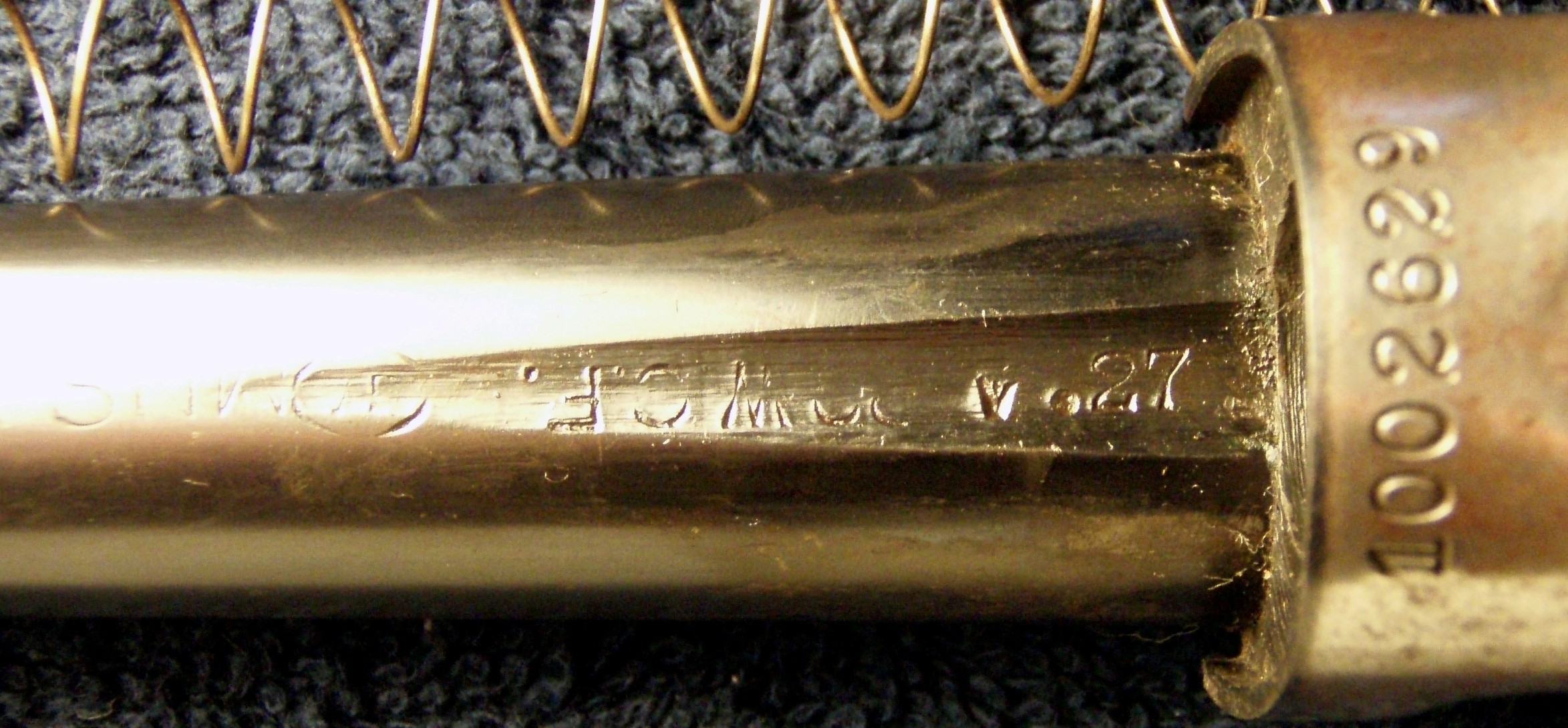

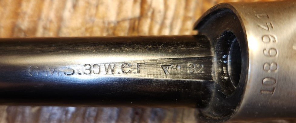

If you are curious, the barrel currently on your Model 1894 should have a 2-digit date stamped in the concave area on the bottom of the barrel that will tell you what specific year it was manufactured. The pictures below are examples.
27-marked-barrel-1002629.jpg31-marked-barrel-1083442.jpg32-marked-barrel-1086941-2.jpg
