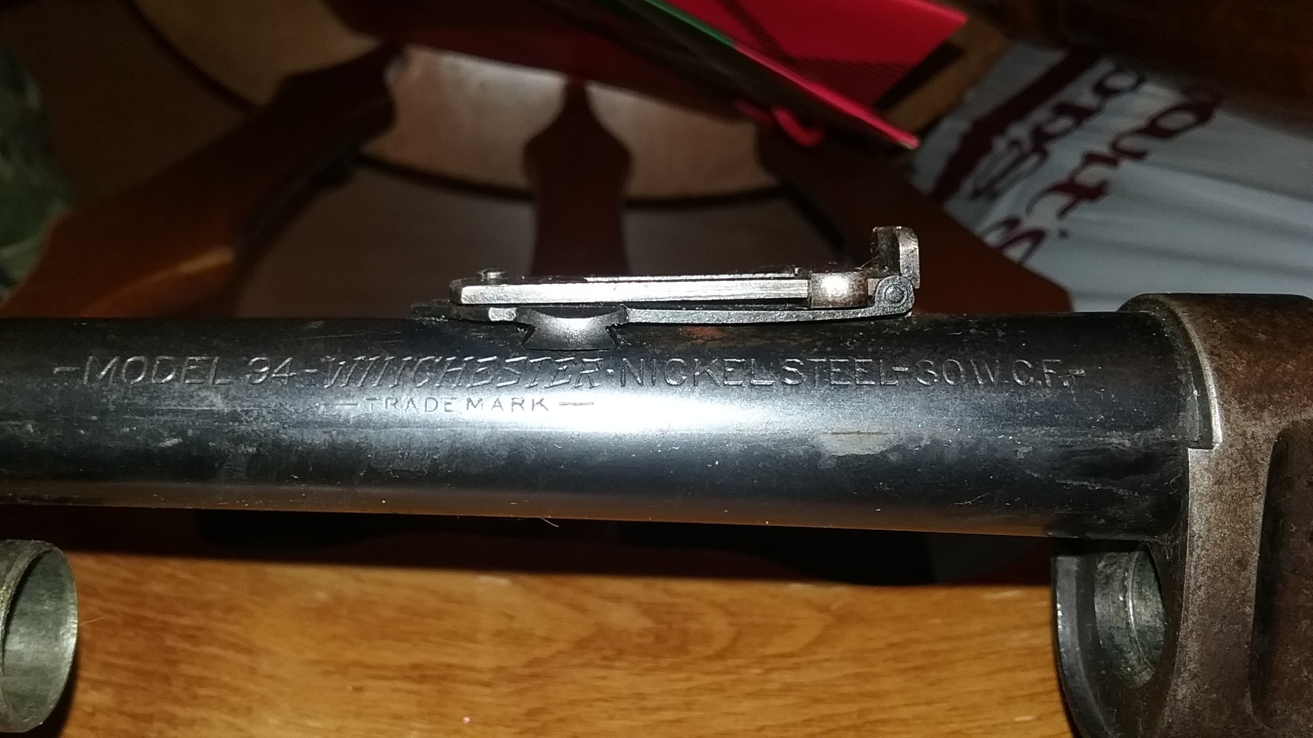

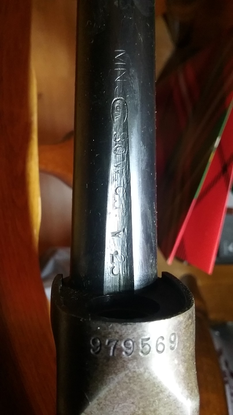

Hello, Bert,
I’ve been perusing threads and came across this one. I  may have something of an oddity as my 1925 mfr SRC has the Type 5 tang marking and is also marked Model 94 on the barrel. I pulled the forearm and mag tube, the barrel appears to be 1925 production as well, which doesn’t quite fit with what you described.
Thoughts?

Forum Posts: 14826
February 14, 2020 - 2:52 am
Interesting… I suspect that the transition of the barrel marking change took place over a slightly longer time period than I previously observed.
