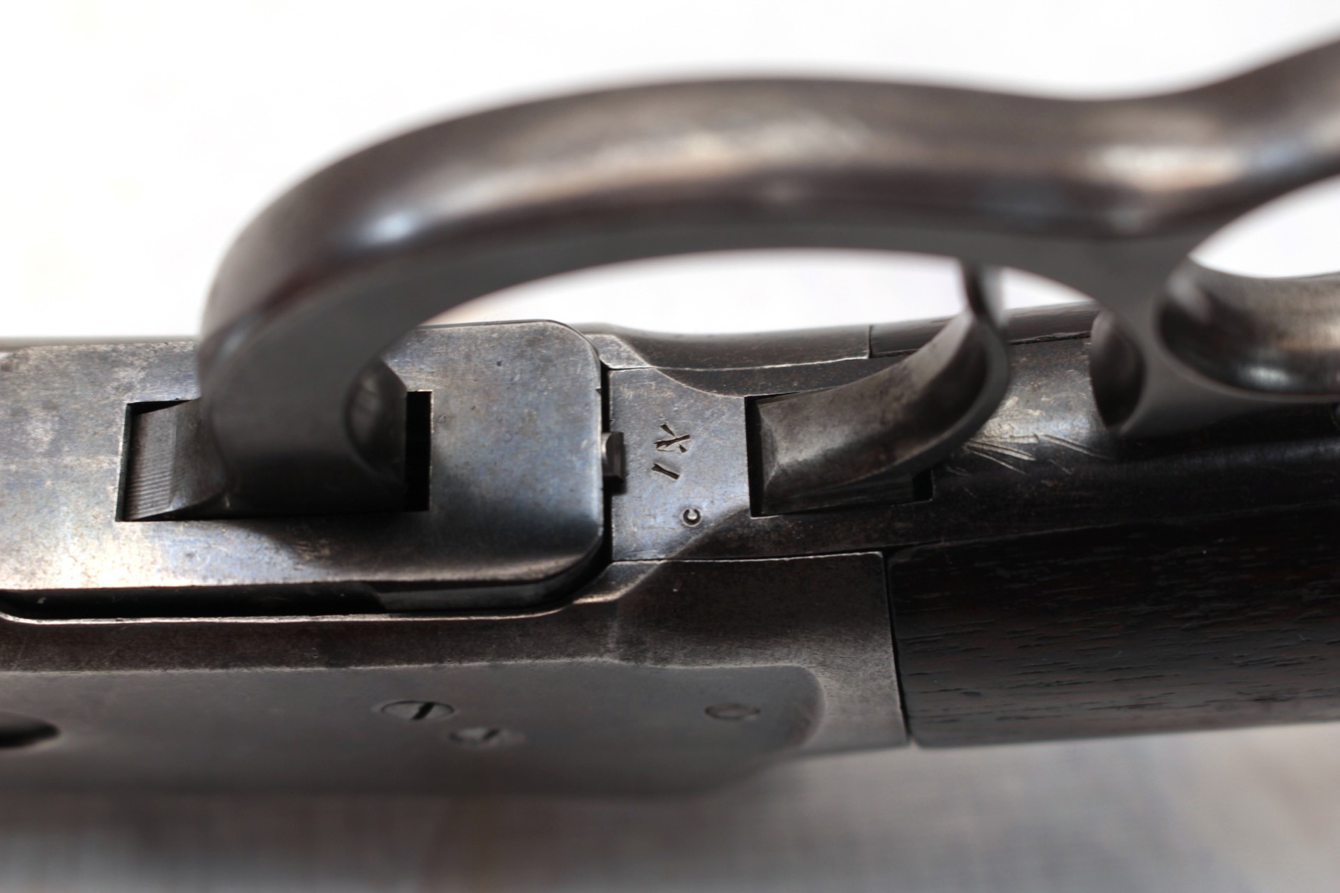

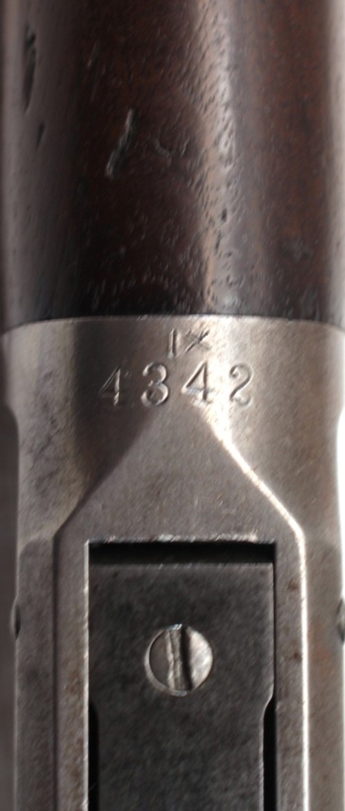

We have a Model 1894 rifle with 1X markings above the serial number 4342 and on the lower frame in front of the trigger. What is the meaning of these markings? Duplicate serial number??

Here are the pictures.
As I suspected, neither marking is indicative of a duplicate serial number.  I do not believe that the “1X” marking is factory original. Why or who applied it is a mystery.
The marking in front of the trigger also does not appear to be factory applied, though it is in the same location that Winchester inspectors did (on later production guns) stamp their marks.
Based on what I can see, both markings are extraneous to the rifle.  Which caliber is it?  Is it a First or a Second Model?

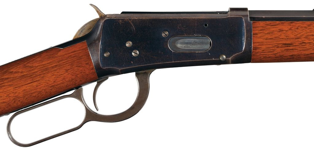

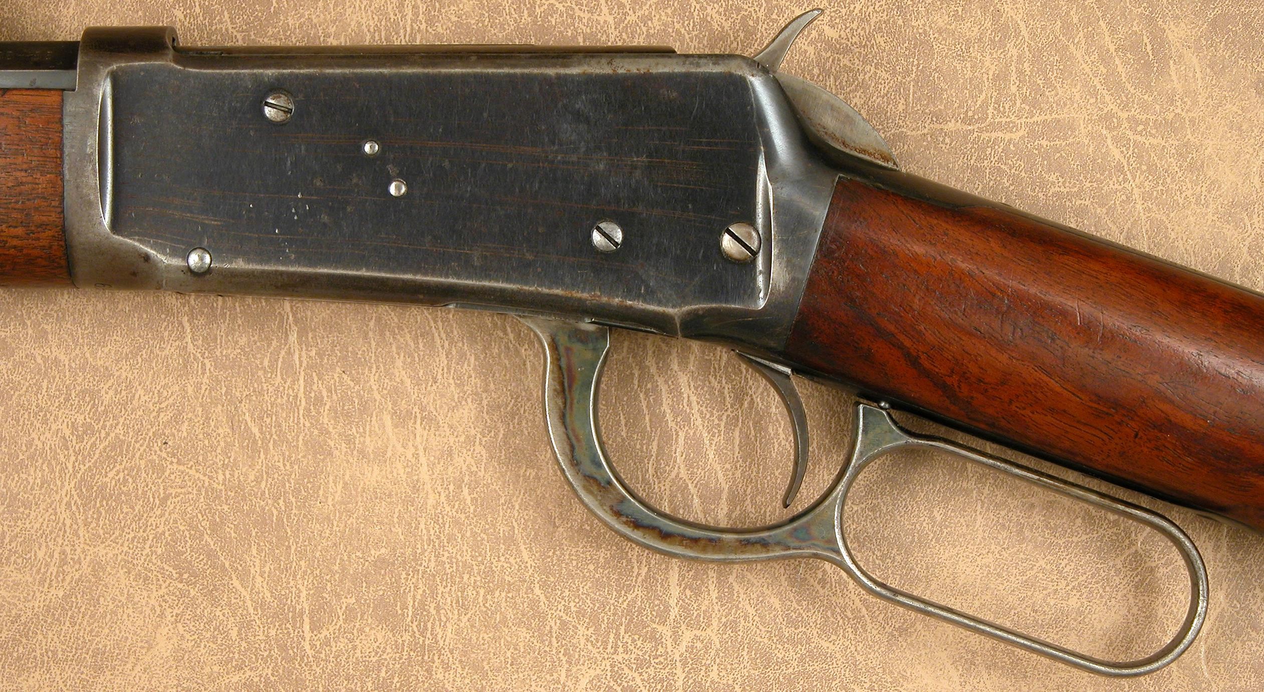

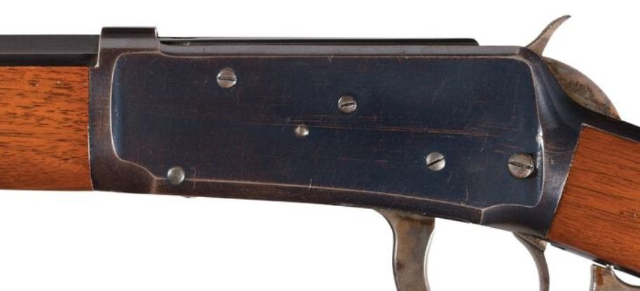

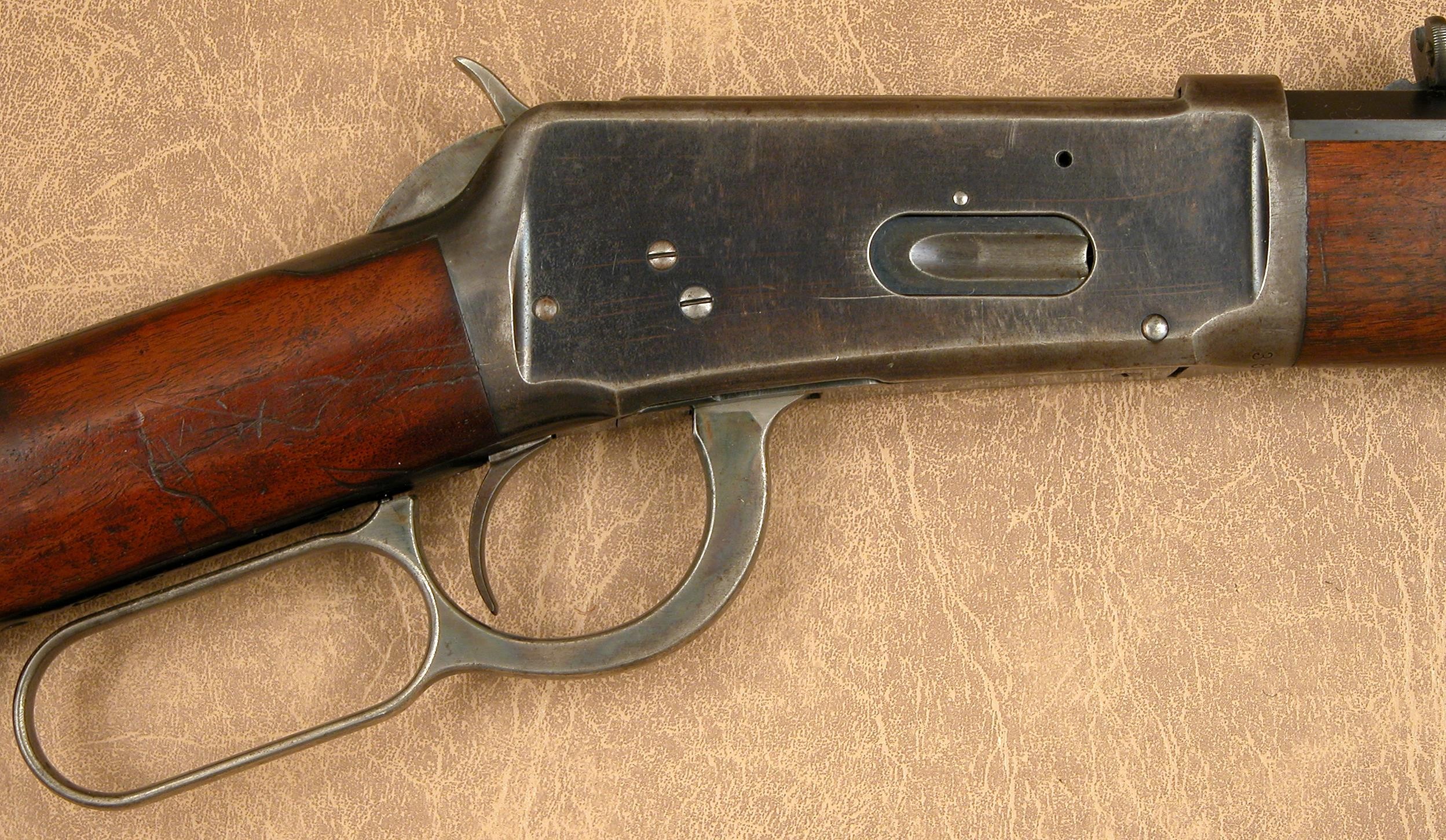

This is what a First Model looks like…
And this is what a Second Model looks like…
Note that the screw locations are different.

Bert’s pictures of the left side of both the First and Second Models are perfect examples of the forging marks found on those guns.
A little more subtle on the right side.
Very nice Bert.
