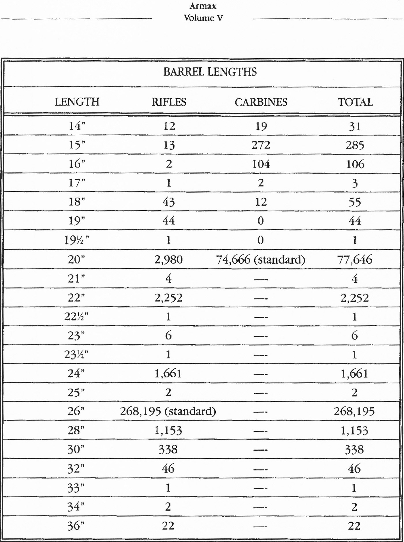

What is the serial number on your Model 1894?  In answer to your question, Yes I have seen several Model 1894 Rifles with 30-inch barrels, and even a few with 32-inch and 36-inch barrels.  Winchester manufactured the Model 1894 Sporting Rifle with a 26-inch barrel as standard, but offered extra long barrel lengths as a special order option (cost was an extra $2 for each additional 2″ in length).  The Model 1894 Rifles with factory original extra long barrels are high on most collectors list, and if the rifle is in decent condition, can bring substantially higher sales prices.
The attached photo is a scanned copy of the survey conducted by the Cody Firearms Museum research office showing how many of each barrel length were recorded in the factory warehouse ledger records for the first 353,999 Model 1894 serial numbers (covering September 1894 to May 1907). Click on the picture to enlarge it.

As far as why the longer barrel, it’s because someone wanted one and ordered it that way.  We can only speculate (wildly) on what their reason might have been.  If your rifle was manufactured in 1895, we are coming off a period of time where rifles tended to be longer rather than shorter.  Many shooters were in the camp where greater accuracy was associated with longer barrels. The longer barrel also provided a longer sighting distance. If the rifle has a full magazine tube, the explanation could be as different as a rifle that held a greater number of cartridges was the main appeal.  It would be extremely interesting to know just what the original purchaser had in mind.

Model 1894 serial number 40681 was actually manufactured in April, 1898. If you are interested in the exact date, the Cody Firearms Museum (CFM) records office can provide you with a Factory letter (for a modest fee).

The April 1900 catalog (No. 65) listed a standard Model 1894 Sporting Rifle w/26-inch octagon barrel as $19.50 for the 32-40 and 38-55 calibers.  The 30-inch barrel cost an extra $4.
