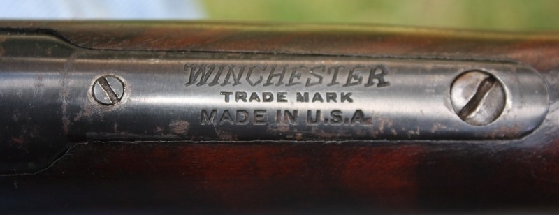

Good morning and thanks for the additional images.  I am not certain but would guess that HOUGH is the name of an importer who was used to bring the rifle back to the US.  And I am assuming that is where it is now?  During this serial number range Winchester manufactured a very large batch of (+5000) saddle ring carbines.  Yours should have an upper tang stamp that looks like the attached image.
