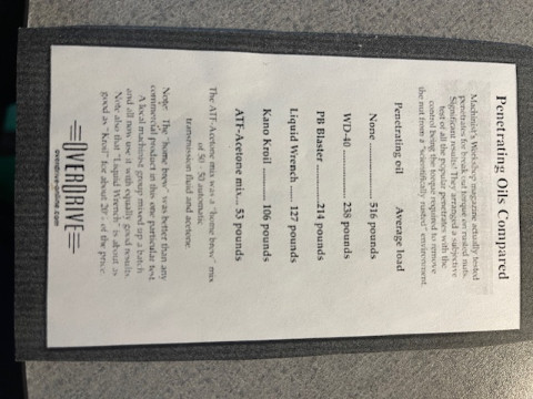

That “home brew” reminds me of the concoction some BE shooters used to use to keep their tight-tolorance 1911’s and .22’s running. Maybe they still use it. Most wouldn’t say what they mixed with the ATF. Some were machinists so I am thinking it may have been some kind of light cutting oil.

I’ve always used Kroil, although their aerosol cans always seem to lose pressure after a few years…only ones to do that and they won’t fix it. In my DIY auto repair stuff, I’ve always soaked the bolts/screws/etc. a little daily over the course of a week and took my time. There are those who say it does nothing. Here’s an interesting look at it from Project Farm’s YT channel…

Very interesting… I do not use the aerosal can, preferring the cans with the dropper tube (a lot less messy and it allows for a much more conservative application).  Based on the video, I will buy a can of Liquid Wrench and give it a try when my Kroil supply runs out.

Here’s a link to a full playlist of his…he made quite a bit more videos based on viewer suggestions and I had forgotten about them…more research Bert!
https://www.youtube.com/@ProjectFarm/playlists
Go to the penetrating oils playlist about 2/3 the way down…episode two has an interesting testing method using bolts in acrylic and measuring the penetration.

I have Kroil, WD 40 and PB Blaster on my bench and use all 3.  But, I never saw a real difference.  I guess I need to add a 4th can.

I have both Kroil and WD 40… but I will add a can of Liquid Wrench.  No such thing as too much “stuff” (according to George Carlin).
