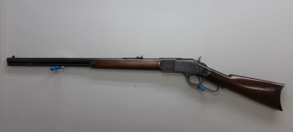

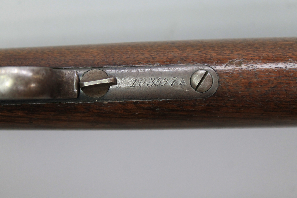

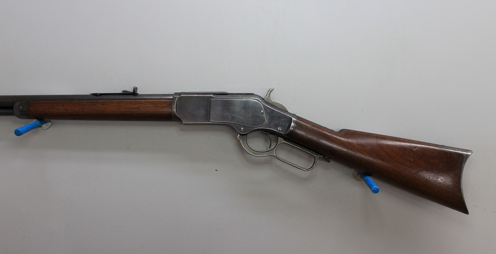

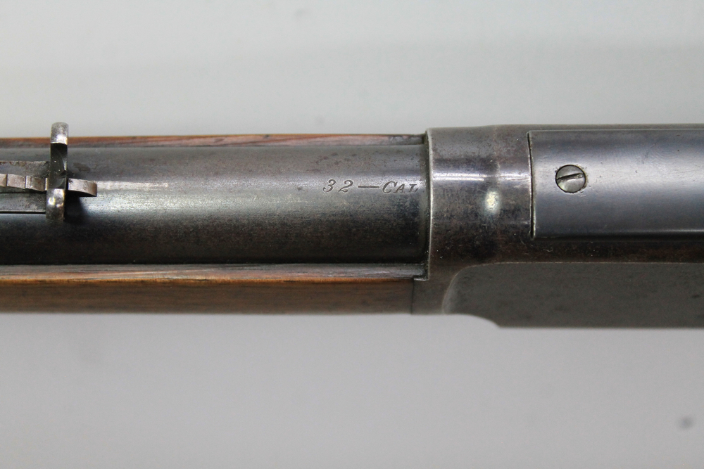

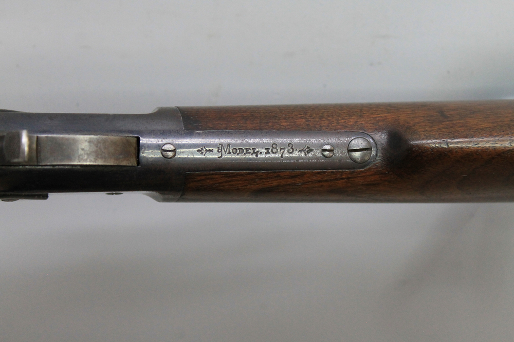

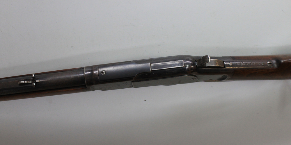

I was looking  at a gun the other day serial #103597A standard 1873 RB,FM, Straight grip ,crescent butt plate , no trap door, Standard sights. I would love to post pics for you guys to enjoy , but having trouble. Send your email and all send some.

Thanks for info Bob and pictures, Neat to see a first year of production of the 32-20.

Bruce, I just handled that rifle and looked in both ends of the bore a few weeks ago on a trip up to North Bay. Everything looked honest to me and the bore was pretty decent. I just thought the price was a little high for the caliber and the condition. That being said, if I had the money and he would lower the price, I would seriously consider purchasing that rifle. Unfortunately, I don’t have the money so I haven’t bothered to see if he has any room to move on the price. Let’s see what the other fellows say re. price. I would think that $3,500 – $3,800 would be more like it, but I’m a bit rusty on ’73 prices.

My thoughts exactly. I had a good look at this rifle as well and thought it was a good decent rifle. With  honest wear  and quite a bit of blueing left.  Problem being the caliber and being a round barrel not as sought after from the collectors , is why it is still there. I was thinking more around the $3000 mark . I am in the same boat as you saving up and don’t have the funds right now.
