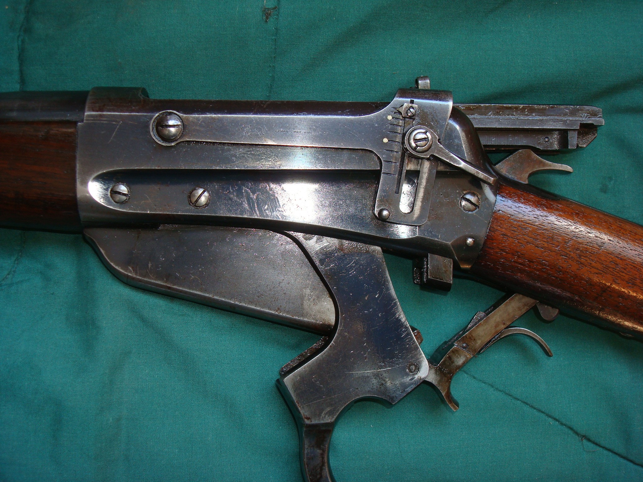

I know it is not the kind of lever that everyone gets excited about but I have been tracking it for years and finally was able to purchase it. I’m not sure if the sight is original to the rifle.  It appears to be, but the barrel does not have a dovetail sight blank which I would think it would have if it left the factory that way.  However, it does not look like a rear sight was ever on the rifle.  The rifle is in the early 28K range  which this site indicates to be a 1900 manufacturing date. Lots of good finish on the rifle.  Believe it or not the owner used to store it in an old WWII BAR leather case.

The slot-blank could have been lost, so if there’s no “ghost” mark on the barrel where the rear sight elevator would have rested, I’d bet it never had one.  That BAR case did its work well!

That IS the kind of lever that some of us get excited about.  That is an excellent find of a very nice, original Winchester in a scarce configuration.
Fortunately, the gun is in the letterable range for 1895’s, so Cody would have the records available that should tell you whether the Lyman receiver sight was original.  As long as it still has its original barrel, the lack of a rear sight dovetail is a strong indicator that the receiver sight is original.  By the finish, I’d bet it is the original barrel (proof marks on the barrel of a 1900 manufactured barrel would indicate it’s a replacement).

If it had no slot, it would have to mean than that, but I believe he said no slot blank or filler.  Would seem logical for the barrel to be left un-slotted if a tang or rcvr. sight was ordered, except that, ordinarily, omitting the slot was an extra cost option.

It looks pretty clear to me in the pictures that there is no rear sight dovetail.

Believe you’ll see it if you enlarge the photo.

I see the rear sight dovetail as well.  I used to own an 1895 exactly like this one with a blank in the rear sight dovetail along with the Lyman 21 receiver sight. It lettered with that sight configuration.

My eyes aren’t what they used to be.  I enlarged it the first time and didn’t see it, but when I enlarged it AND put on my glasses – there it is.  Factory records should clear up the mystery.

Hey that’s a pretty nice rifle!  It looks like it could have a lot of case color on the hammer and link yet too.  I thought for a second it didn’t have a rear barrel dovetail also until I looked really close.  Really straining, but it looks like it has a bead front sight also.  If you want, email me some info about it and the full s/n and I’ll have it searched for you if you aren’t a CFM member.  95 collectors have to stick together….

Thank you all for the generous comments.  I am very sorry about the confusion regarding the dove tail for the sight, it has one.  There is no proof mark on the barrel.  I’ve posted a few more pictures that will hopefully answer any more questions that you have. Thank you Brad for the offer, email to follow.
