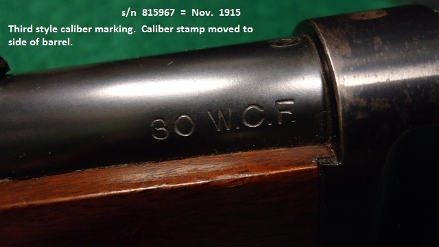

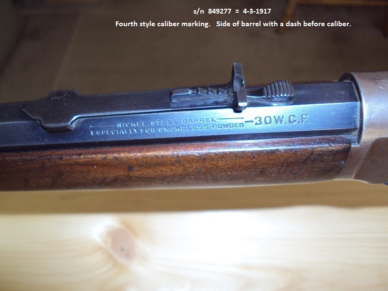

OfflineThe serial number puts this carbine from early 1895. The barrel is from approximately 1917 or later when this style caliber marking was being used. That puts it in the s/n range of 825,000 or higher just as bob’s book stated.
Paul
The second photo is the caliber marking from slightly earlier.
