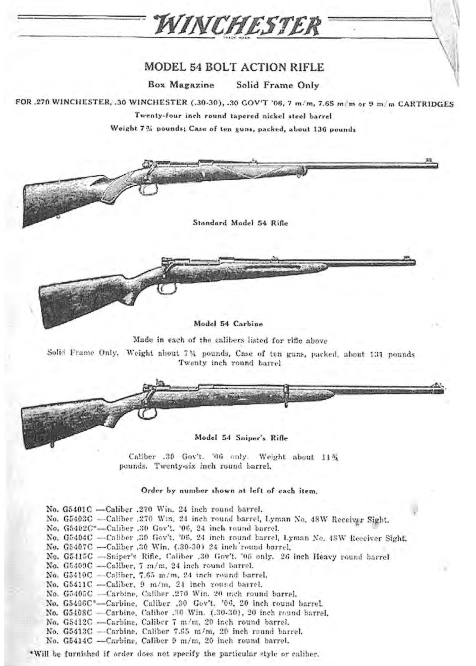

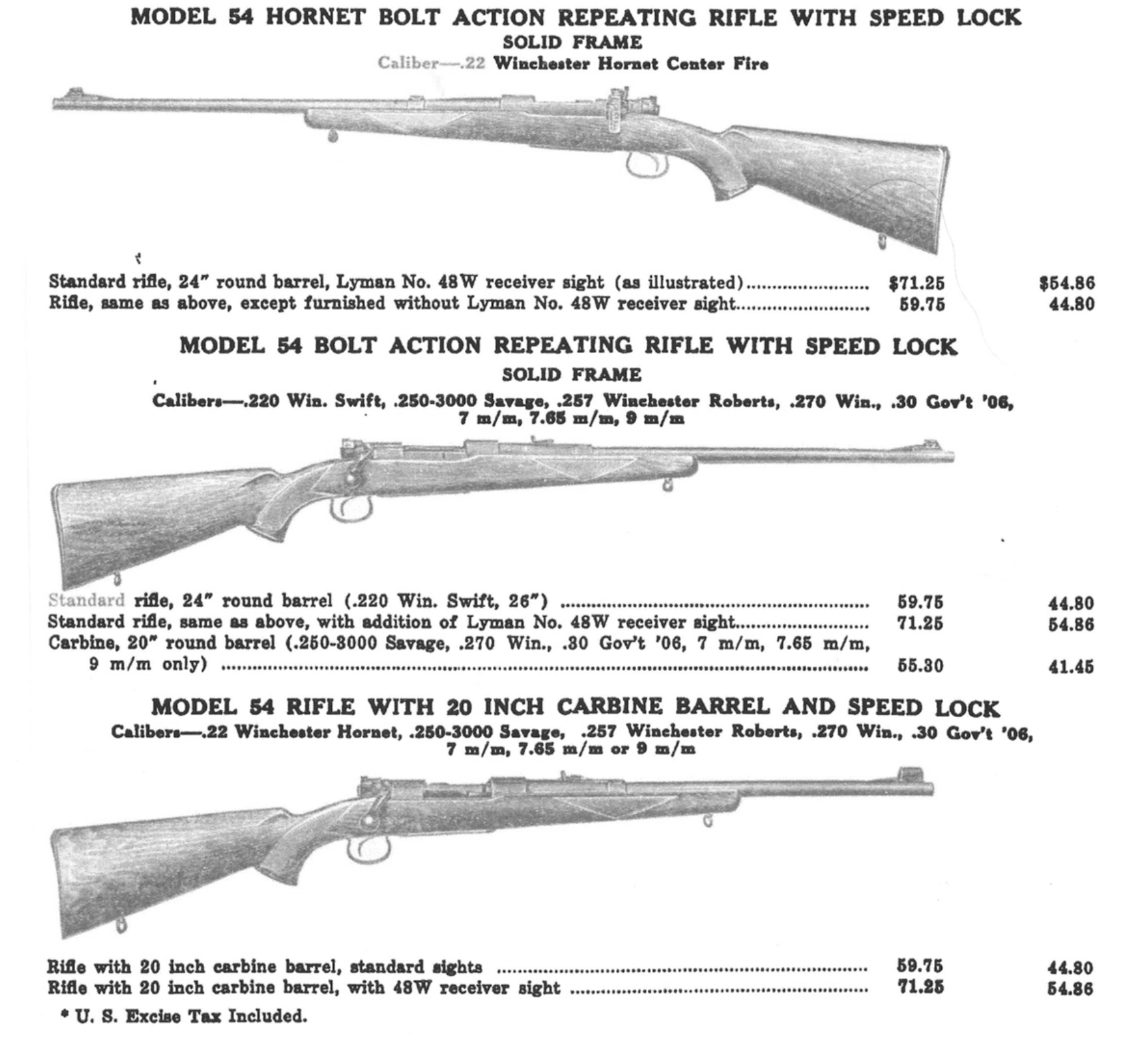

I’m not a M54 “expert” either…
The 1929 Winchester catalog does list the Carbine (uncheckered finger groove stock) in 30 WCF, 7.65 MM, and 9 MM.  The 1936 catalog lists the same (except 30 WCF) for the Carbine, as well as 7.65 MM and 9 MM for the “Short Rifle (20-inch barrel NRA Standard rifle with checkered stock).
Interestingly, the contemporary parts catalog included M54 barrels in 32 Special, even though they were never offered as cataloged rifles… Nowhere that I am aware did Winchester admit to making M54s in 300 SAVAGE.  If they exist, I suppose they’d be either special order rifles or a very limited run…

Thanks for the thoughts Lou.  And of course, Winchester wasn’t chambering anything in .300 Savage until they did so in the Model 70.  Accepting a special order for a M54 in .300 Savage might have been a larger expense to accommodate than a typical special order.  Maybe they had a chambering reamer available from cartridge testing?
