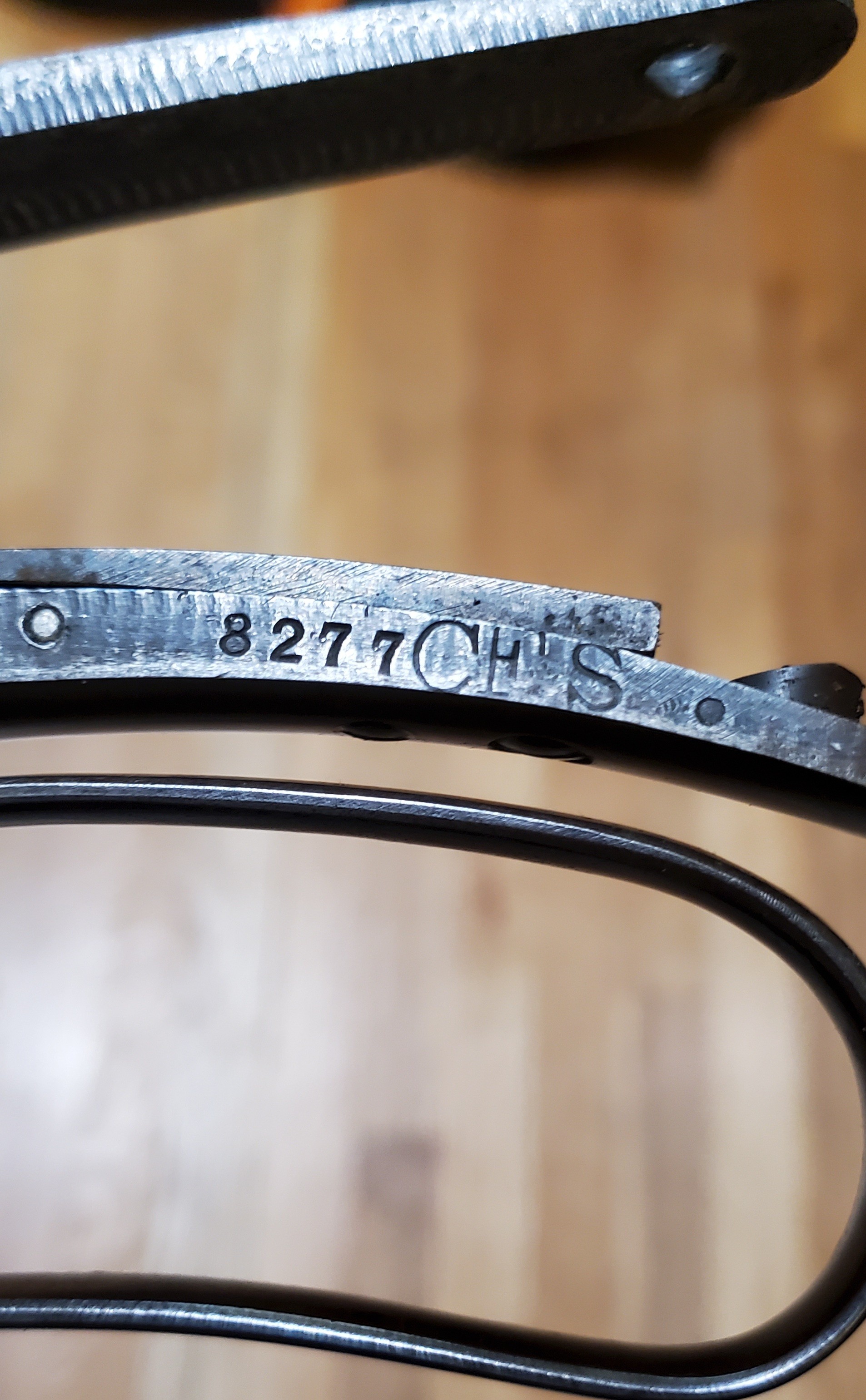

My question is, does anybody know what the lower tang stamps indicate?

What are the lower tang marks? I don’t see a picture.

Just edited the post to include the pics, sorry…reload the post.

Now the pictures are there, You have a 4 digit assembly number. The “CF” is “Custom Fit” and the “S” is for Shotgun butt. The assembly number should also be on the top of the stock under the upper tang and on the inside of the butt plate.

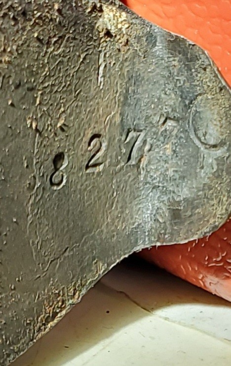

Most of the 1894 & 1892’s that Ive seen will have the assembly number from the lower tang stamped in the wood under the buttplate, and sometimes but not always (either not marked or buttplate has been changed out) included on the toe of the buttplate.   The wood will normally be stamped with a “94” for 1894 or “92” for 1892, below that is usually a stamp like a “T”, then the assembly number.

I managed to get enough time to pull the buttplate and sure enough…stamped exactly as you indicated.
Please see attached pics.
