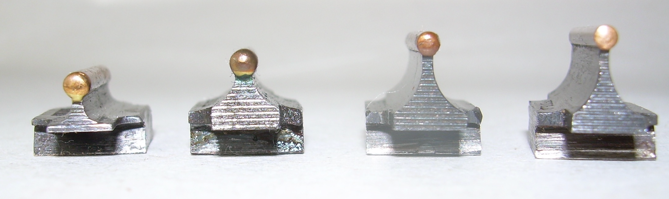

Wondering if someone can post a picture of this “original Redfield full gold front sight” – curious to what that looks like

February 14, 2026 - 2:35 am
Dan-
Second from left…  Prior to 1952, Model 70 Super Grades with standard contour barrels used the 0.310″ tall Redfield 254 full gold bead, just as Standard Grade rifles used a 0.310″ tall silver (tinned) bead Winchester 103C… After 1952-53 this changed to a 0.360″ tall Redfield 255 (third from left) or Winchester 103E…
The Redfield sights are stamped “Redfield” on top where you can see it and usually have the numerical “254” or “255” code stamped under the dovetail…
Hope this helps,

Louis Luttrell said
Dan-
Hope this helps,
that is great! Thanks Lou!!

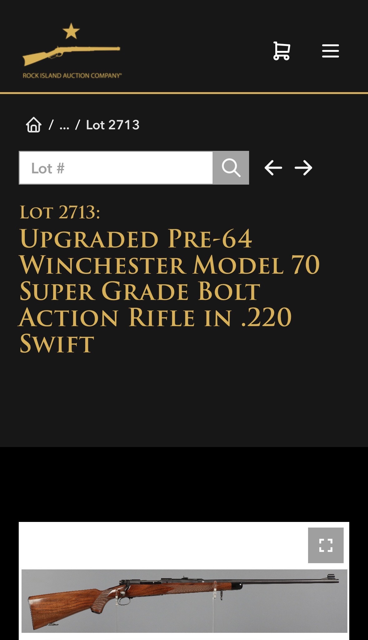

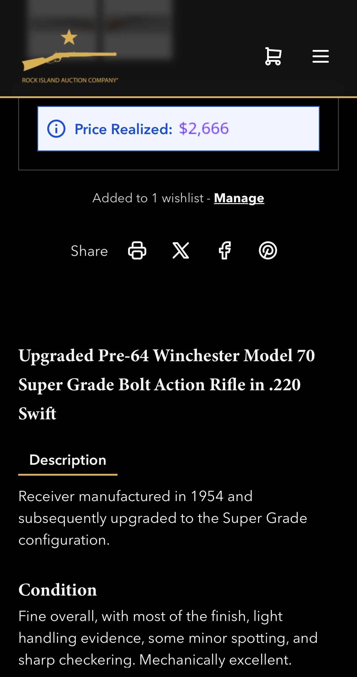

So I watched this one shortly after reading this thread and I guess it wasn’t a surprise what it brought, but it was a lot more than I would pay now that this thread exists. I mean the title says UPGRADED.  I understand 220 is a collectible, and still relevant caliber.  The rest of the description leans to a 90% gun.  However, if it was upgraded, it’s not original.  Am I missing something?  Ria price was 2666 so over 3k after taxes and shipping.

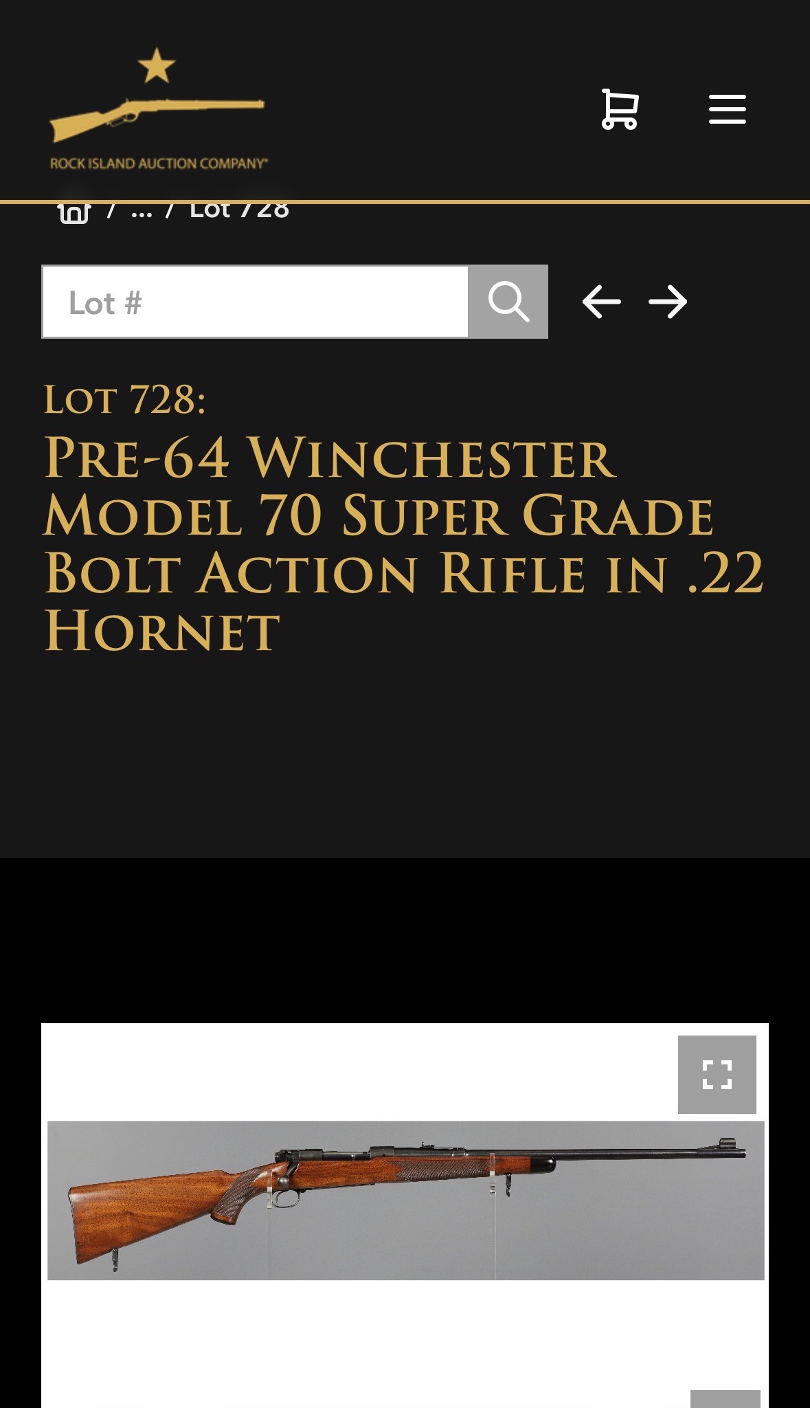

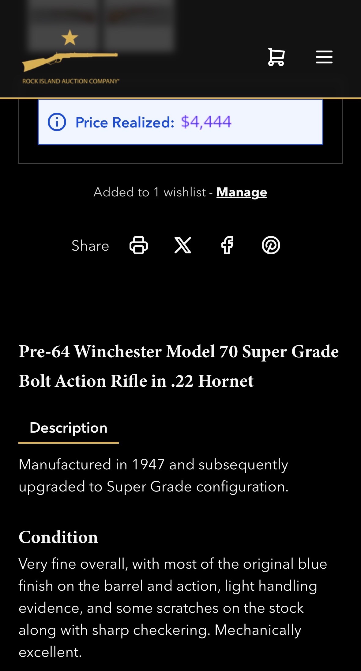

There was also this one in 22 hornet. So I would assume they were “upgraded “ because they’re in collectible calibers.
-Adam

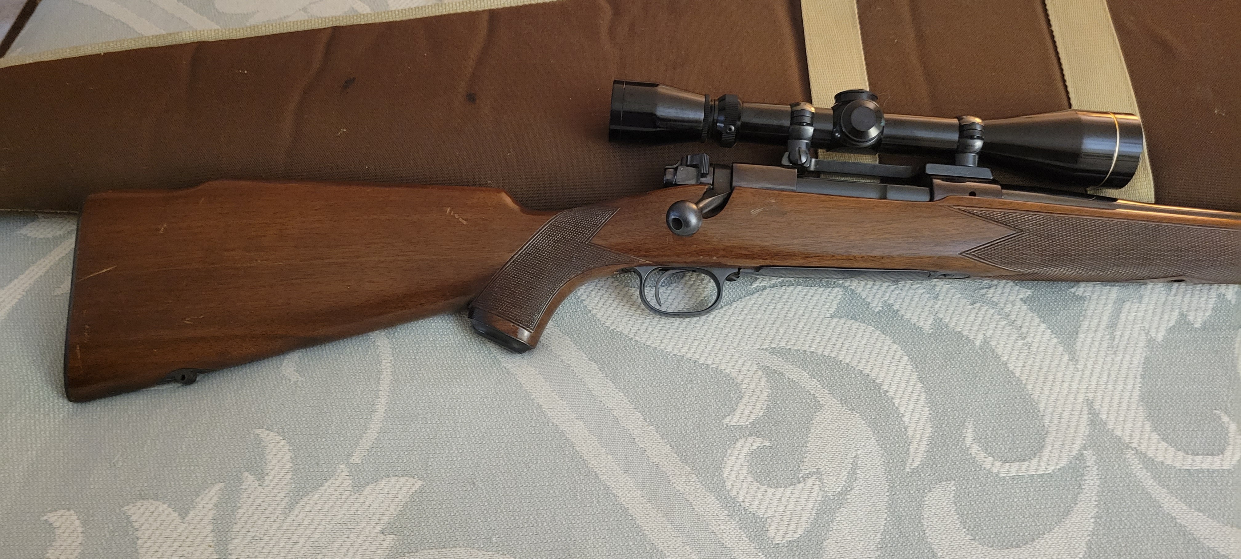

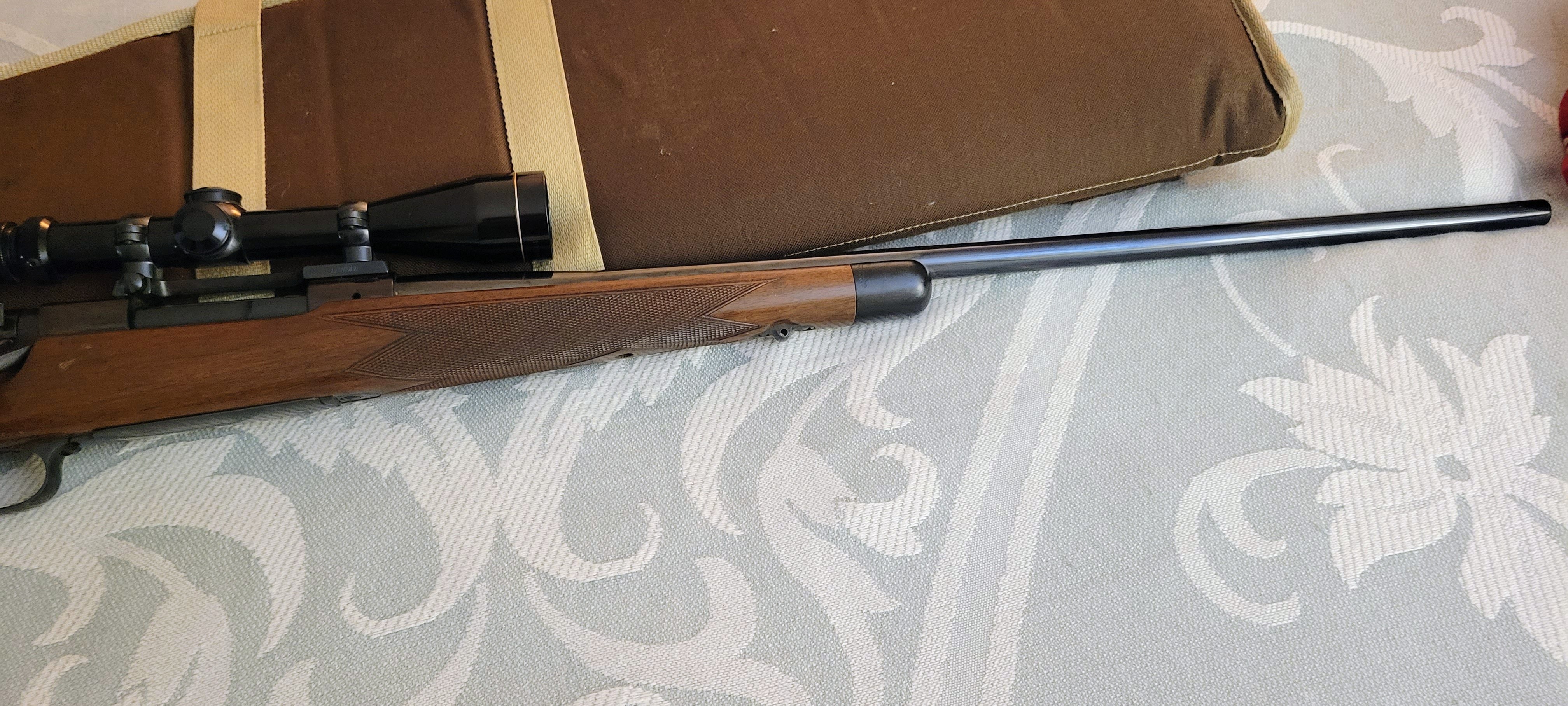

20230913_180611.jpg20230913_1806182.jpgI have a 1948 Winchester Model 70, original caliber unknown, that was “upgraded to Super Grade configuration” by replacing its original stock with a post-1953 Super Grade stock, disposing of its original barrel and installing a new 26′ sightless, varmint weight, SAKO barrel chambered for the (then wildcat) 22-250 cartridge. (In the Fifties, SAKO barrels were prized for their accuracy and the company offered a line of unchambered barrels in various profiles and calibers to custom gunmakers.)
In excellent condition, including a fine Leupold VariX II 3-9 Scope in Leupold rings and one piece base, I bought it off a consignment rack for $700 a couple of years ago.
That’s a lot closer to reality than what those two sold for, I think, but its a free country.
“Buy the gun, not the auction literature.”
