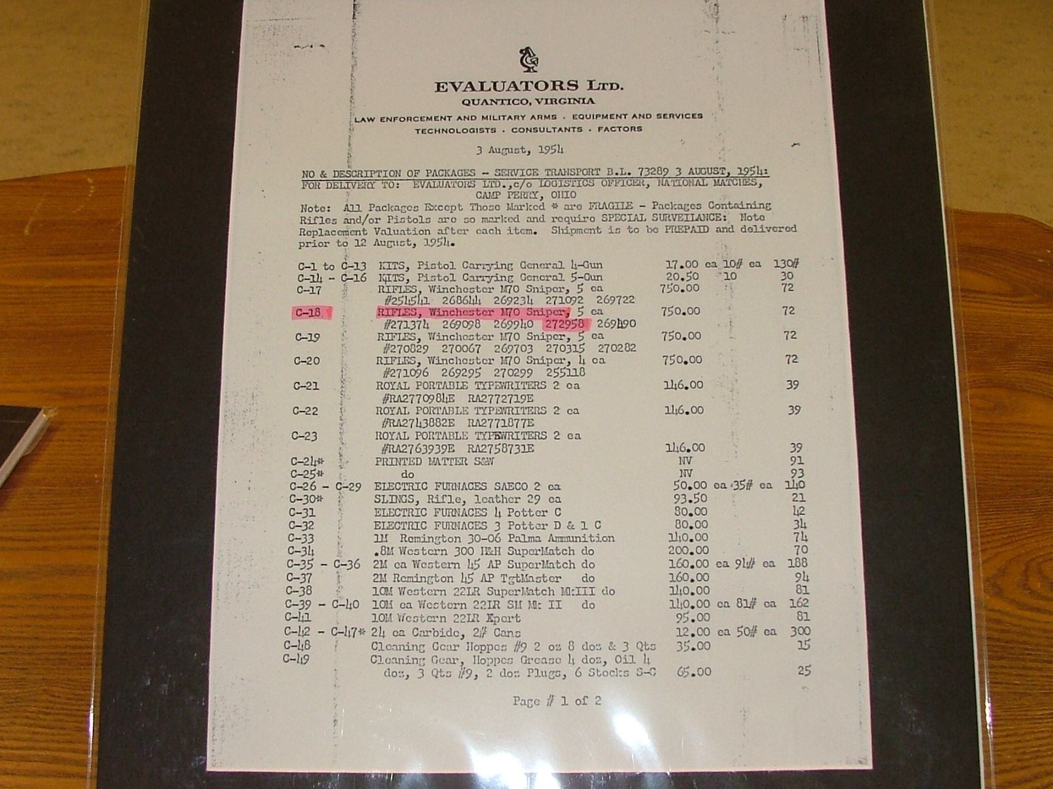

At one time Mr. Senich and I traded much info on Sniper Rifles. I had several of them, to include one of the finest, documented, examples of a USMC M1903A1/Unertl. I do not know what happened to all his research. I didn’t even know he had passed until a few years later. I had sold all my Sniper rifles and started collecting in a different direction. Mr. Senich was a prolific writer and wrote some real nice books. I was proud to call him my friend. I don’t know if he had actual documents or copies. I would guess, actual documents. When my M70 was given to me, I got copies of all the items sold at the 1954 NM’s. My rifle was on the list. I will post a copy here if I can find it. I do not have a copy of it in my files, but I do have the second page.   Big Larry
June 22, 2017 - 3:54 pm
Found the copy of the original receipt of my rifle and a few others.   Big LarryDSCF0200.JPG

14 cents/round for match .30-06 ammo? You think they still honor those prices? Laugh
On a serious note though, thanks for posting, thanks great documentation. I’d say the only way to get copies of what Van Orden had would be able to get into contact with his son. For the original factory papers, I’d probably have to contact someone like Bruce Canfield to see if has any old Winchester factory contacts.
