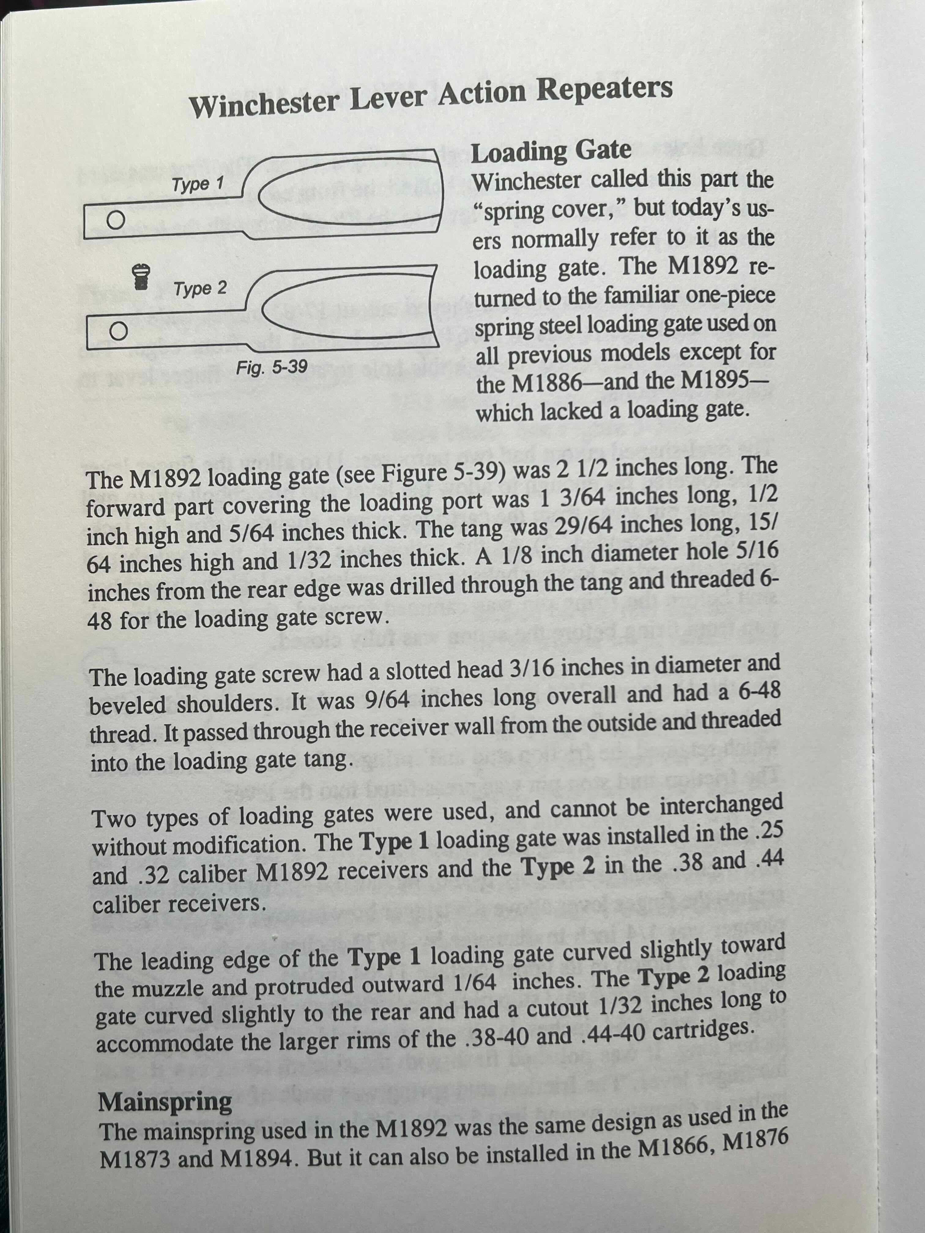

Hello gentlemen,
Could anyone tell me the difference between a 44-40 and a 32-20 or 218BEE?
How to differentiate each one, is there a measure or marking?
Thank you for your help
Jack
Forum Posts: 2765
February 3, 2026 - 6:51 pm
This should cover your question  The .218 Bee will use the same small caliber gate.
