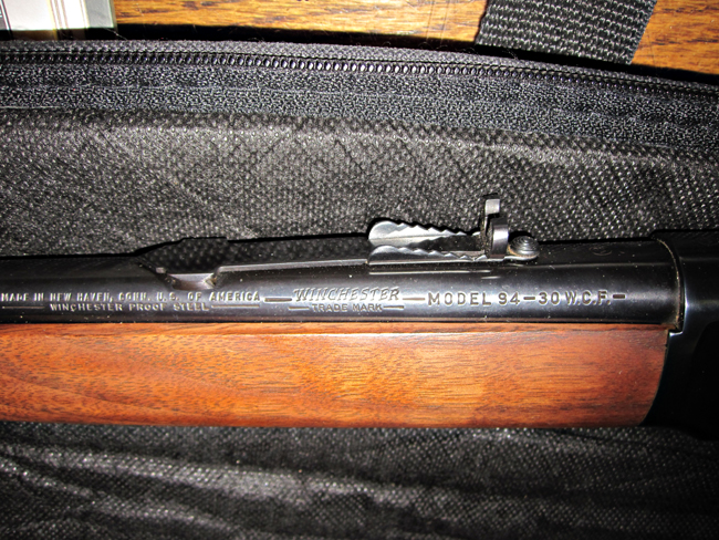

Here are a couple of photos of the rifle.  I’ll see if I can get some more later.  I agree with the hood on this rifle, seems wrong.
I checked the serial number several times while looking at it this morning and the 807973 is correct.  If their was a 1 in front of the 8
it would put it at 1951 date.  That might make more sense.  I don’t think he is interested in selling it right now.  It just looks too new
for the serial number.  Which raises a flag to me.  I’m just beginning at this Winchester rifle collecting, so I’m really out of my comfort zone here.
I’m just puzzled about the 1915 number and the newness of this rifle.  Anyway interesting stuff.
Forum Posts: 2543
December 14, 2016 - 11:26 pm
With only 2 photos, I am not provided with much information. BUT, the barrel has been replaced with a later style barrel. Those markings are not on barrels dating from 1915. Also, not great photos, but receiver may have been refinished and/or wood was refinished.
Edit: Enlarging photos, receiver definitely has been refinished. Stock looks like a replacement. I think you have a gun made up from parts surrounding a reblued receiver dating from 1915.

Completely refinished!

Add to the problem:  the rear sight is not a Winchester sight.  It is a Marbles replacement sight and the least desirable of all.
Also, thought the photo that includes the saddle ring isn’t the best view, there is absolutely no wear that I can see from the ring rubbing on the receiver, so it is either like new or refinished.  The Marbles tang sight does look like a nice old Automatic one.
I’m thinking parts (Frankenstein) gun. Looks nice indeed but Don’s first instinct is probably correct. If anyone tells me a 100 yr old rifle is unfired red flags pop up immediately. It’s possible, but I’ll need more than assurances.

Don,
The barrel markings predate 1951, so it can not be serial number 1807973.  Additionally, saddle rings were not available in 1951.
I am in complete agreement that it is a rebarrelled, and a refinished gun.  The saddle ring is misaligned, which is another sure sign that it was disassembled and refinished.
