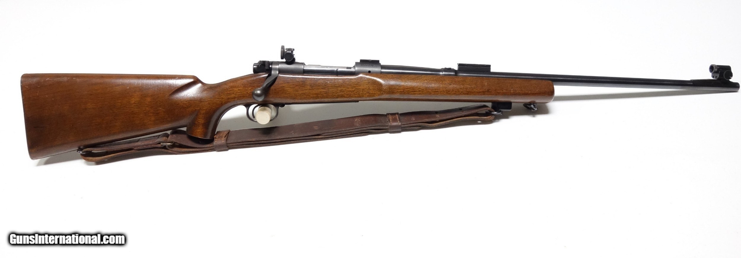

First, this is a pretty nice PRE-64 National Match rifle from 1953 (S/N 255001).  Note the standard weight barrel with low integral front sight ramp.  Stock is typical Marksman with checkered metal butt only the stock is inlet for the standard barrel contour:

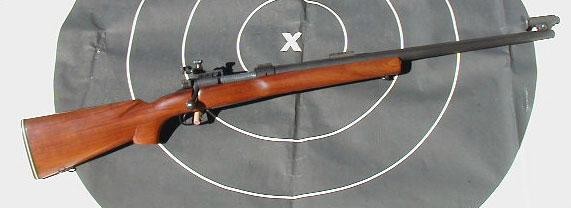

Below are a couple of internet photos of POST-63 M70 target rifles.  The barrels are straight taper medium heavy contour (like the pre-64 targets).  The actions are post-63 (no Mauser type extractor) and the S/Ns would be >700,000.  Resolution’s not great I think you can get a sense of the butt pads the factory put on these.  They are actually rubber pads (not plastic) with white line spacers.  I suspect they were made for Winchester by Pachmayr, who made the ventilated white line pads the factory put on late pre-64 hunting rifles like the 300 WIN MAGNUMs:
A serial number from the gun you looked at would probably clear things up.  Hope this helps… Smile
May 10, 2020 - 7:07 pm
Thanks for photos, Lou. They confirm it’s really a Target model–no front sight ramp at all, only a block.  Can’t get ser. no., but is 700,000 the cut off between pre- & post- ’64 production?
