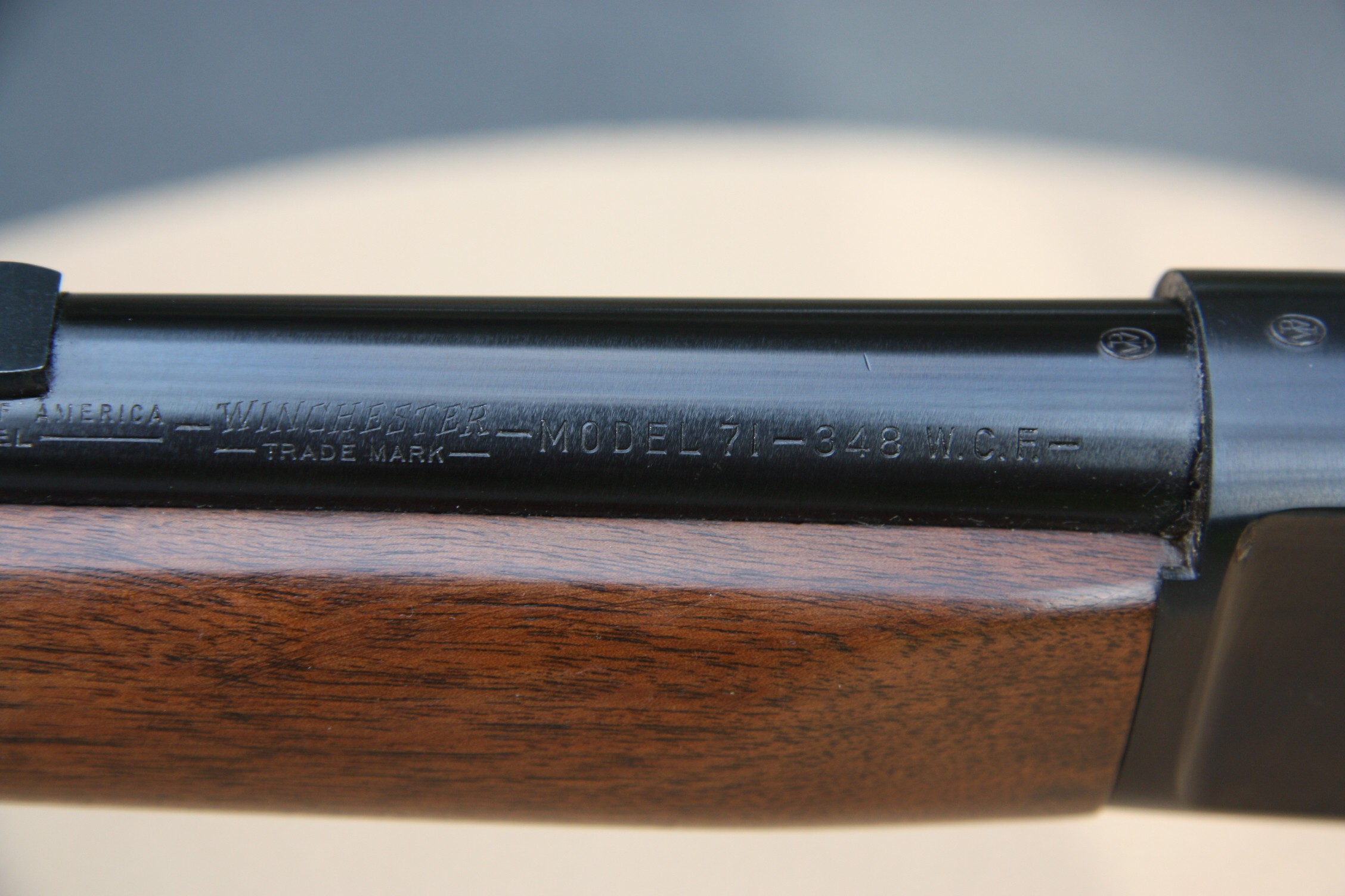

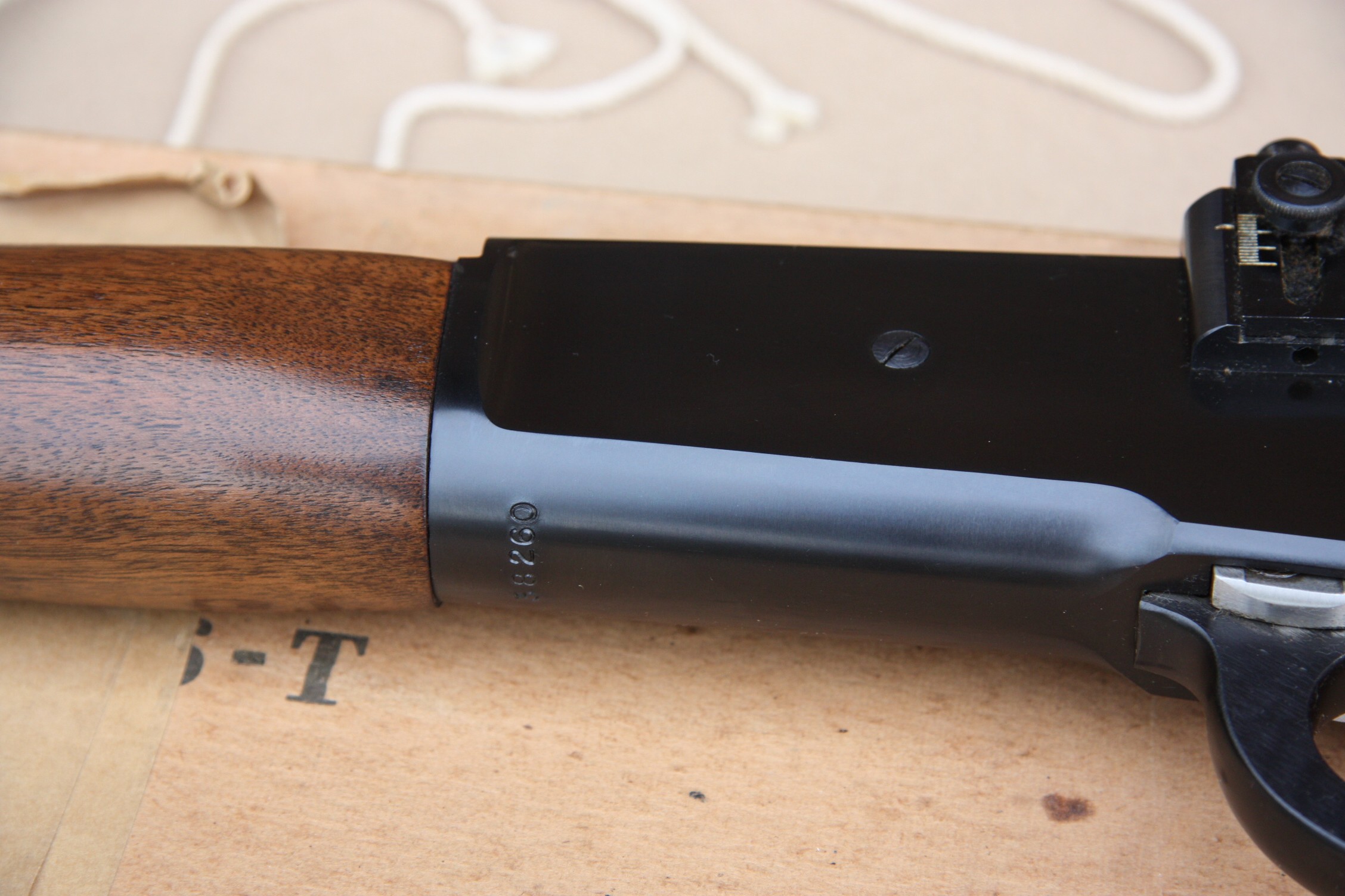

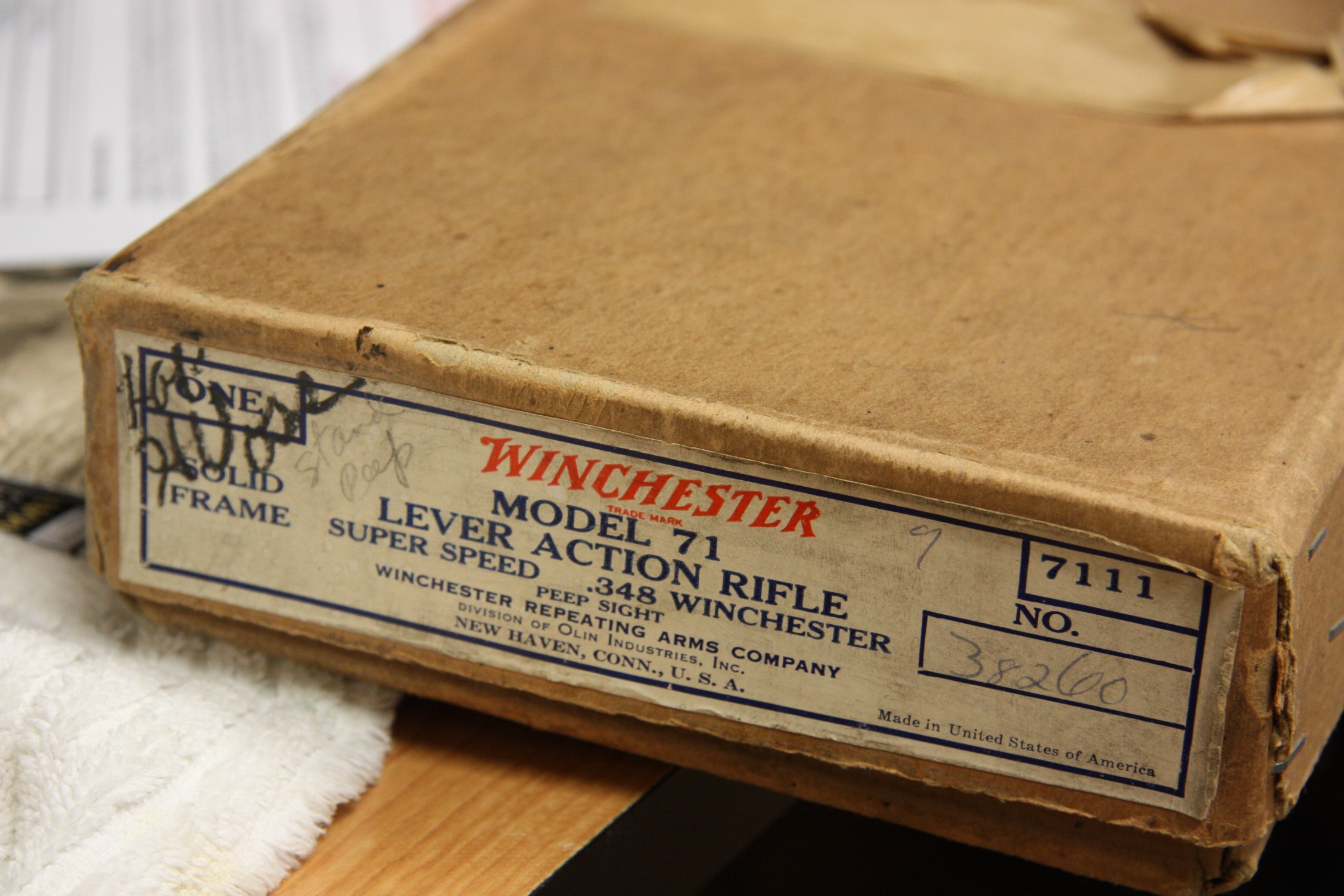

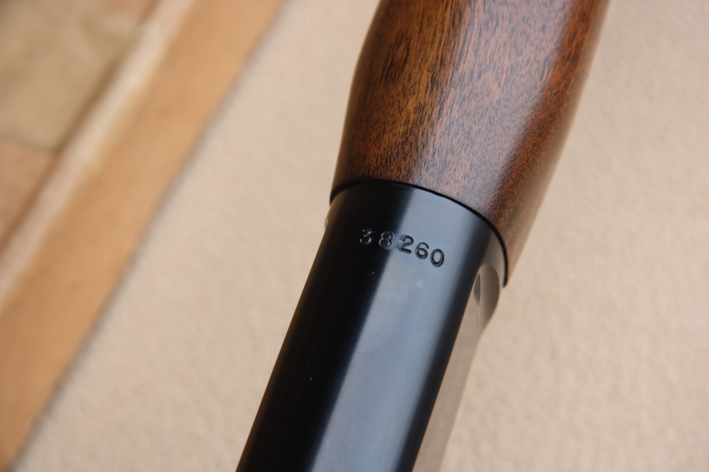

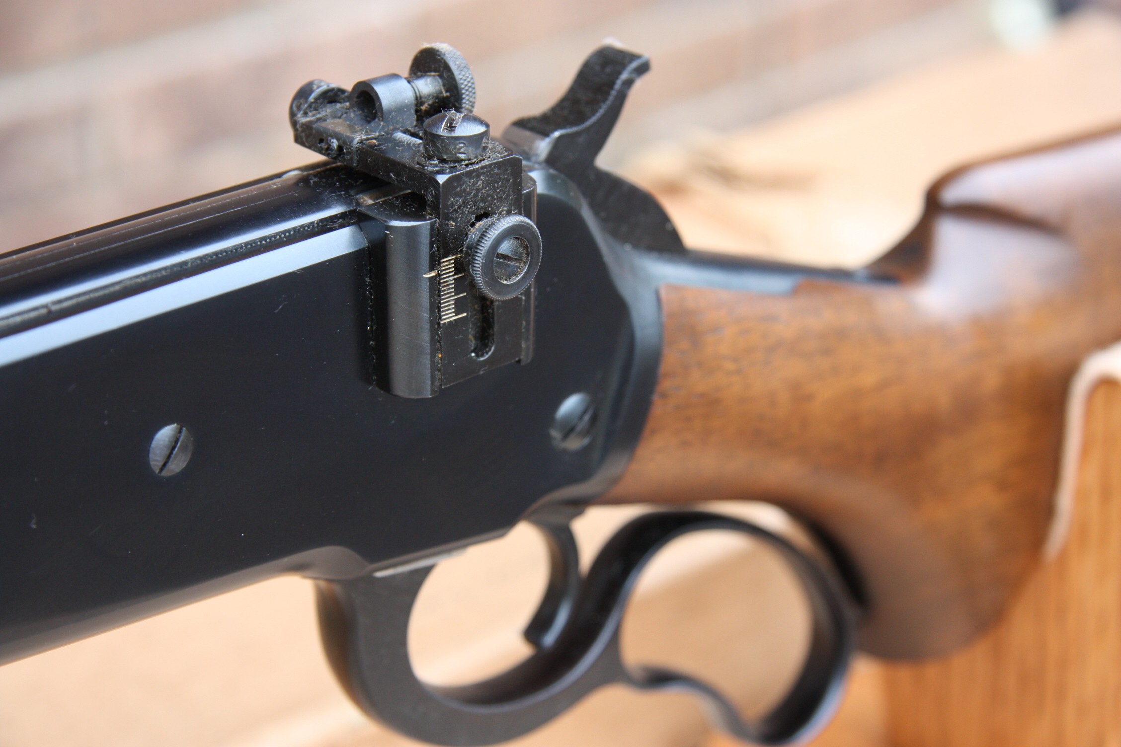

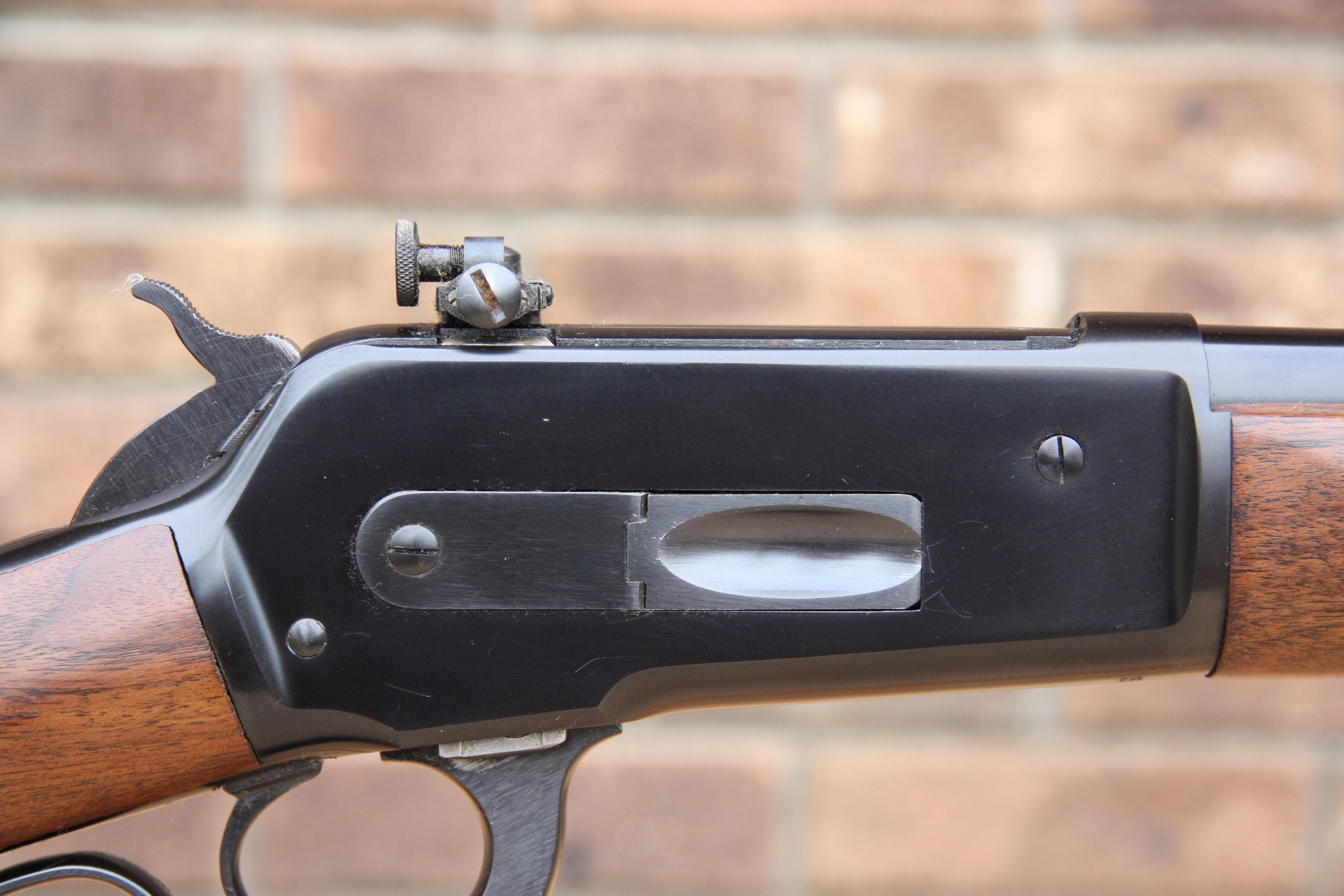

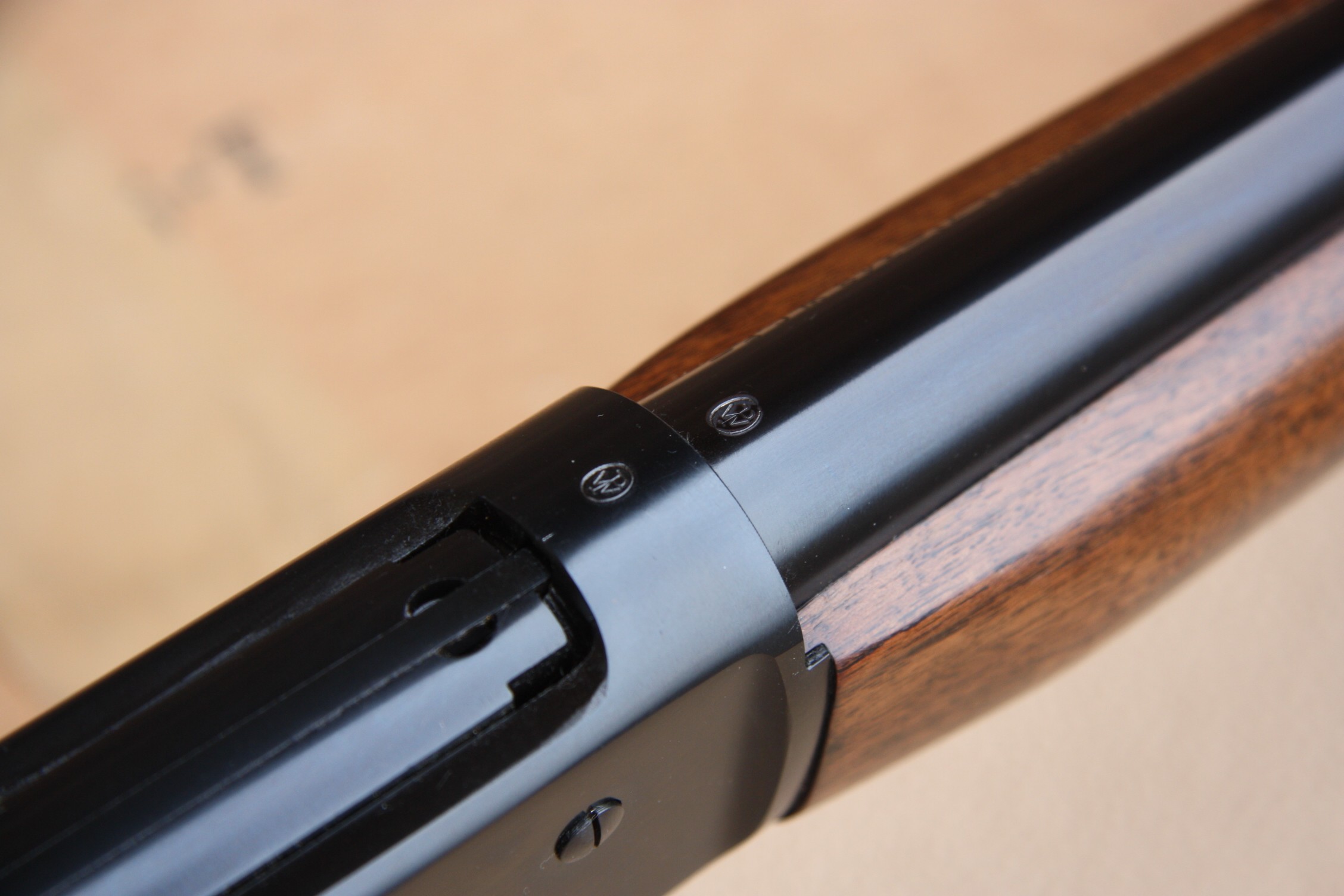

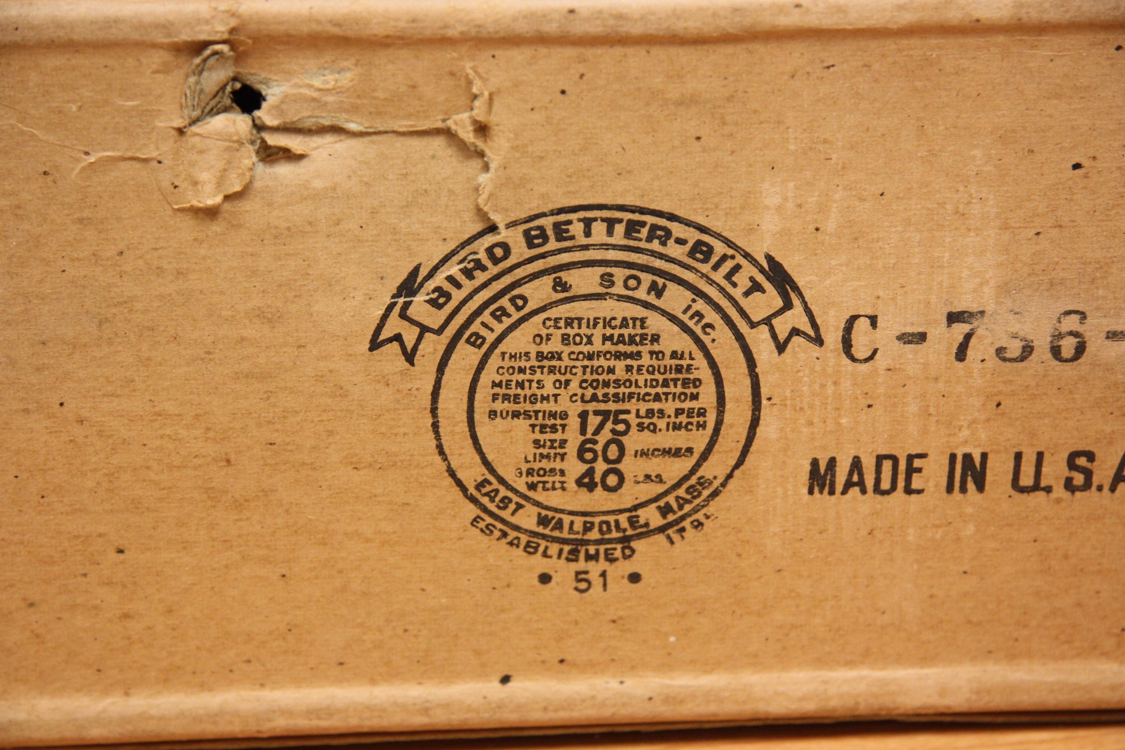

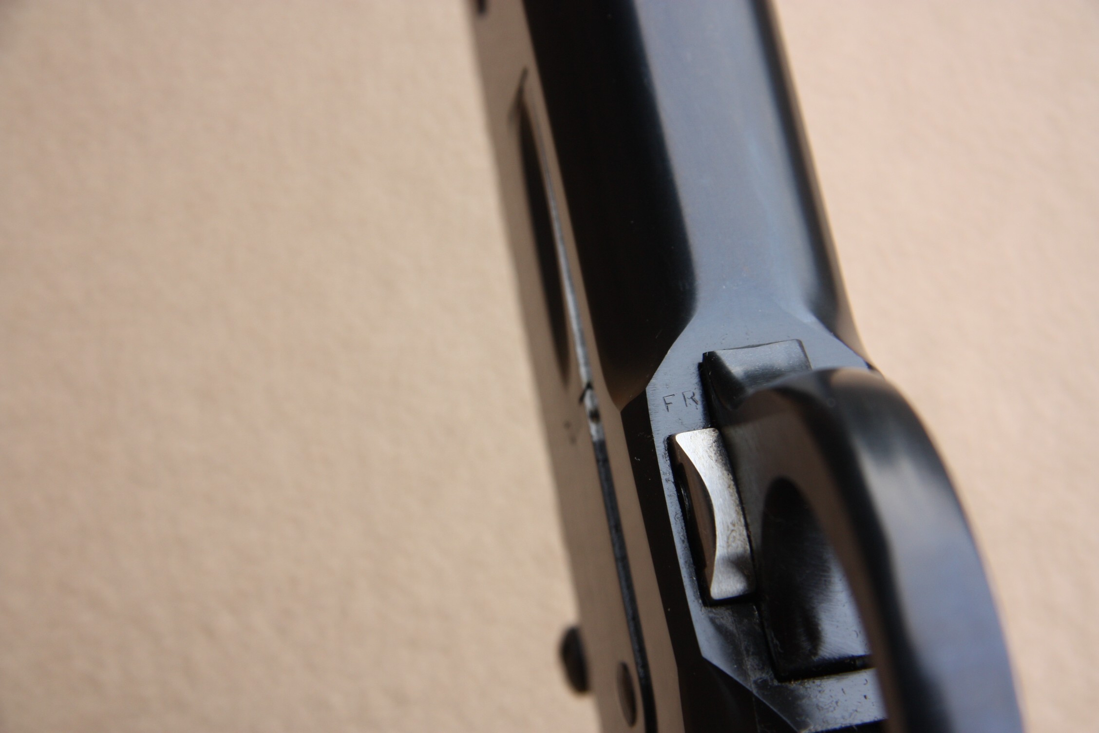

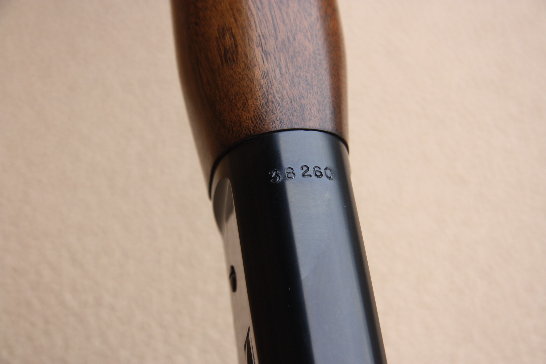

I am certainly no expert by any means on the production practices of the model 71, or the Model 71 in general.  But I used to have a new in the box Model 71, serial number 38260, made in 1952, which I am almost certain that it was all original.  Here are some pictures that may, or may not add any value to this conversation.

Al,
It is easy to see the sharp (clean) edges of the proof mark stamps and the slightly lighter (dark graying on the periphery of the proof mark stamp on the barrel.  Further, it is easy to see the raised edges on the right-hand side of the “8” and left side of the “2” digits in the serial number.  These are all clear evidence that it is a NIB rifle.

Thanks Bert.  Like I said, I used to have it but sold it some time ago.  Probably should have kept it.

I’m not seeing the “blooming” in Al’s example just above (post #43), those numbers look blued after striking to me….but agree on the sharp other markings…what am I missing?

You need will need to enlarge the pictures to see the raised edge rims on the serial number.

Here’s a couple more pictures of the serial number.

Thats a peach! Doesn’t get any better. It is however too early of a serial number to support or disprove my observations. My obersvations are on very late guns – later than this.

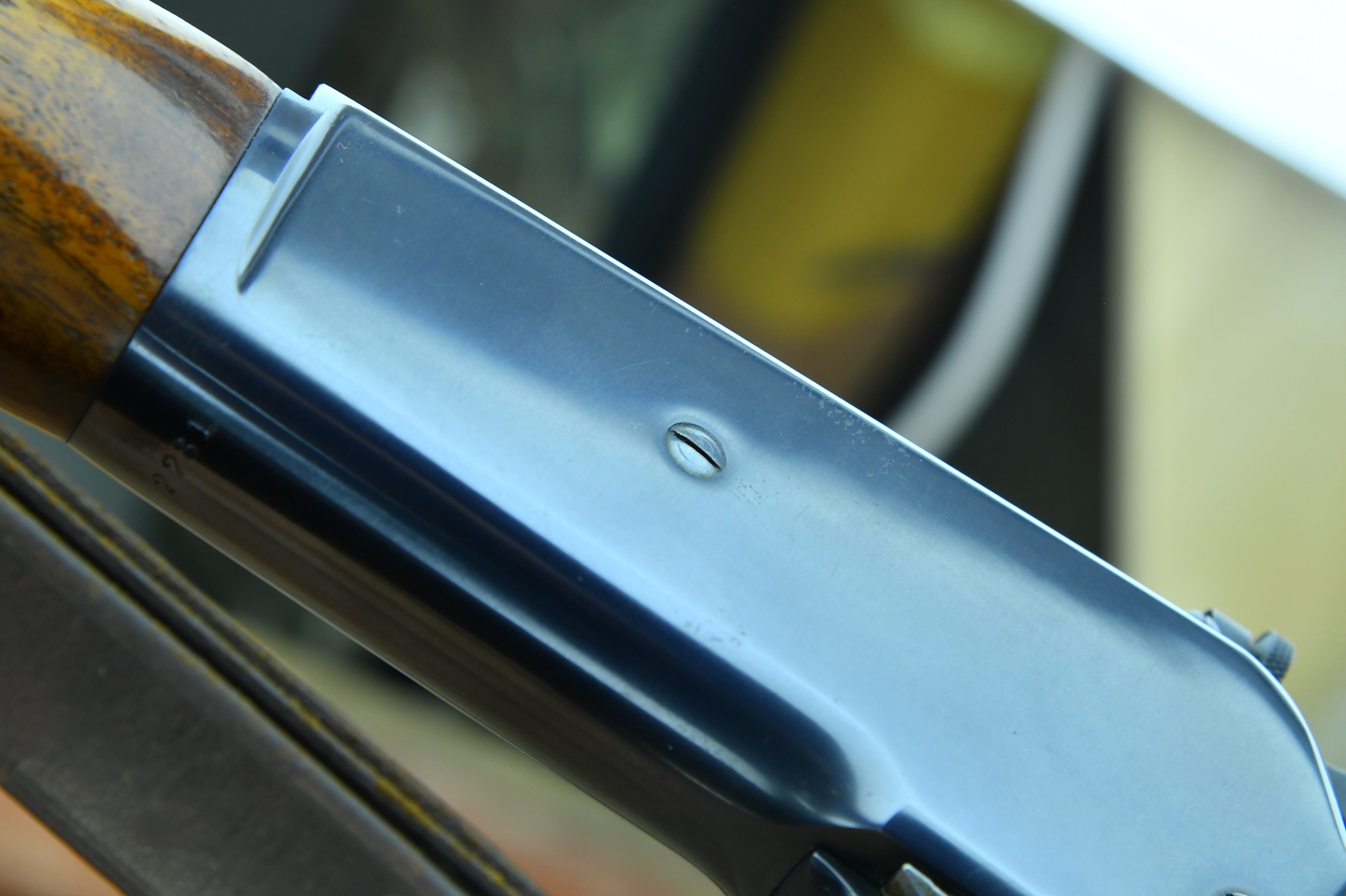

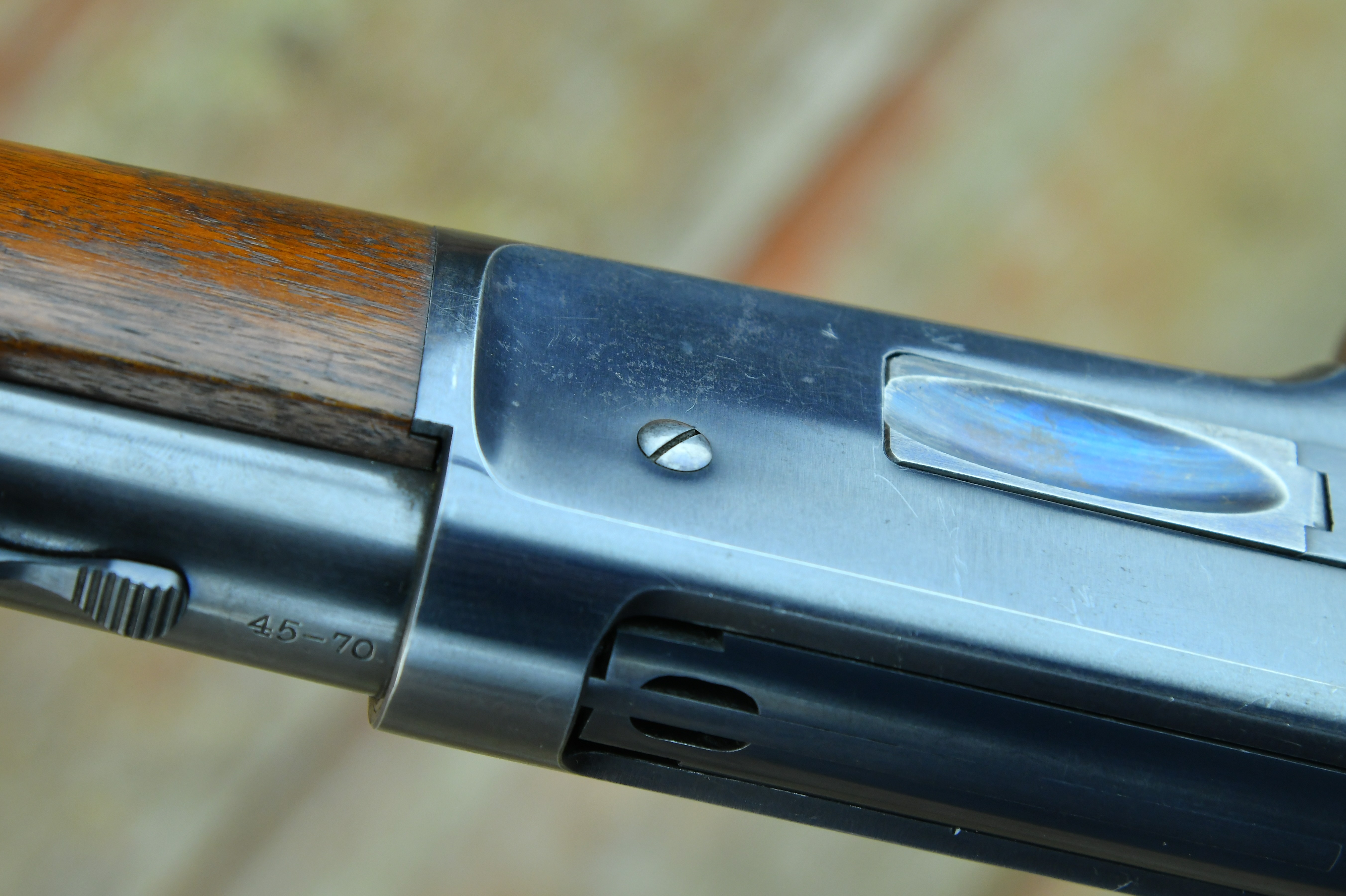

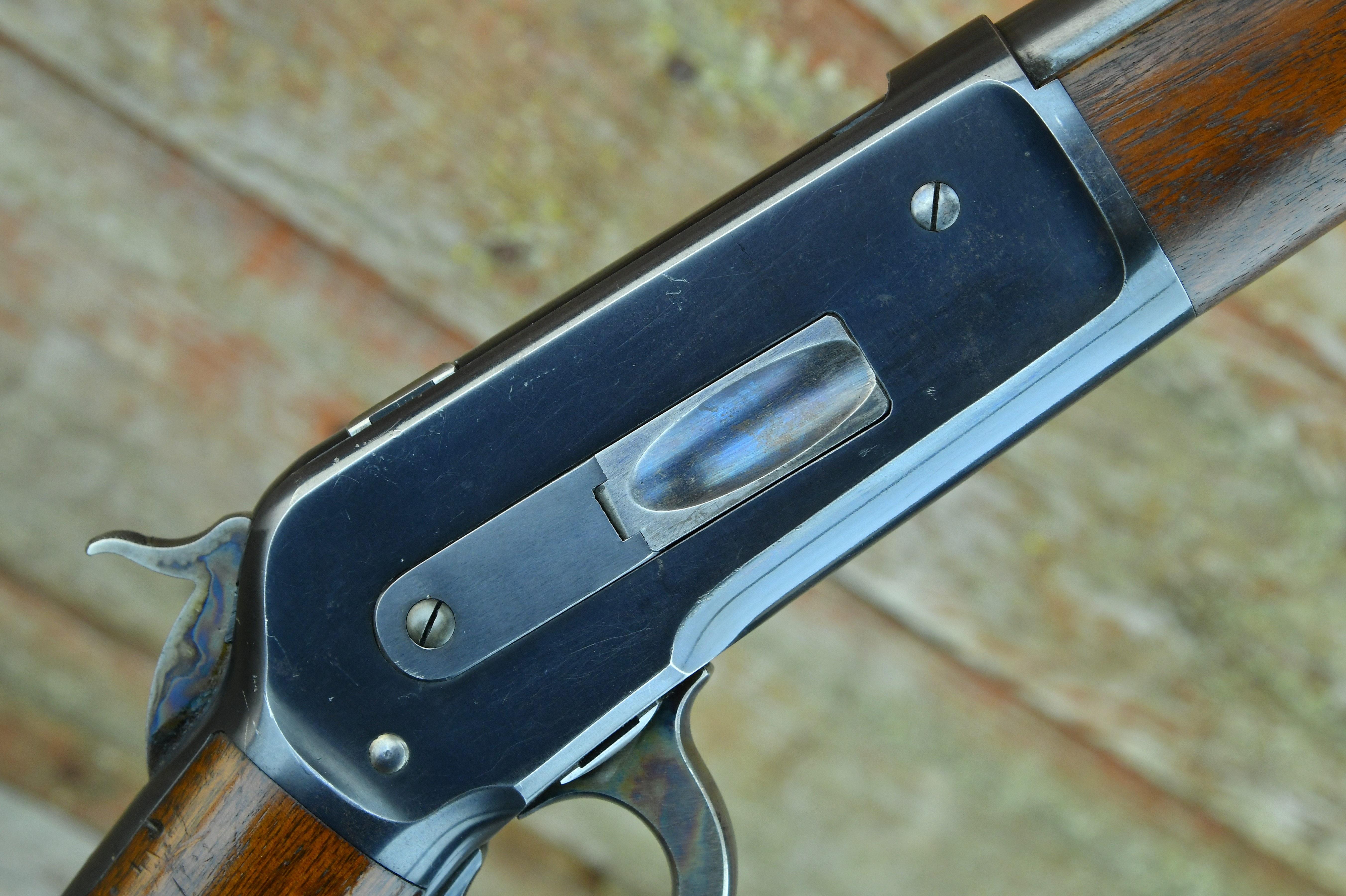

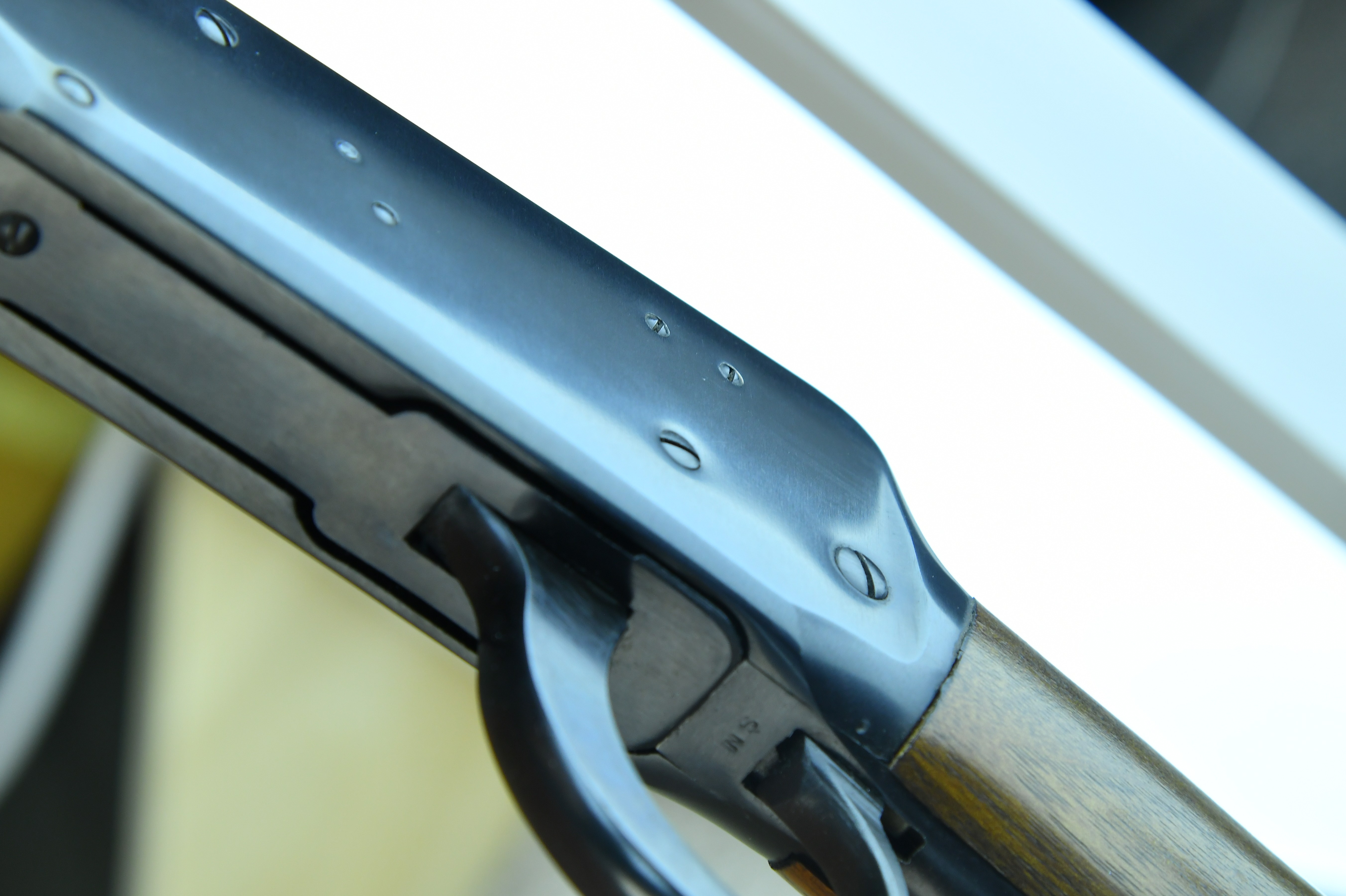

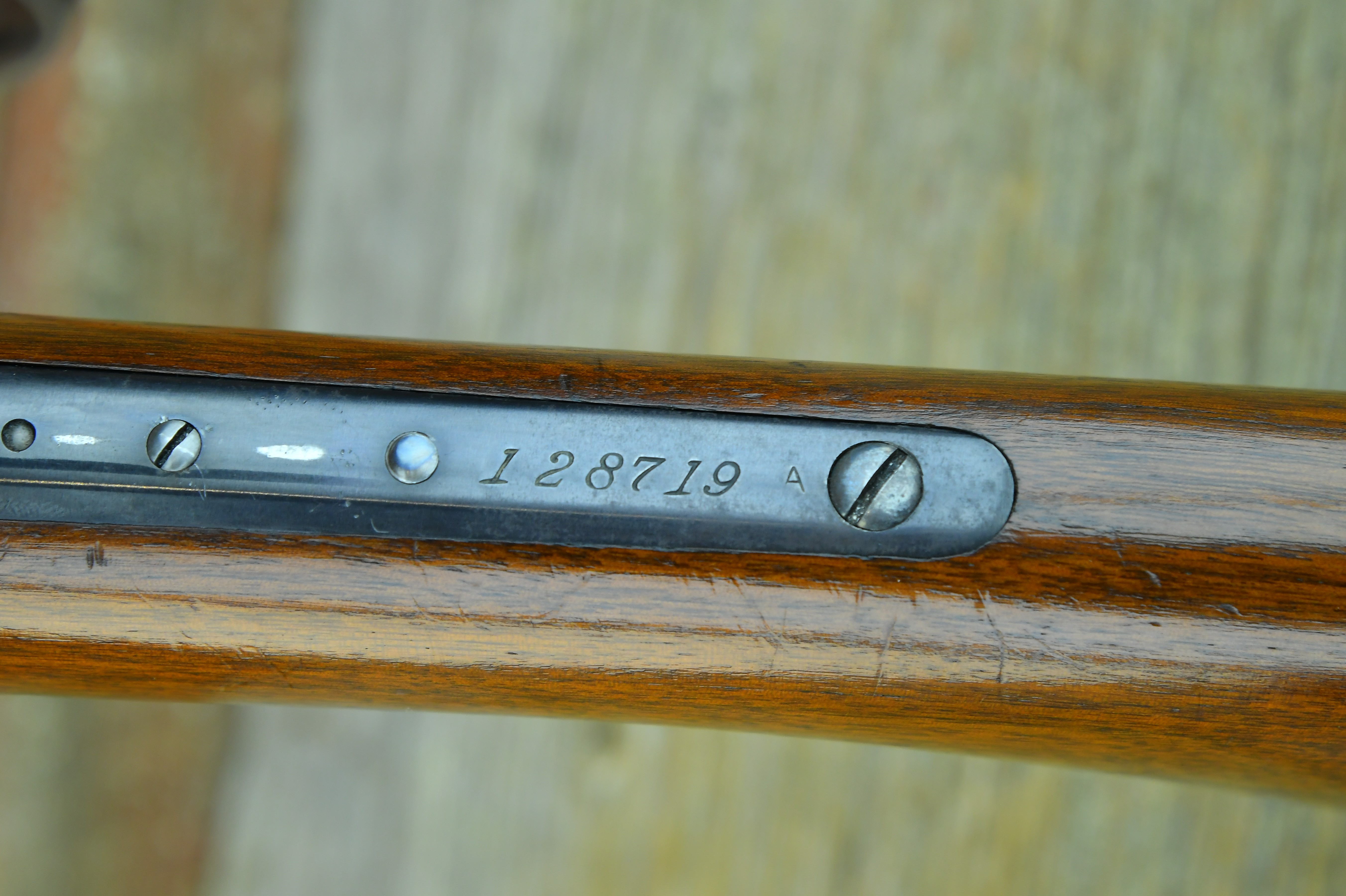

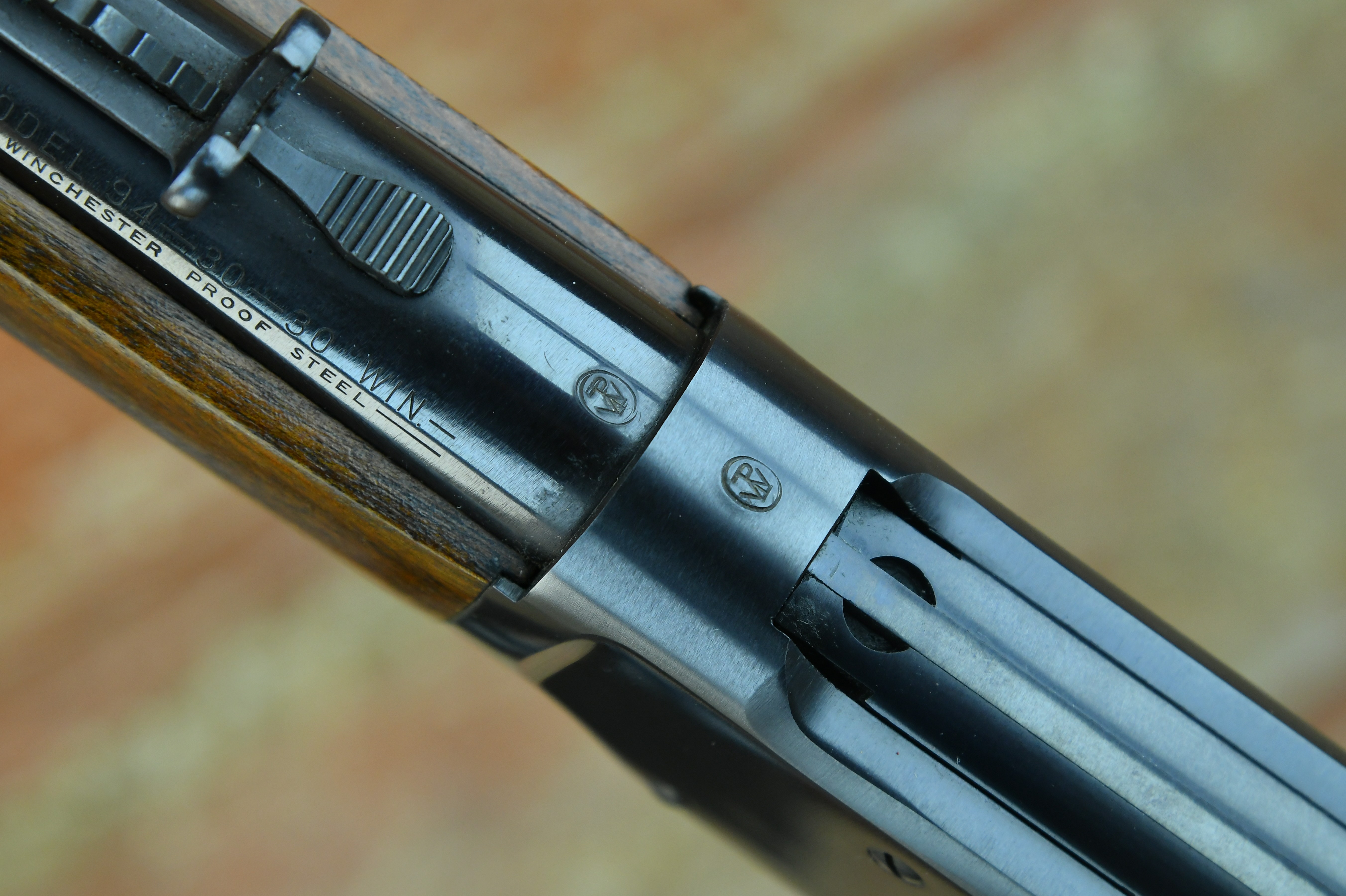

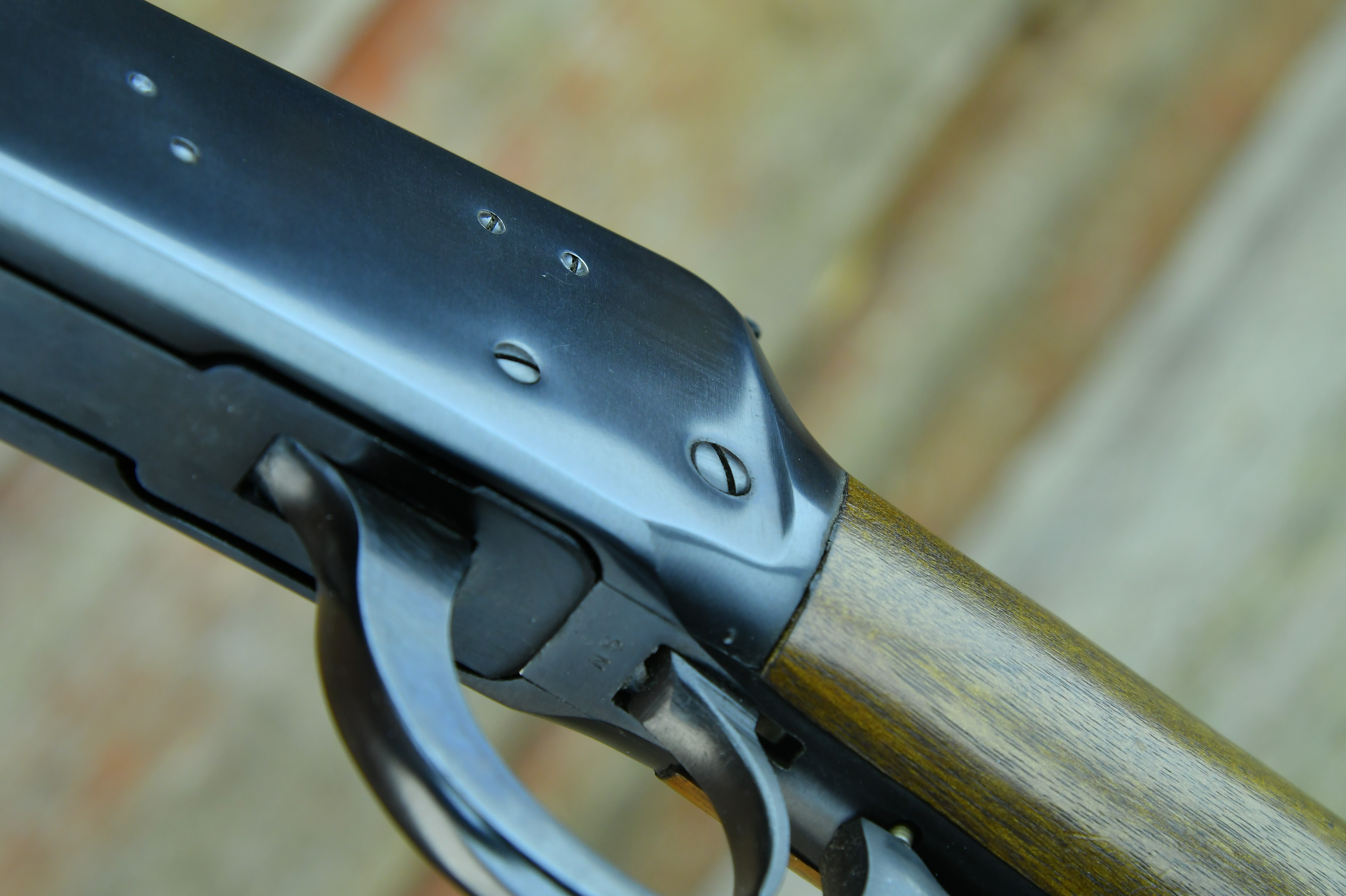

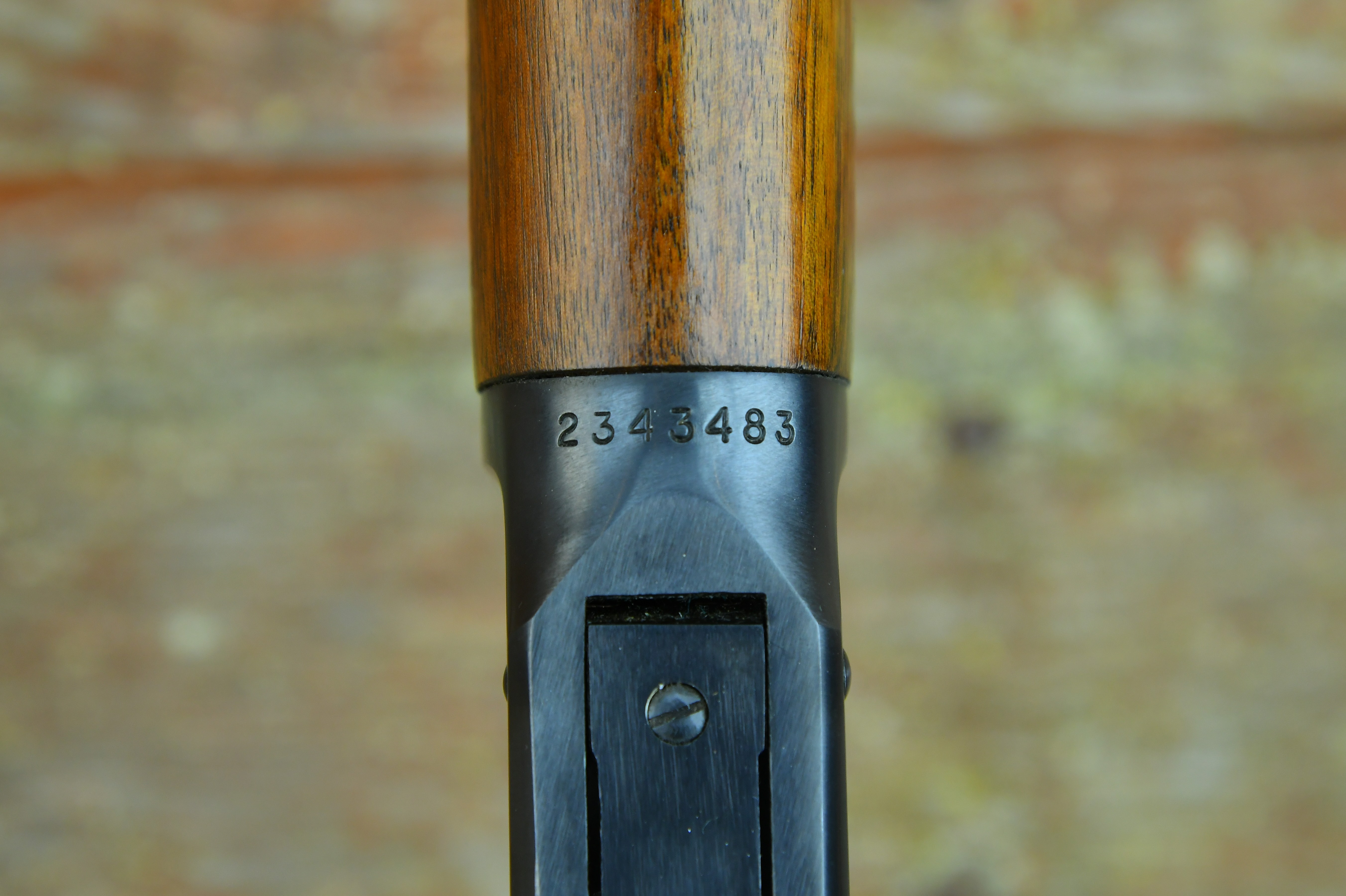

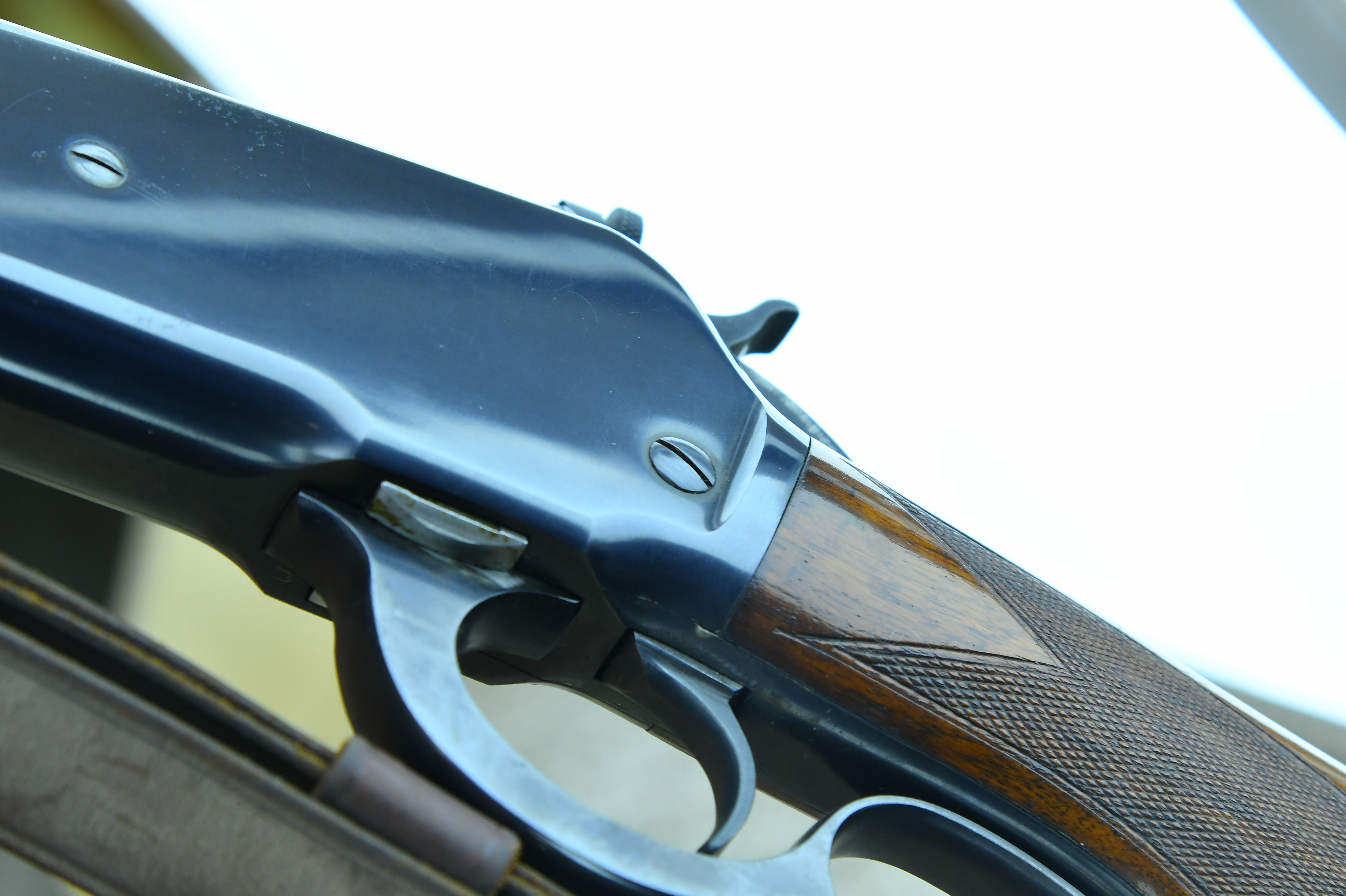

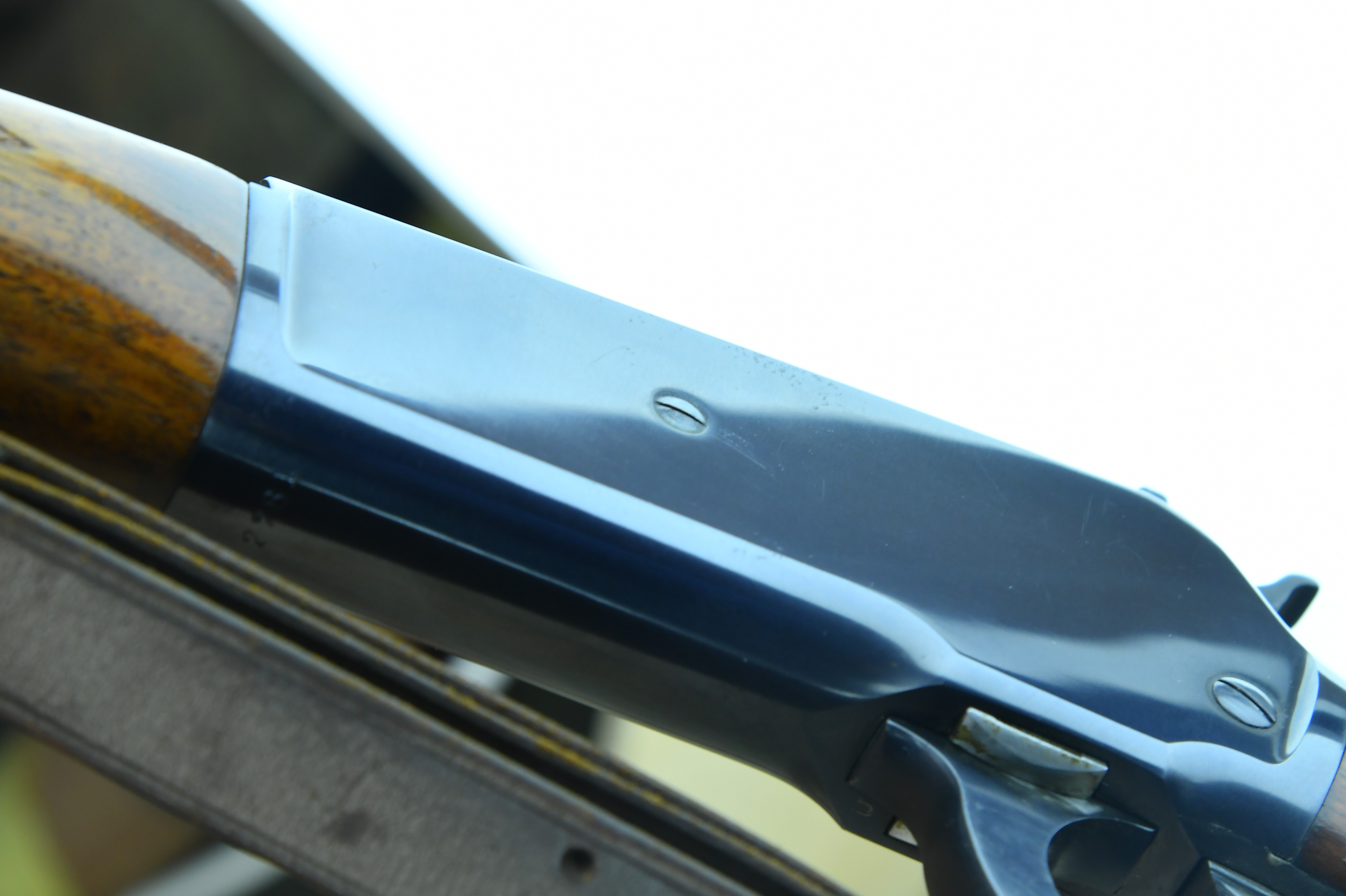

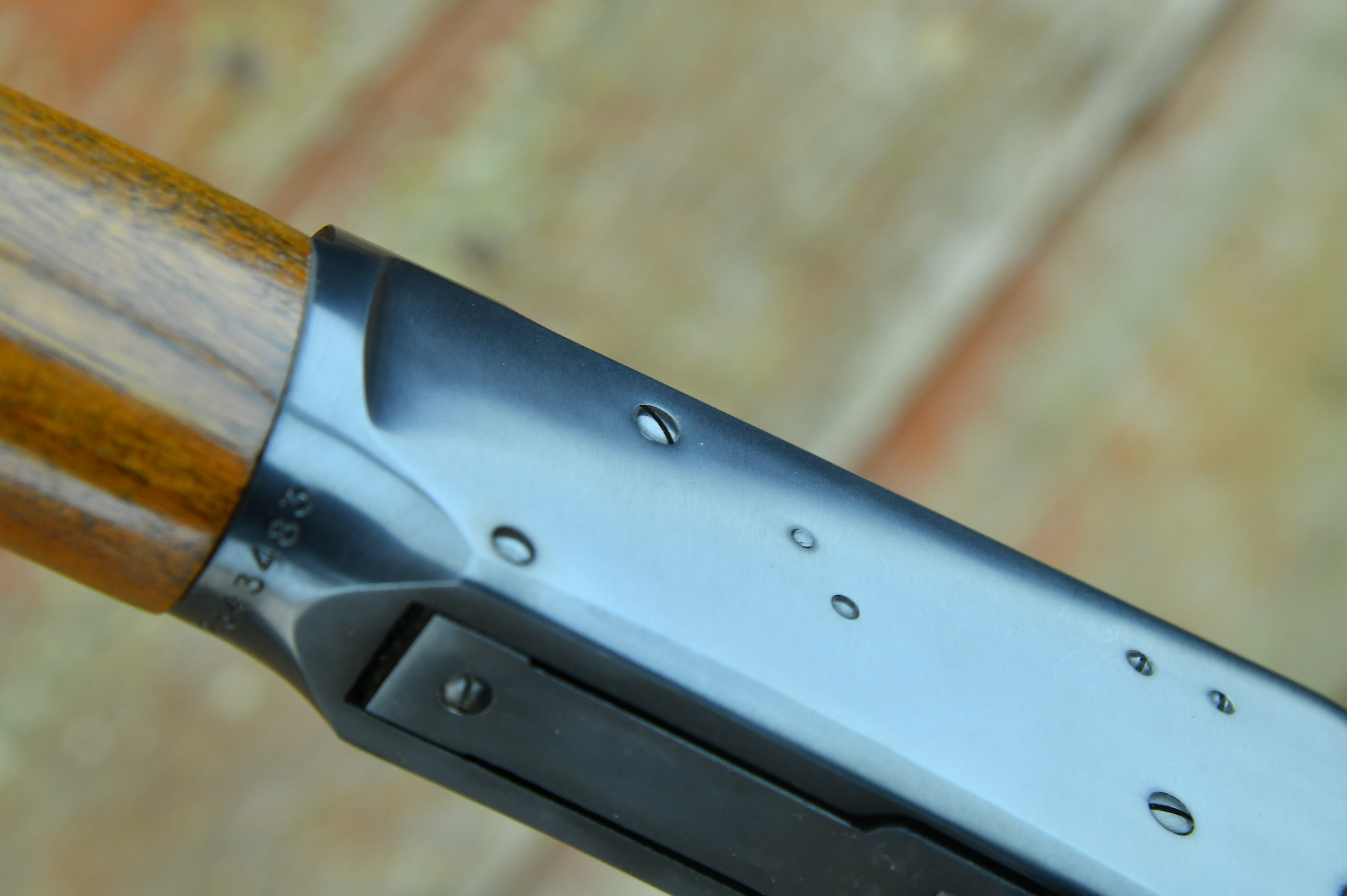

Bert, I respect you in a lot of ways. But I do feel you need to remove your blinders for a minute and open up to the possibility that there are a lot (if not all) of the very last model 71s had blued over serial numbers and some different characteristics. I have owned or observed way too many with the exact same finish that exhibit this. They come from all corners of the country, many fresh “out of the woodwork”. I have a very late, high condition deluxe rifle coming in a group of guns in the coming weeks (not one we have discussed). I will try to document it on a forensic level perhaps in a separate forum post. This one seems to have gotten off-tangent.
Regarding the recent post of mine, the Gunbroker link/ Model 71 #46677. I disagree with your comment “proof marks are too thin” and “visual evidence of dishing around the receiver frame screws”. First, The proofmark on the barrel for sure shows evidence of the deformation we all look for. Not buffed. And the receiver proof is washed out in reflection. Looks just like most all models in this timeframe the receiver proof mark isn’t as deep. Why? I don’t know, perhaps receiver hardness? You probably have some data on that. I have thousands of close photos of proof marks if we want to do some looking. Secondly, the dishing of screws? Give me a break. Yeah, bubba usually dishes the heck out of receiver sides when he reblues a gun. But I have news for you, all factory original Winchesters have dishing around the screw heads as well. They were not perfect at buffing either. And depending on how you take the photos, they will show up. I have pulled 3 original rifles and took some photos for you with emphasis on the dishing. A late model 94 as new, a very nice model 1886, and a high condition early model 71.
