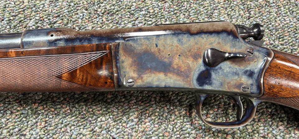

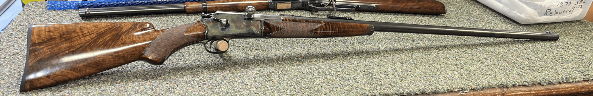

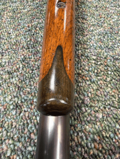

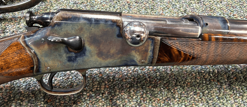

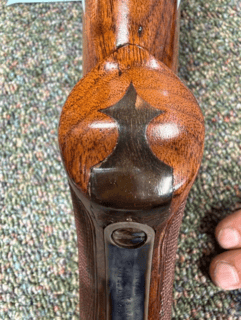

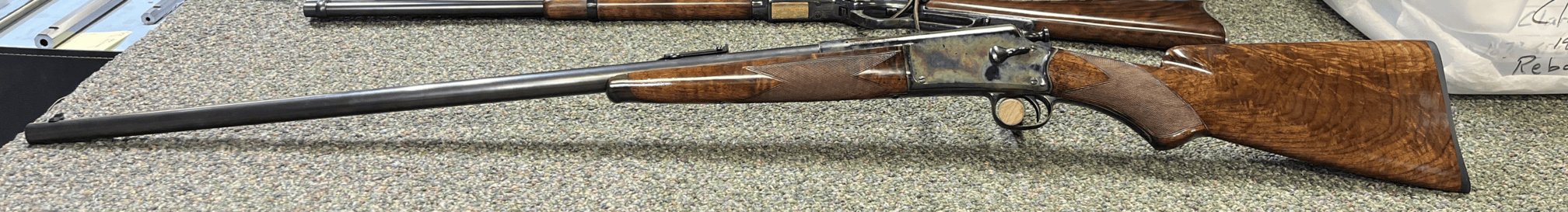

September 27, 2026 - 11:53 am
image-6.pngimage-1-1.pngimage-2-1.pngimage-3-1-1.pngimage-4-1.pngOutlook-0b3yxqem-1.png

I got a call from Cameron at Wyoming Armory on Thursday. He told me that work had been completed on the Hotchkiss and that he was forwarding me pics of the completed rifle. She’s beautiful! I can’t wait to have her in hand. Mark and his team did a fantastic job of brining this old girl back to her former glory.

Wow – it looks fantastic!  What a stellar job Mark and his crew did!
That’s one I wouldn’t take in the woods.  It’s too perfect.

Great time of year for a road trip to Cody! I’m very impressed with the restoration of the spectacular wood on your rifle. I had to check the earlier pics to see that it was the same wood, I’m glad they were able to use it. Mark brags on his stock guy and we can easily see why on this rifle. Receiver colors came out great.
After all the trouble Mark went to for this barrel you know you’re going to have to shoot it. Congrats, drive safely!
