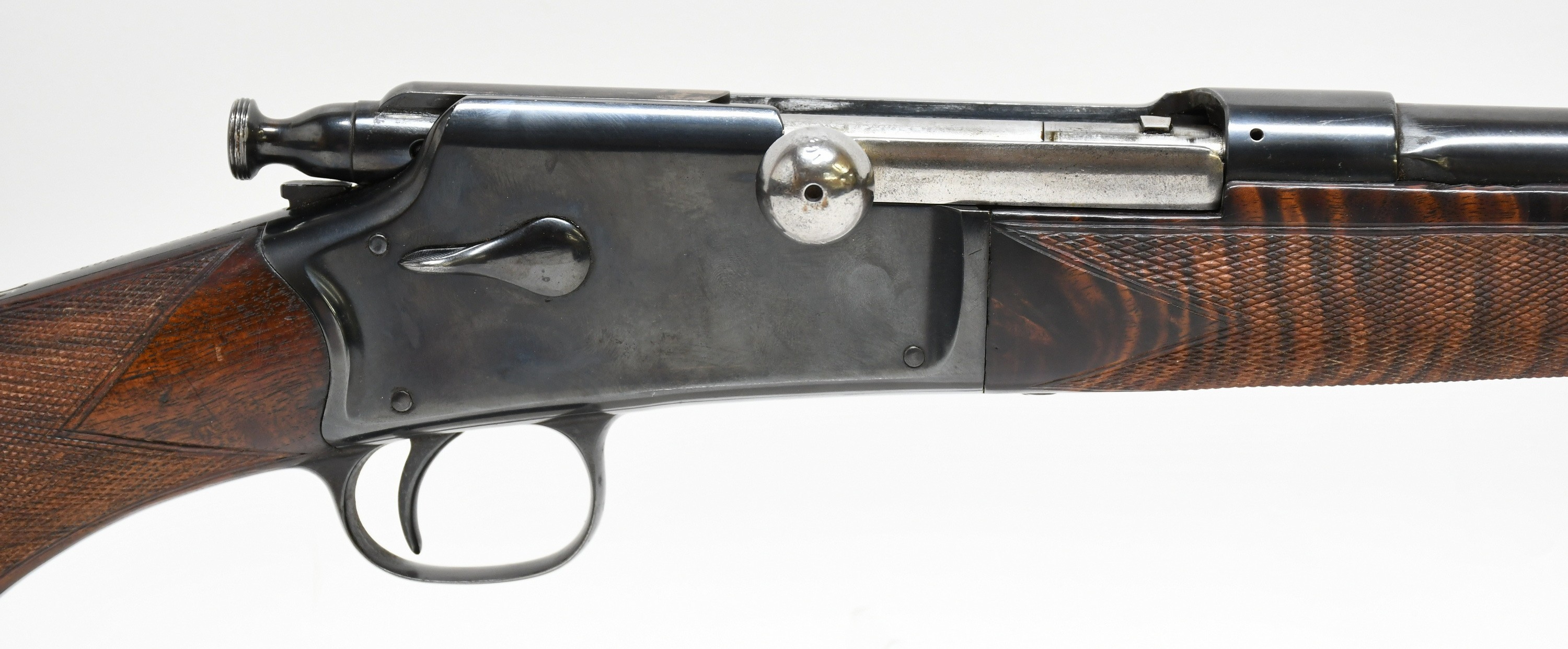

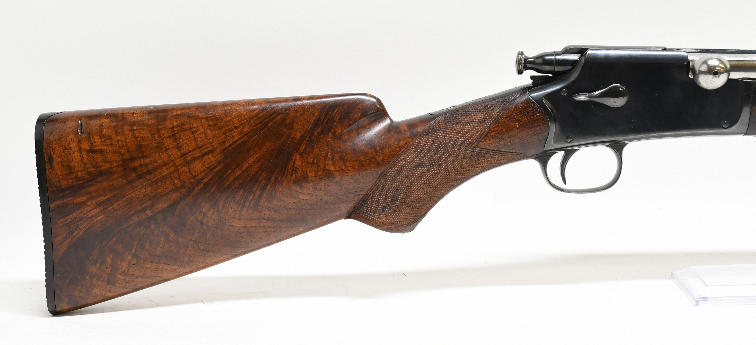

Back in October, I stumbled upon an ad for an 1883 Winchester Hotchkiss that was for sale. The ad was without pictures but the description mentioned that the rifle was checkered. Knowing that most of these rifles were made for military use, my interest was piqued. I asked the seller to send photos which they did. I realized that this was not your average 1883 WH.
I started doing some online research when I stumbled on Jim Curlovic here on the WACA forum. Jim told me that he could get the records from Cody if I promised to become a member (which I promptly did). Jim informed me that this rifle is one of 28 1883 Winchester Hotchkiss Fancy Sporting rifles! The Winchester letter states that it left the factory with a round barrel and rubber butt plate. I was shocked to say the least.
The seller told me later that the rifle was unable to fully chamber a 45-70 dummy round and that they were sending it out to have a “professional” inspect it. I have kept in touch with the dealer since Oct. but had never heard any info about the functional issue. I’m sure that the dealer has no idea of the rarity of the rifle.
Yesterday, the dealer finally called me to talk about the rifle. I don’t believe that they ever sent it out for inspection. I told the manager that my intention is to restore the rifle back to its original configuration. That will include a new barrel with correct roll stamp. We struck a deal, and I was able to purchase the rifle for $800.
I trying decided if the purchase price was good or not but, it was love at first sight. I am not necessarily a Winchester collector (I own a Model 97 Black Diamond). My interest is primarily with vintage sporting rifles. I enjoy doing the conservation/restoration as well as reloading. Last year, I took a PA doe with my restored 1899 Remington Lee in 30-40 Krag (one of about 1400 sporting rifles).
This rifle is going to need work to get her back to its original configuration. I intend to have the Wyoming Armory color case harden the receiver after I do the metal prep. I suspect that I will need to have a new barrel installed with proper roll stamp. I probably will need to source some parts along the way. I plan on documenting the journey in this thread. I am currently working on a couple projects before I get to this one.

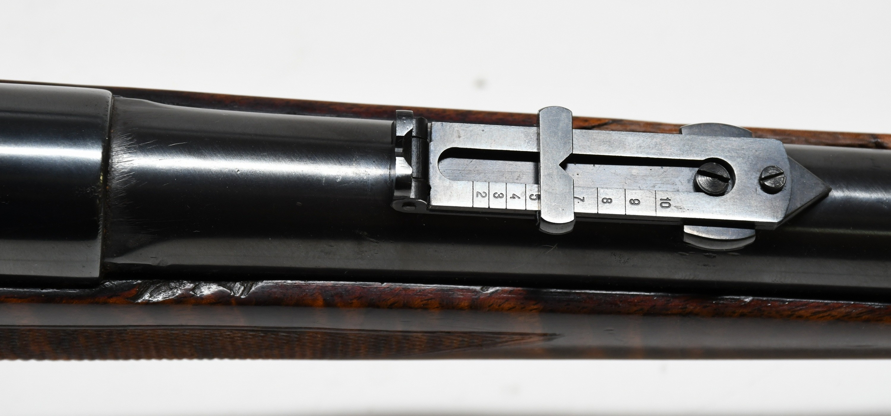

Here are pics from the seller for you to look at. I will post more once I get the rifle in hand.IMG_6850.JPGImage EnlargerIMG_6853.JPGImage EnlargerIMG_6852.JPGImage EnlargerIMG_6849-2.JPGImage EnlargerIMG_6860.JPGImage EnlargerIMG_6858.JPGImage EnlargerIMG_6856.JPGImage EnlargerIMG_6855.JPGImage EnlargerIMG_6854-2.JPGImage EnlargerIMG_6865-2.JPGImage EnlargerIMG_6868.JPGImage EnlargerIMG_6866.JPGImage EnlargerIMG_6861-2.JPGImage EnlargerIMG_6863.JPGImage EnlargerIMG_6862.JPGImage Enlarger

This has been an interesting journey for you.  I’m looking forward to following your progress.  Obviously you will know much more once you have it in hand.  But from what you do know, what are the current deviations from originality?

Hi Steve. Here is what I know so far. The receiver should be color case hardened. The barrel has no markings on it. I don’t know if it is a replacement or the original that has been altered. The forearm checkering is crude compared to the stock, but the quality of the wood and the horn inlay lead me to believe that it is original.
I’m not sure if the butt plate is original or not. Jim told me that he has not seen an original rubber butt plate.

I’d like to see a picture of the barrel address.  You should really not touch anything until Jim can get a better look.  Restoring something this rare will definitely ruin any value of the rifle.  If that is important to you.  I’ve only seen one of these for sale before and I was stupid for not buying it. I am not an expert on these and only have a military rifle and an earlier carbine.  My rifle is case colored and the front sight is very simple.
Like Steve said, what do you think is not correct?  Have you sent pictures to Jim?

Hi Chuck. I did send pictures to Jim when I first stumbled upon the rifle. He confirmed that it was an original fancy sporter. There is no barrel address on the rifle.
I’m certainly not going to do anything to ruin the value of the gun.  I do think that there has been some bubba gunsmithing performed. I will know better once it is in hand.

The ramp front sight does’t look correct and it is reblued, so restoring it correctly isn’t going to hurt it

I agree that the barrel is wrong but the rest may be OK.  Finding a replacement barrel will be tough if not impossible.  I will see if I have any info on the Sporters.

He stated it, letters as 45-70, it may be the original barrel that the roll stamp was polished off, it has the correct rear sight for a sporting rifle, the ramp throws it off. Wood looks fine.
