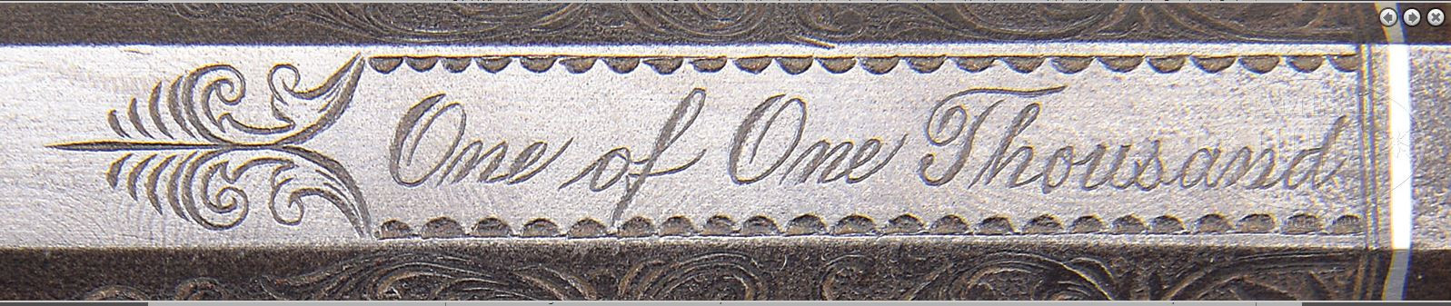

 In Julia’s upcomming auction, three 1 of 1000 73’s are listed.
Must say i have never had the chance to hold one of these rifle’s, but im keen to learn about them.
This one…..https://jamesdjulia.com/item/52692-1-397/
from my limited knowledge, looks to have a few question marks.
1, the broken lower tang and renumbered serial number is not pictured.
2, “the one of one thousand” marking looks to be a bit off, (so to speak)
3, is not this rifle to early for the cartridge lifter to be CAL marked.
4, starting price of 30K   seems a little low compared to others ive seen listed.
Just trying to learn, and appreciate your knowledge and comments.

The price estimate reflects the problem with the serial number.

 Julia’s has some of the best gun experts setting the estimates prices, $30,000 to $50,000 means the gun has problems. If it was honest they would estimate $200,000. T/R

 They are in the business of selling guns. When guns get to that level the buyer needs his own expert. If a One of One Thousand does not have the original lower tang and serial number you must assume there is another one with the same serial number. If the gun was restored they usually make a new barrel, the original barrel is never thrown away. Which gun is a One of One Thousand, the one with the original lower tang,  the one with the original barrel, or neither. Provenance of the gun matters. T/R

The carrier block caliber marking is right on the borderline.  According to Pirkle, the calibers started being marked on the block around serial number 30,000.

For what they are asking they should take the time to provide the photos.  My rule of thumb is to always “screen out”, never “screen in”.  There is a reason for their not posting a photo of the tang after they admitted there was something wrong with it.

The gun has been around for quite a while with the messed up serial  number. In 94 it showed up in the Gordon survey with the problem serial number noted. The auction company put a low estimate on it and if they thought it was real it would be a lot higher.

From what I saw of the lower tang it was clamped in a vise without padding so that tells me it was done by a garage gunsmith. Any professional gunsmith would know enough to use a padded vise.

 When Jim Gorden first published his two volume book set he included, ‘Survey of Winchester Model 1873’s Number 1″. He intended to update the Survey in the future but never did. In that book, ( number 1), on page 22 in the notes section Jim writes “1 OF 1000? SER. RENUMBERED”. The question mark is not what i call good provenance. T/R

Towards the end of the listing’s write-up there is a casual reference to the “restoration”.  “Edges of the stock around the top & bottom tangs were reduced during the restoration process.”  If you look closely at the 4th and 5th photos, the wood at the wrist has been sanded down so severely that just a little more and one could see daylight under the upper tang.

It is wise to keep in mind that the description usually says more about the rifle by what it does NOT say than it does by what is said.  Check out the inscription real closely and compare it to published photos of other legitimate model 1 of 1000 rifles!

Excellent eye!
