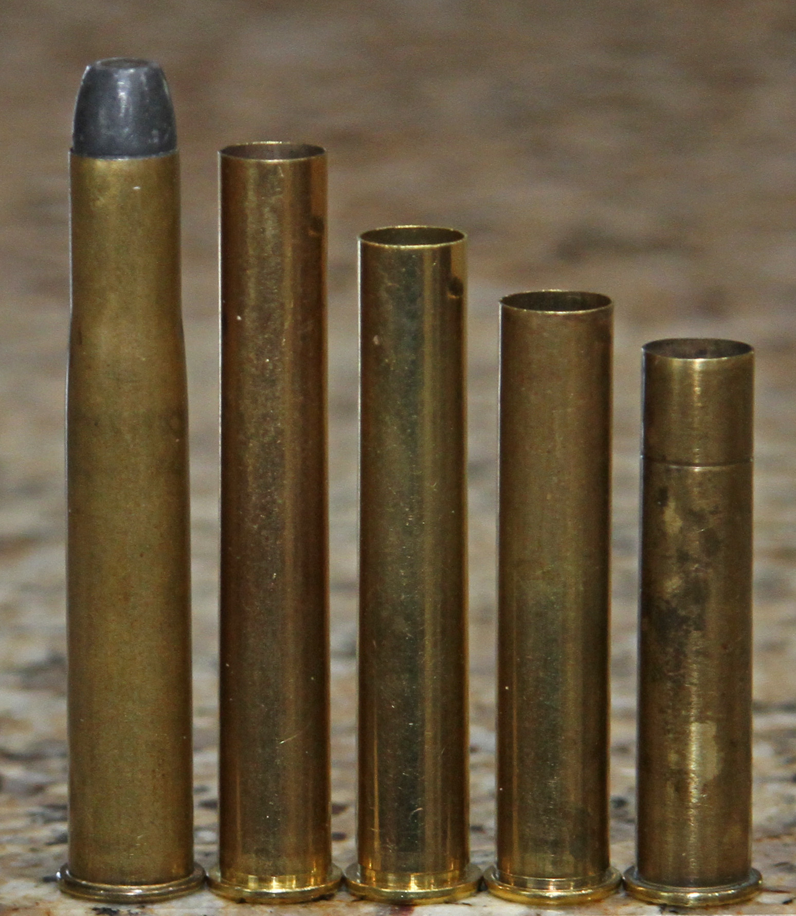

I bet these are just modified 45-70’s.  Or maybe a 45-90?  If someone is interested I can ask my military expert friend.   The 45 EX has a 3 1/4″ case and is  3 5/8″ OAL.
45-125-and-Misc-Long-Cases-1.jpg  What I am working on is on the left and a 45-90 is on the right.
