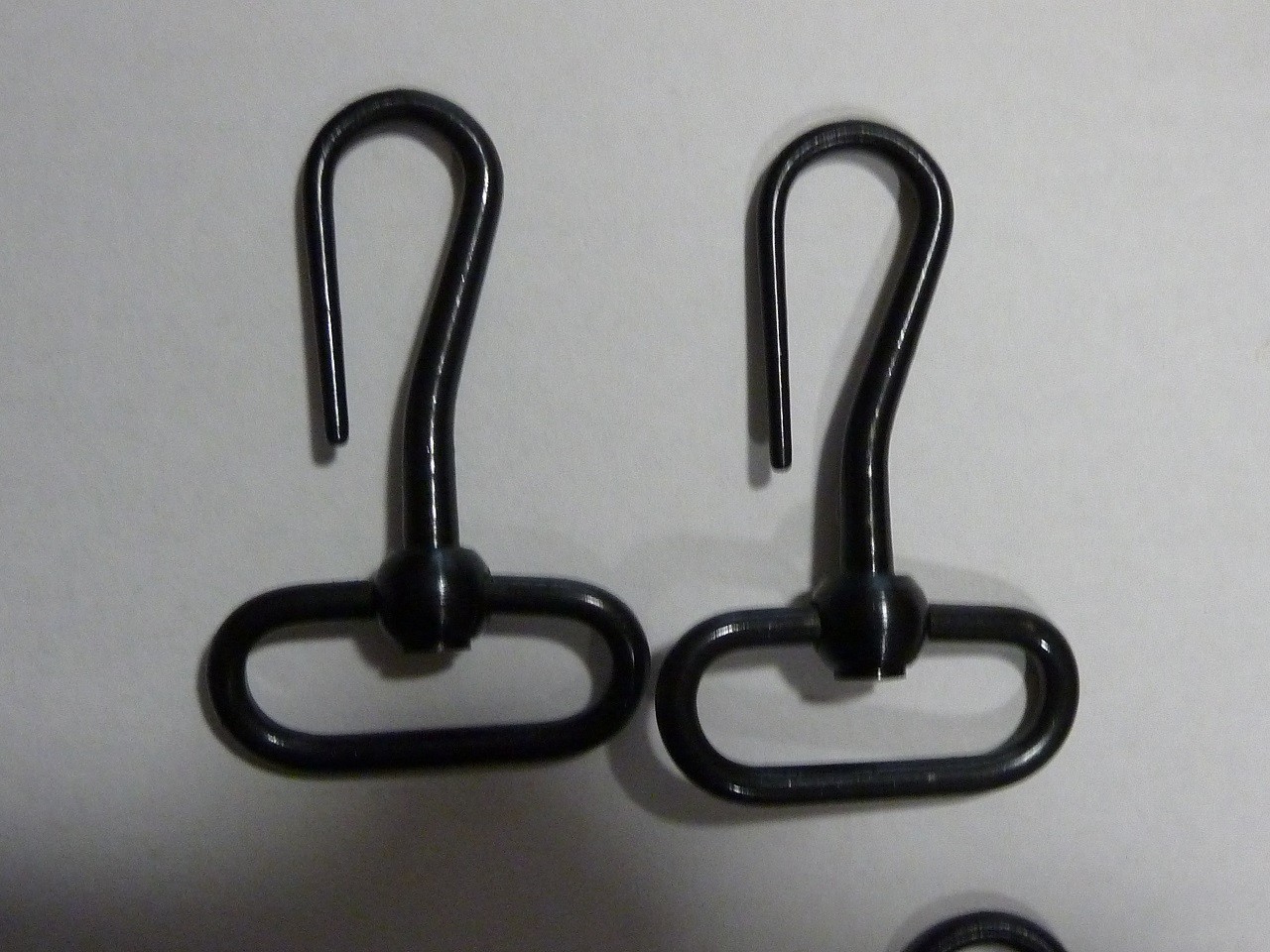

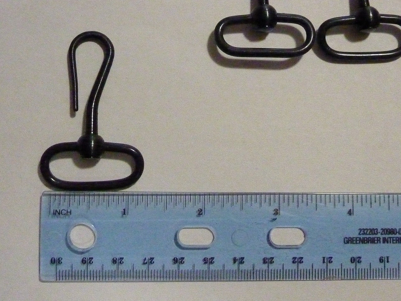

I agree with Clarence about opting for installing a set of original Winchester screw eyes. If you go that direction, I have a set of reproduction fish-hook style sling swivels I would sell to you cheap.  Asking $35 for the pair shipped.  Send me a PM if interested.
