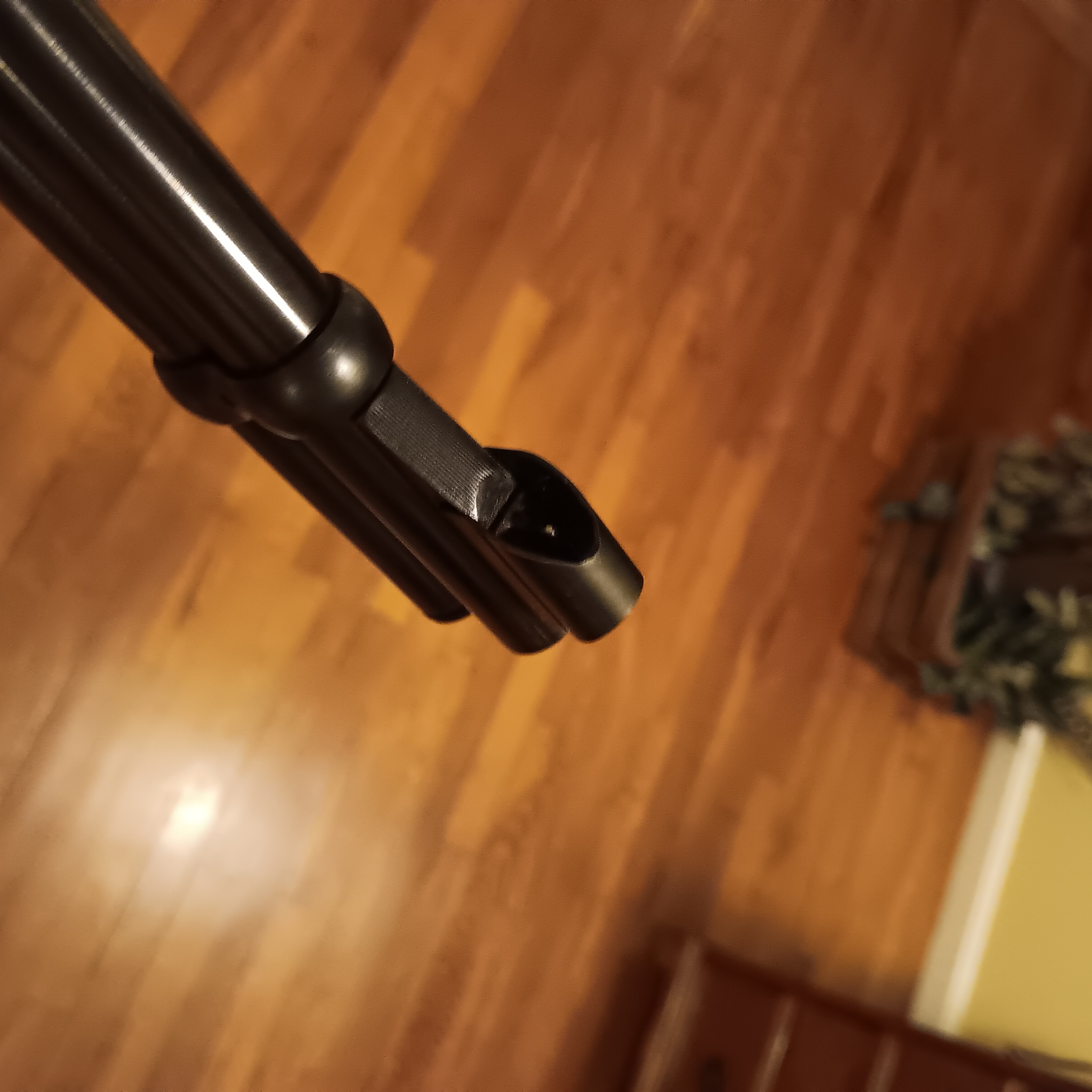

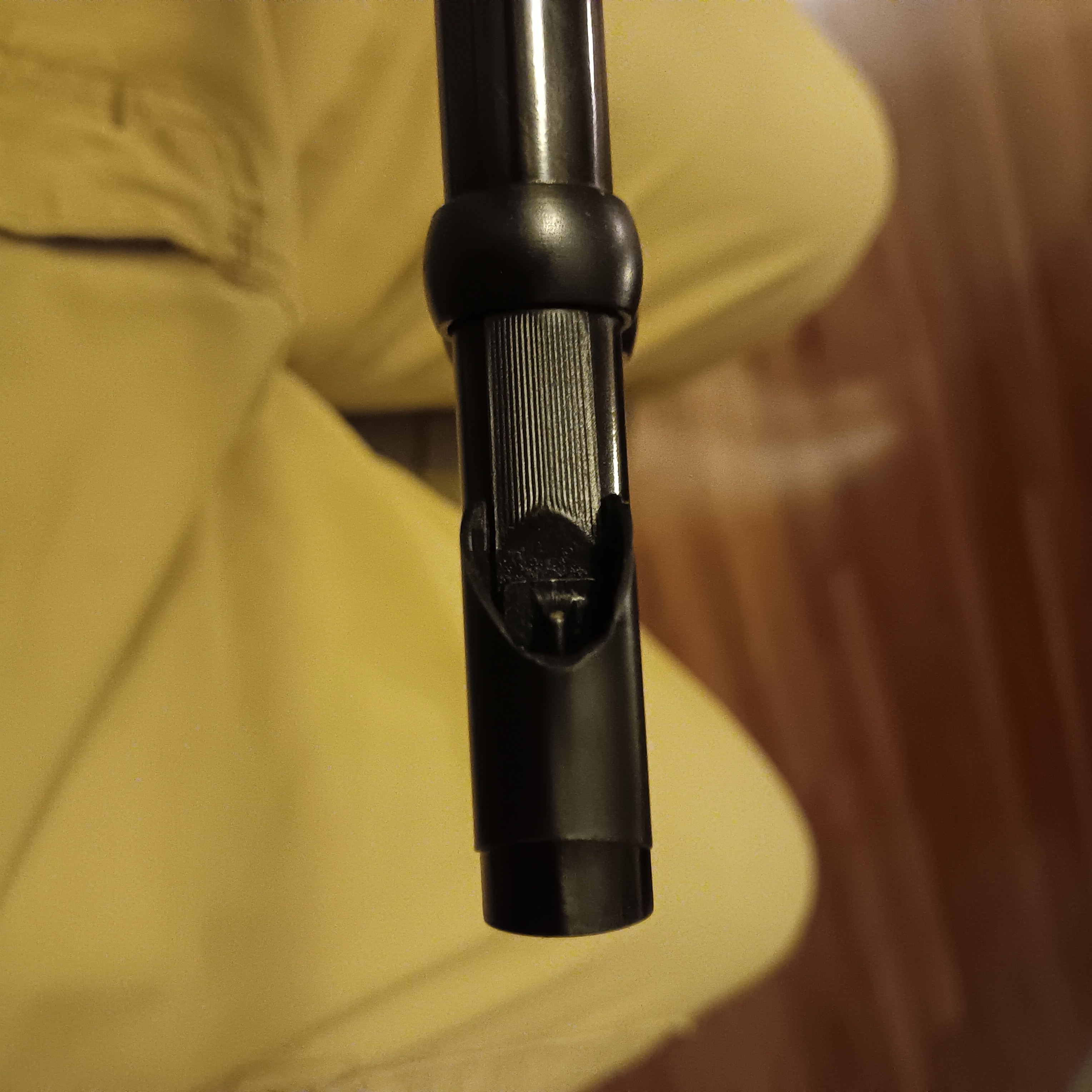

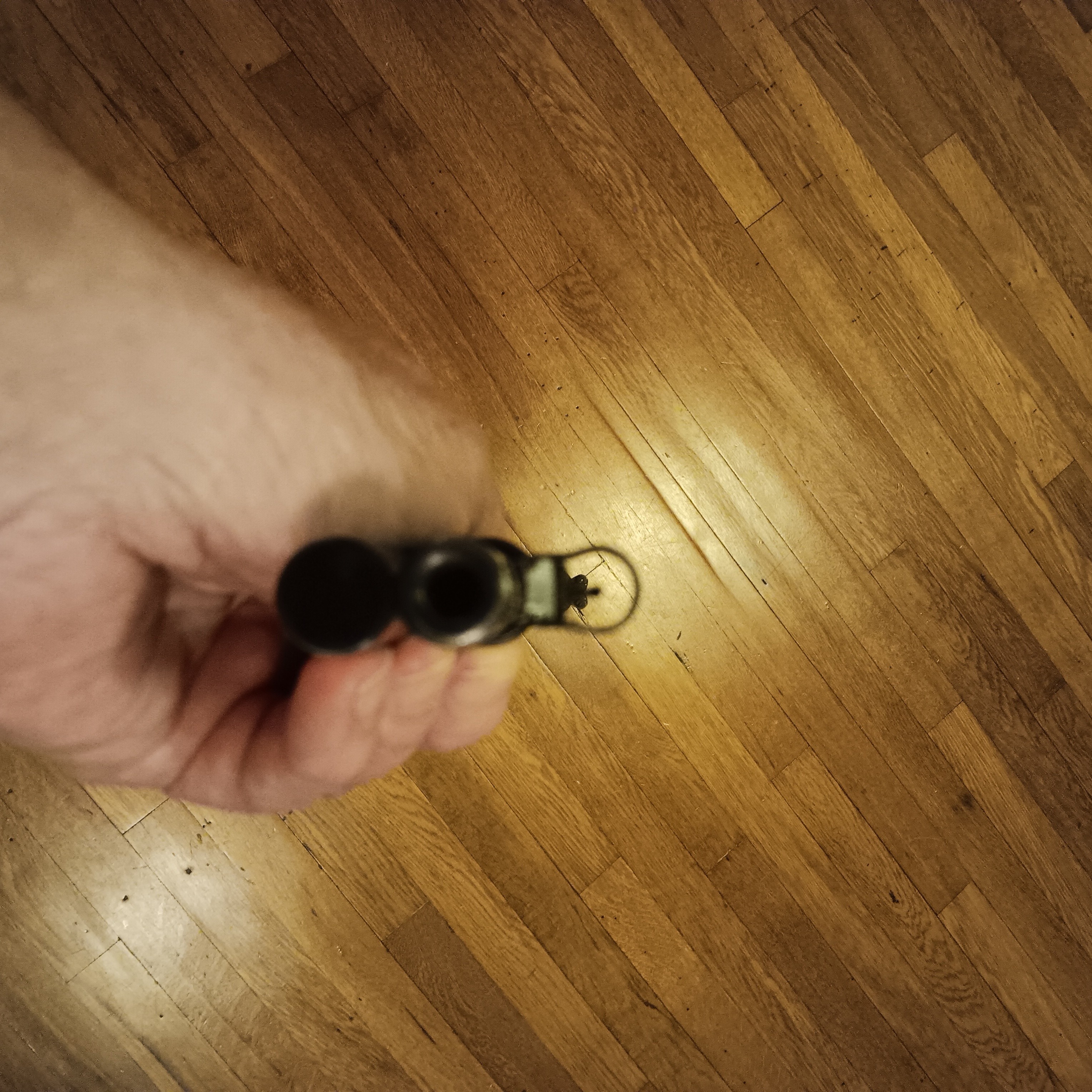

Need some advice from y’all. I ordered a “pre-64 top eject front sight cover, carbine, reproduction” from Numrich gun parts (product #294550C) for my 1977 Winchester 94. Came it today, installed it and it looks REALLY low and smaller than I expected. See photos. There’s very little clearance between the top of the front sight post and the hood, and just the overall sight picture now looks crowded.  Is this the correct size hood?  Is that little of clearance normal? I”m used to Marlin 336 “wide scan” sight hoods that have like triple the area in the sight picture.
hood
hood 2
hood 3

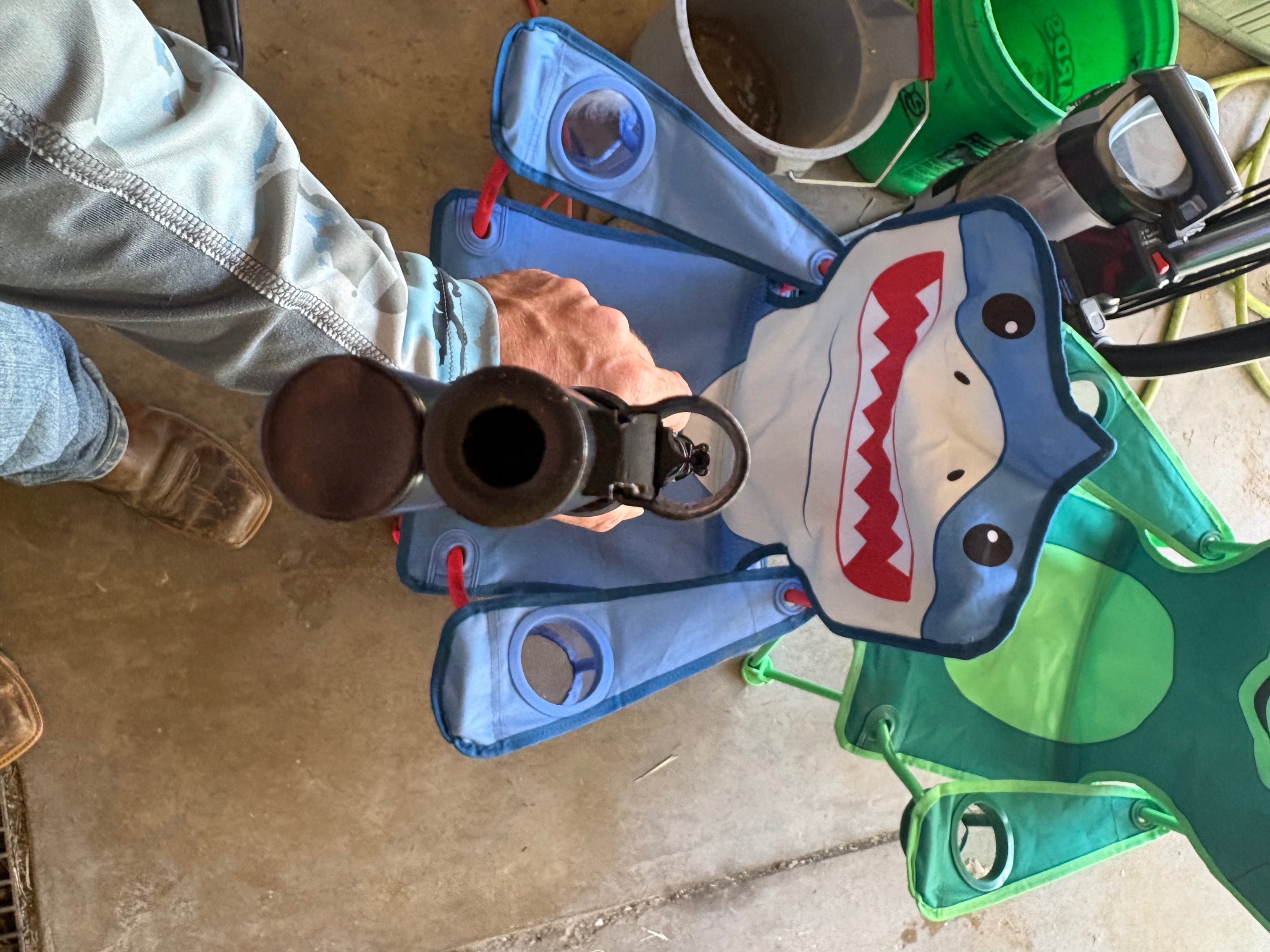

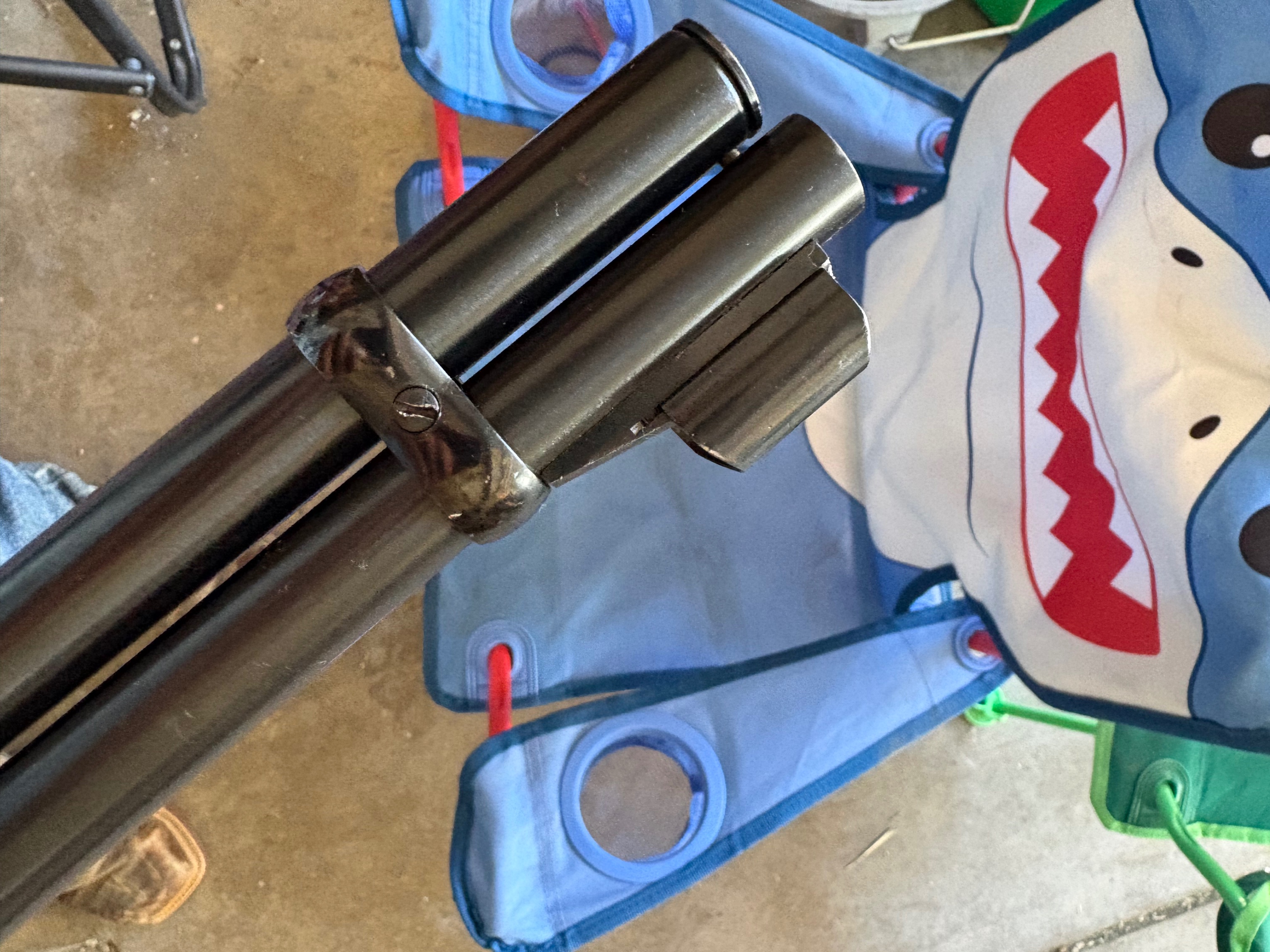

Here my post 64 sight hood.  You should have twice that much room

As Midwest Crisis says, what GPC sent you won’t work.  I have bought from them over the years and they are unreliable when it comes to what goes on what gun.
 I don’t know whether the post-63 Model 94 uses a different sight hood than the pre-64. The pre-64 used a Winchester #3276/L hood. Unless the ramps are really different in width, i would think one would fit either model.  Jack First carries a reproduction of this hood for 30 bucks.
However, it may be that the 1977 vintage Model 94 uses a taller front sight, in which case the older hood would not have enough air around it. In that instance, a reproduction of the #3278/M hood that the pre-64 Models 70, 71 and others used, would work. I believe Jack First sells a reproduction of that hood for the same 30 bucks.
So, you need some information.
1. Will a Pre-64 Winchester hood fit the ramp of a post-63 Model 94?
2. Is the front sight height of the 1977 Model 94 higher than the pre-64 version, or higher?
You really need to deal with parts or reproduction dealers who concentrate on the collector market, including Winchester.  Jack First is one. There are others. Don’t rely on eBay Descriptions. You need a parts dealer with knowledge.

From a practical standpoint that front sight won’t work with that hood, obviously. Do we know that front sight works with your rear sight and rifle? If it’s too tall that hood will work better with a shorter front sight. It looks a bit tall to me but my post-64 94’s have found homes elsewhere and I don’t know if the new owners ride mopeds.
Well, the rifle shot this group first time out two days ago at 50 yards using that front sight and the rear buckhorn adjusted two notches down. So I’d say it shoots well with that front sight. (top three shots were initial group, bottom seven shots were after I adjusted the rear sight to lower point of impact; front sight placed at bottom of black 8 ring)

Yeah, I didn’t have the hood on when I shot it.  The rifle was bought without a hood, I ordered that one from Numrich and as soon as I saw how it was too small I took off the hood.  Think I’m just going to keep it without a hood.
