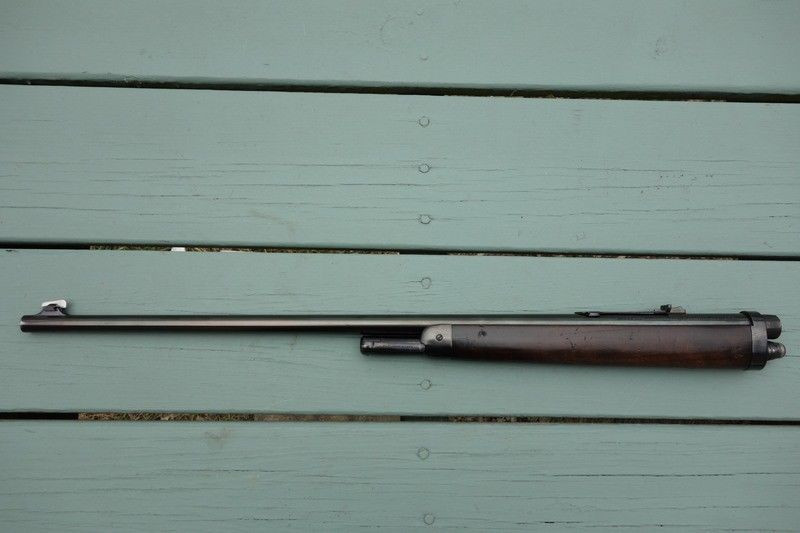

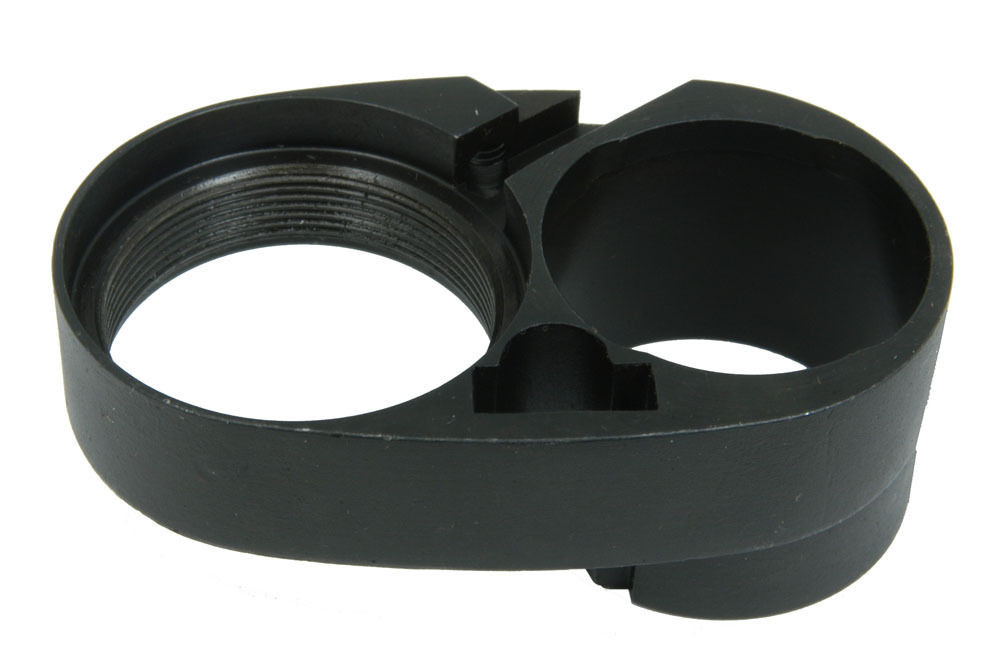

The Takedown Extension is screwed onto the barrel and has 3 headless screws which are used to adjust the tightness between the forearm assembly and the receiver.
The photo is for another model but gives you the idea:
