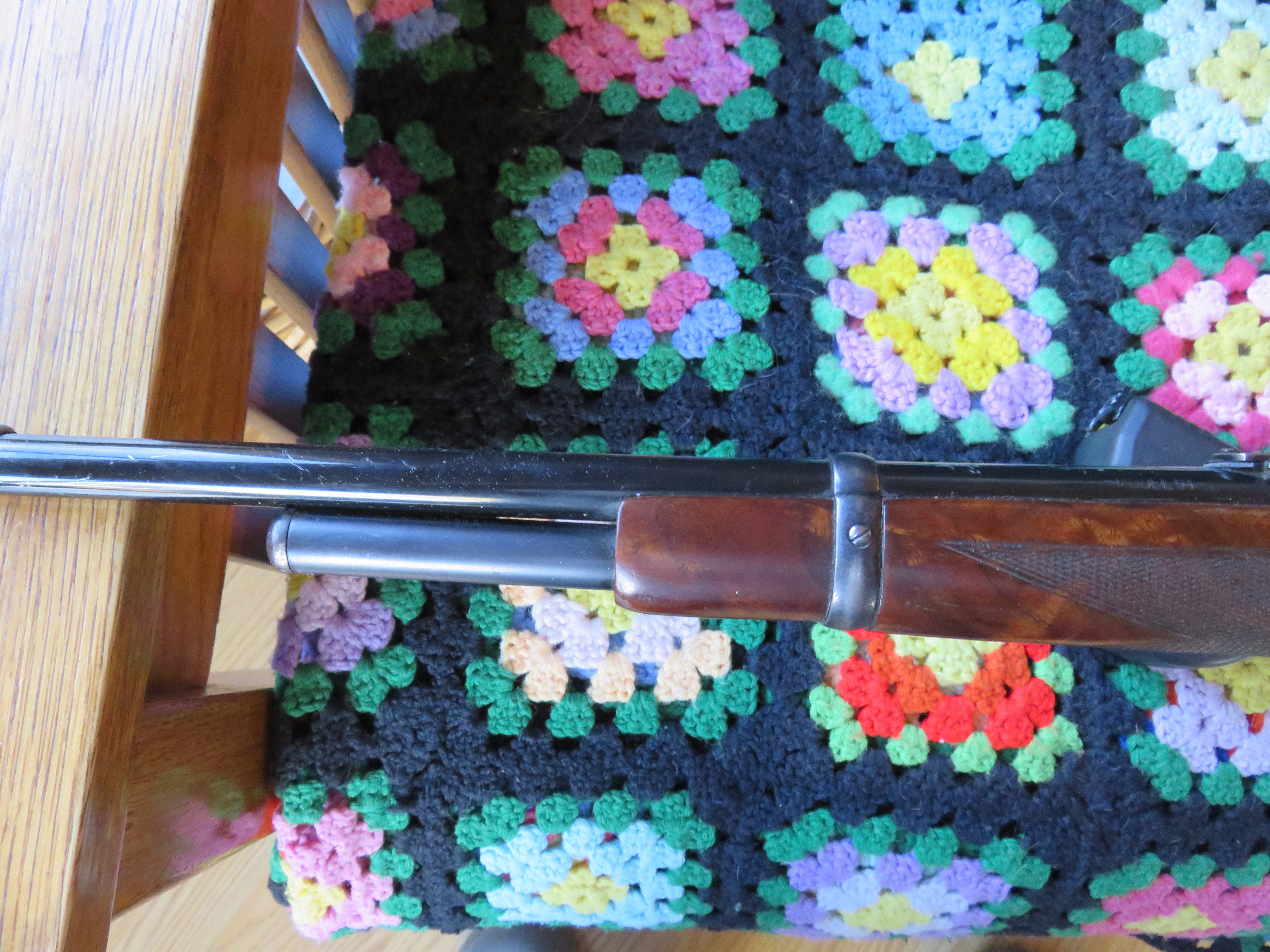

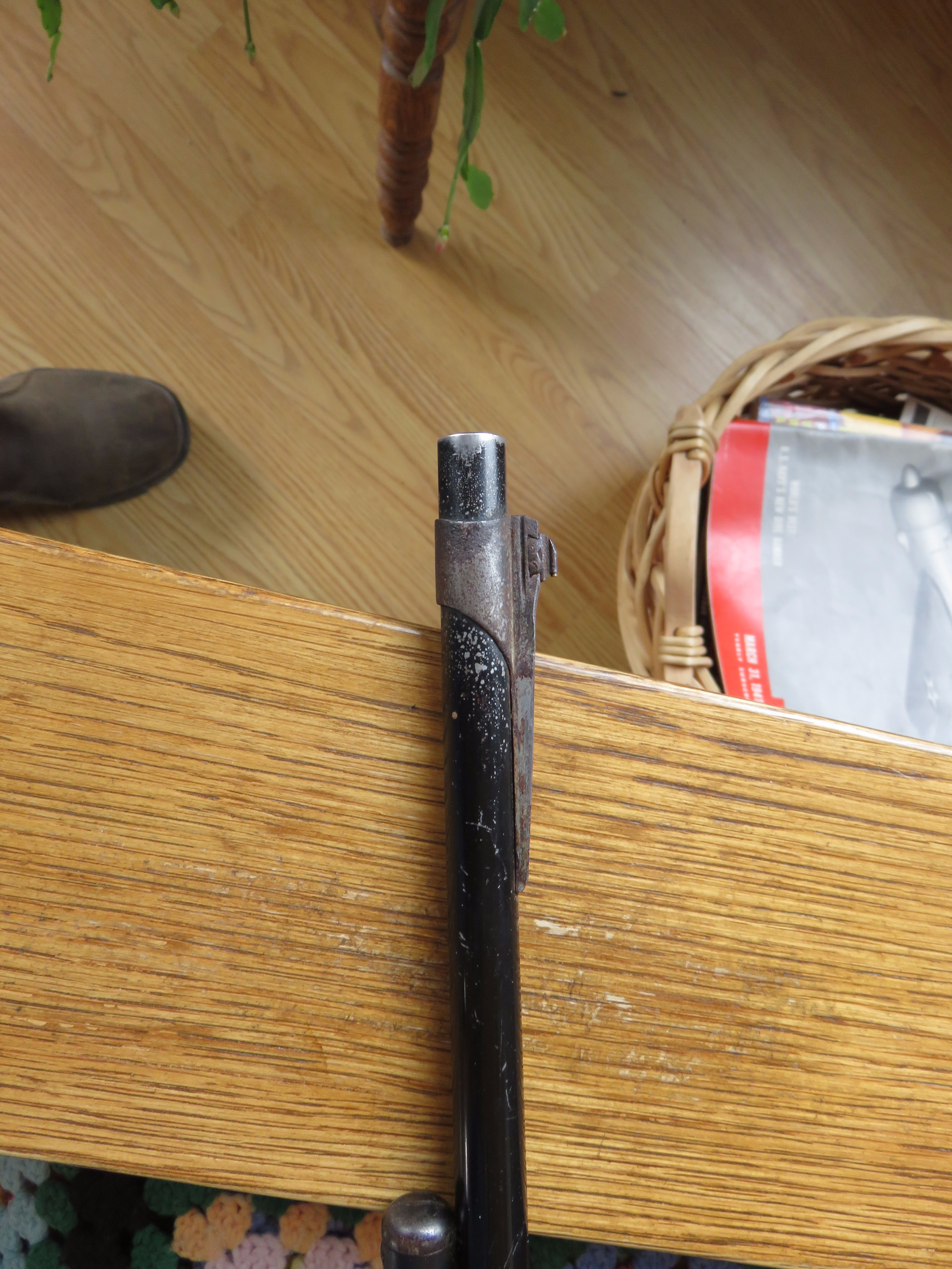

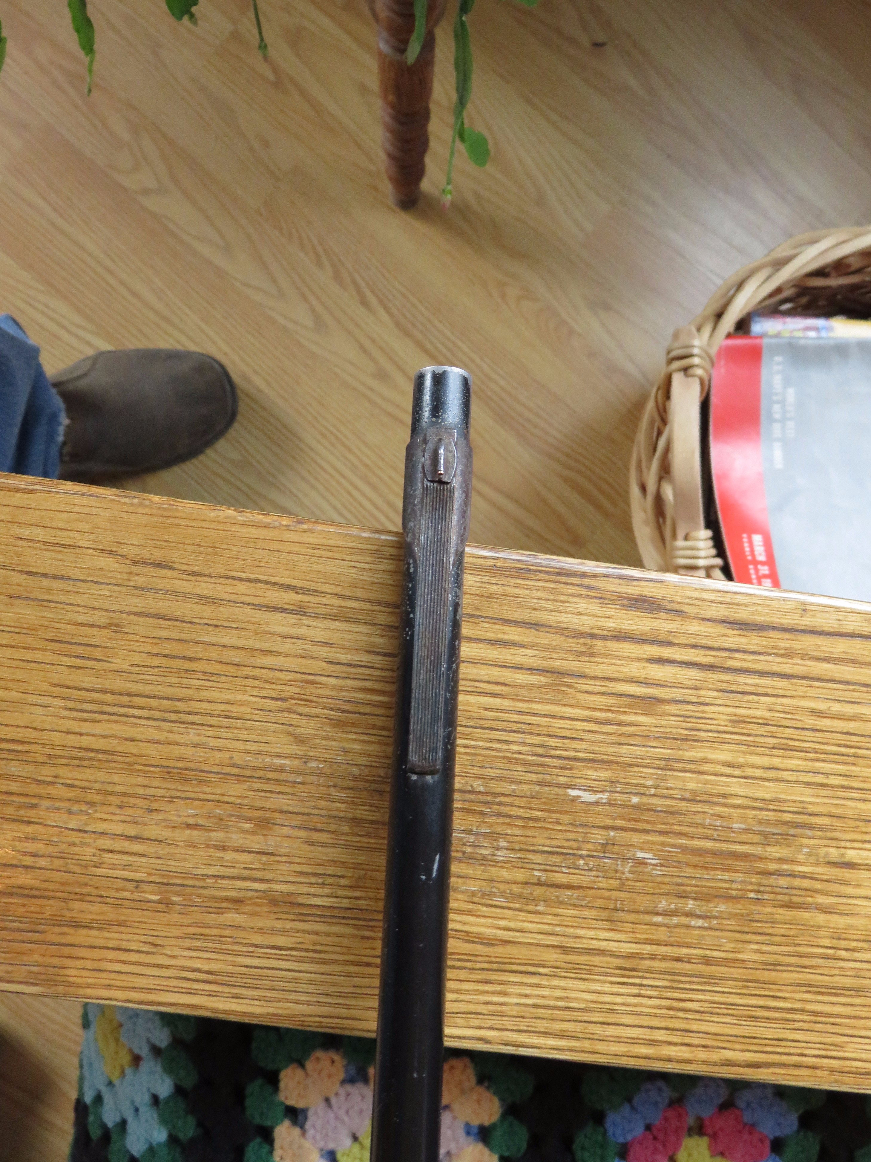

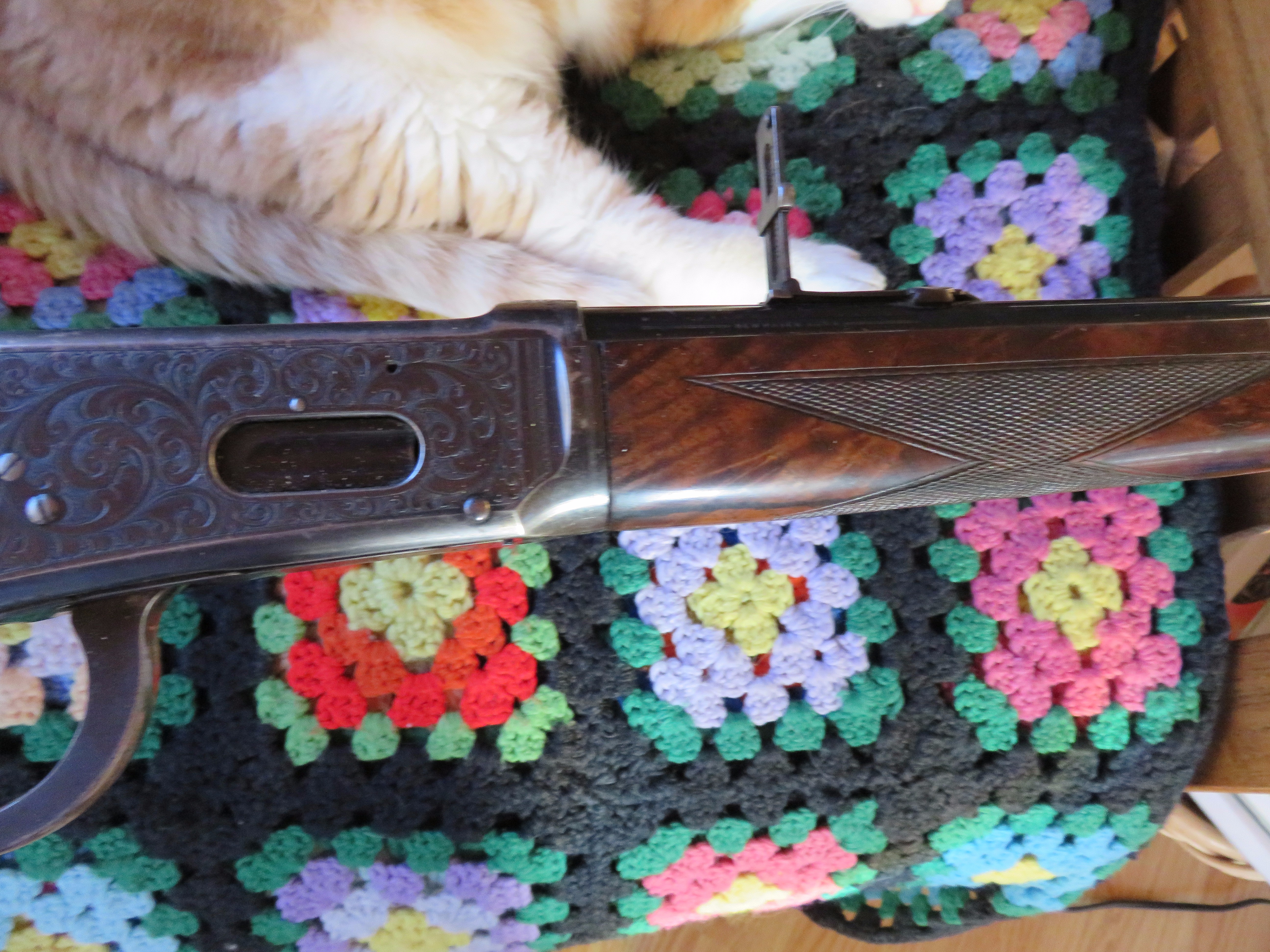

A friend gave me this deluxe wood and engraved 94 carbine (s/n 1011878) to find out if the front sight is original.
It sure doesn’t look right and somebody put a compass in the stock.
Can someone tell me if the front sight is a original.
Thanks
Bill
October 12, 2017 - 1:38 am

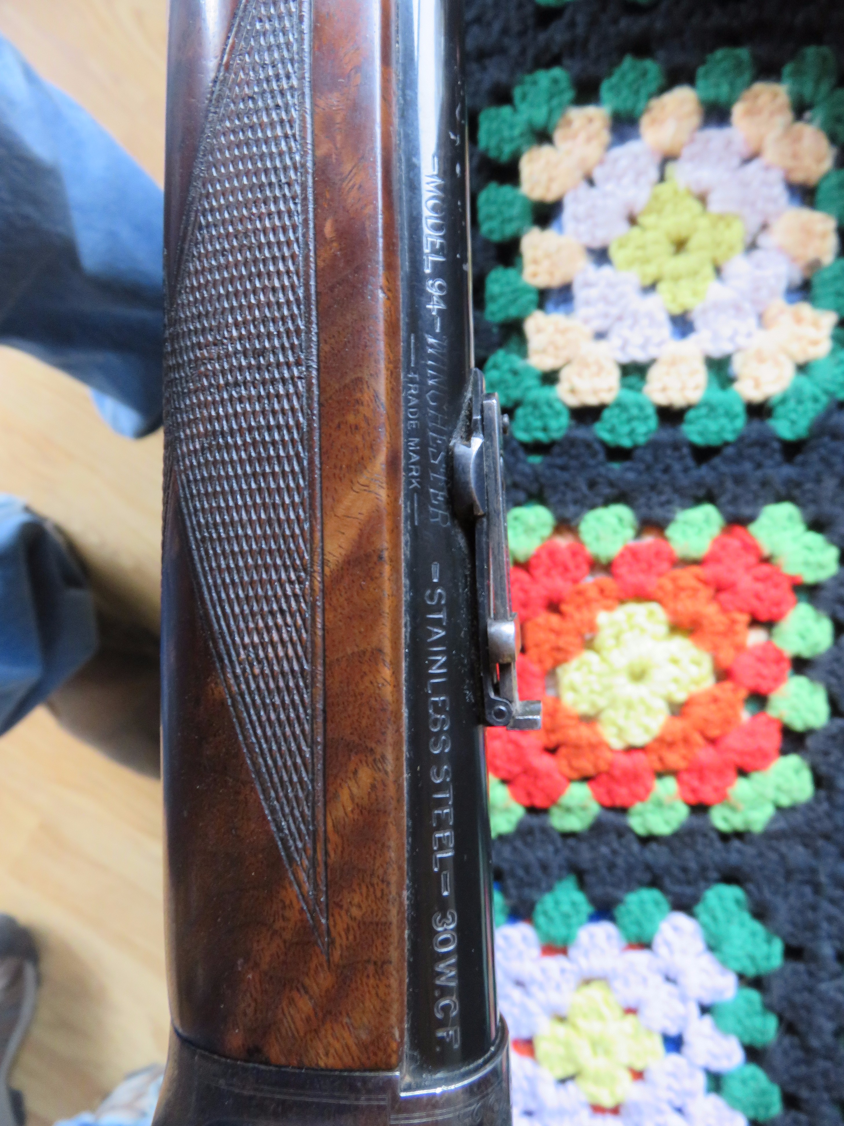

Most certainly not, but it has the rare stainless steel bbl. Well worth restoring.    Big Larry
Forum Posts: 14937
October 12, 2017 - 5:12 am
Bill,
The front sight is absolutely not factory original.  How long is the barrel?  Is it a saddle ring carbine?

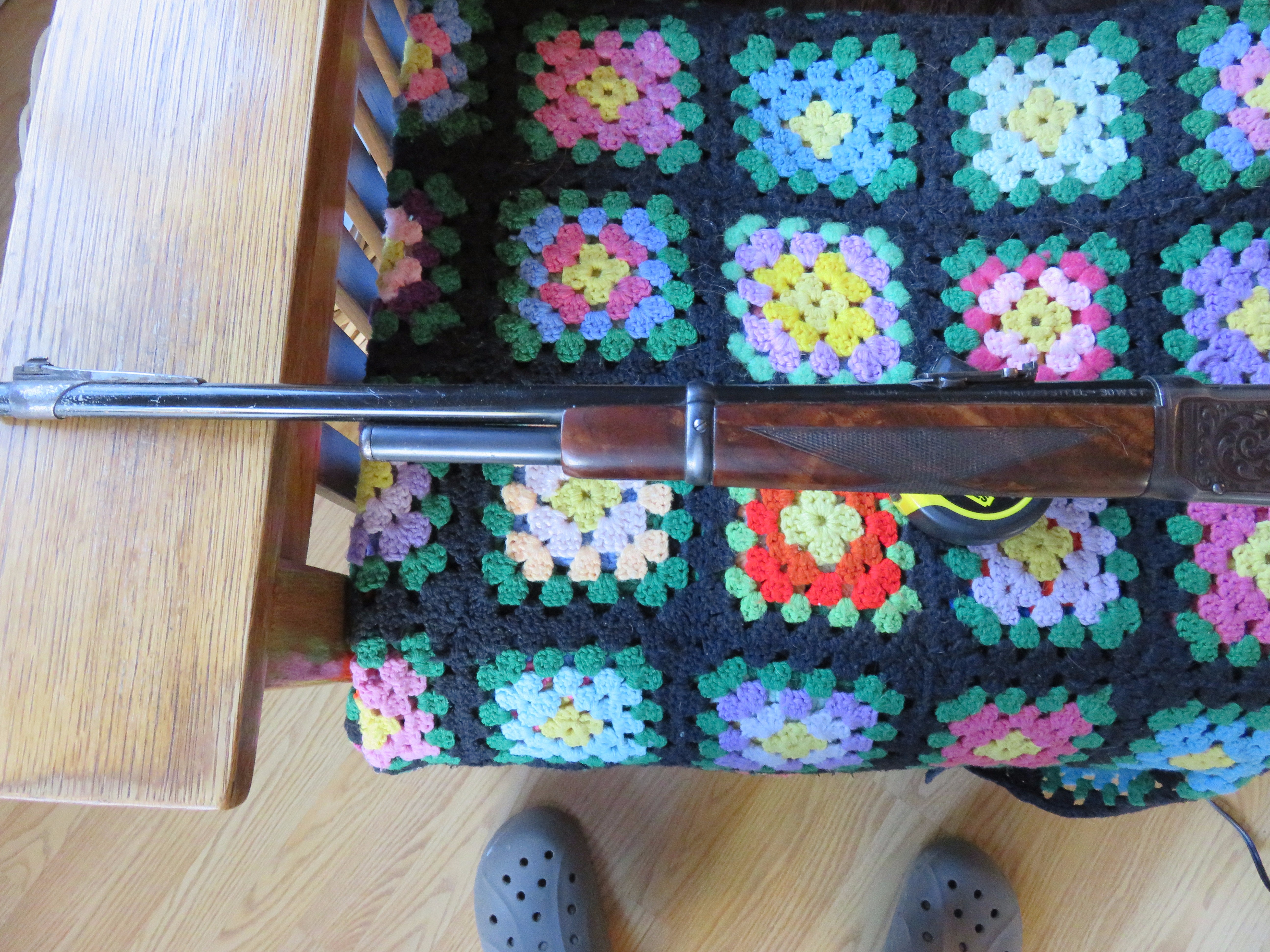

October 12, 2017 - 2:47 pm

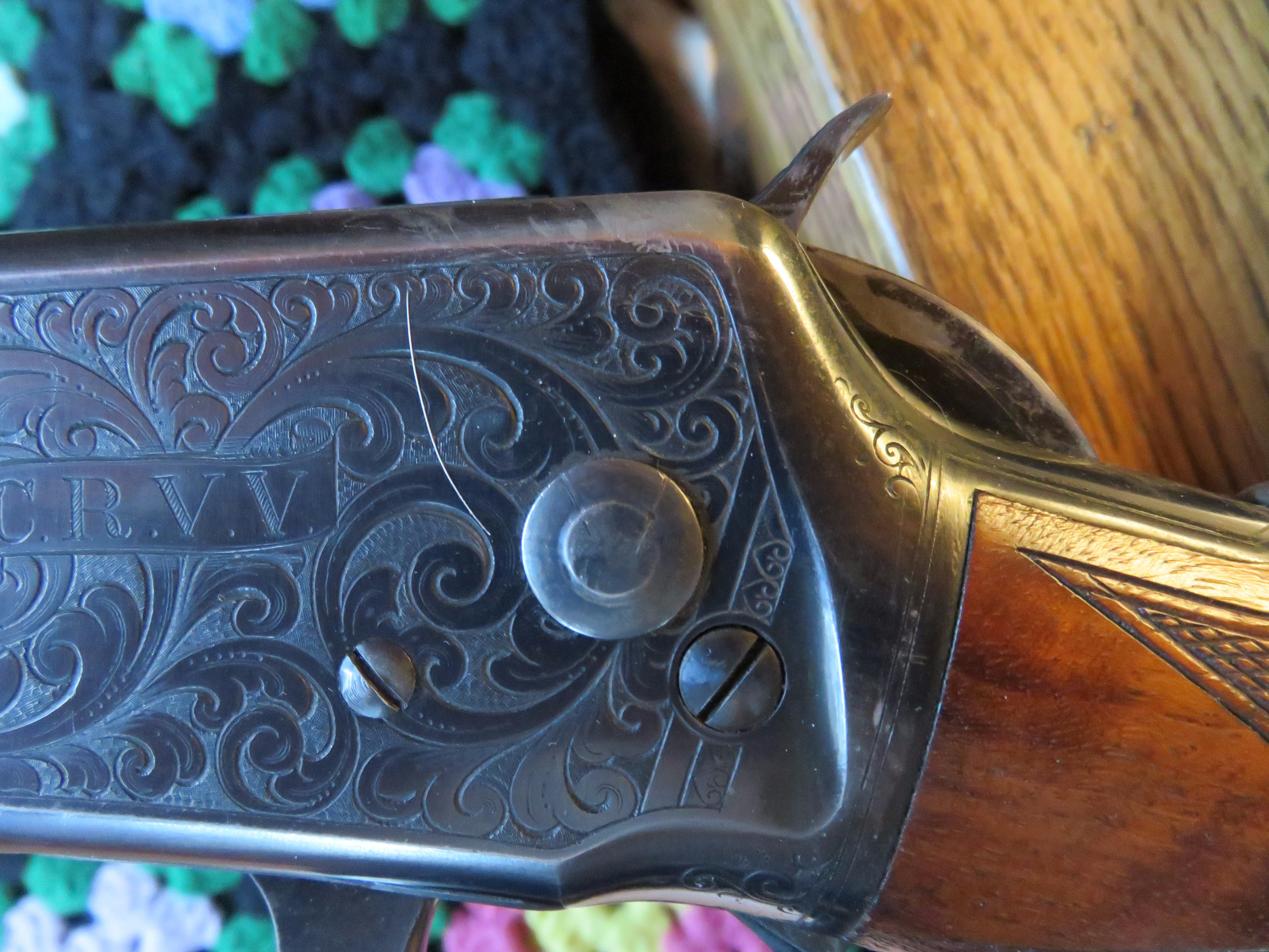

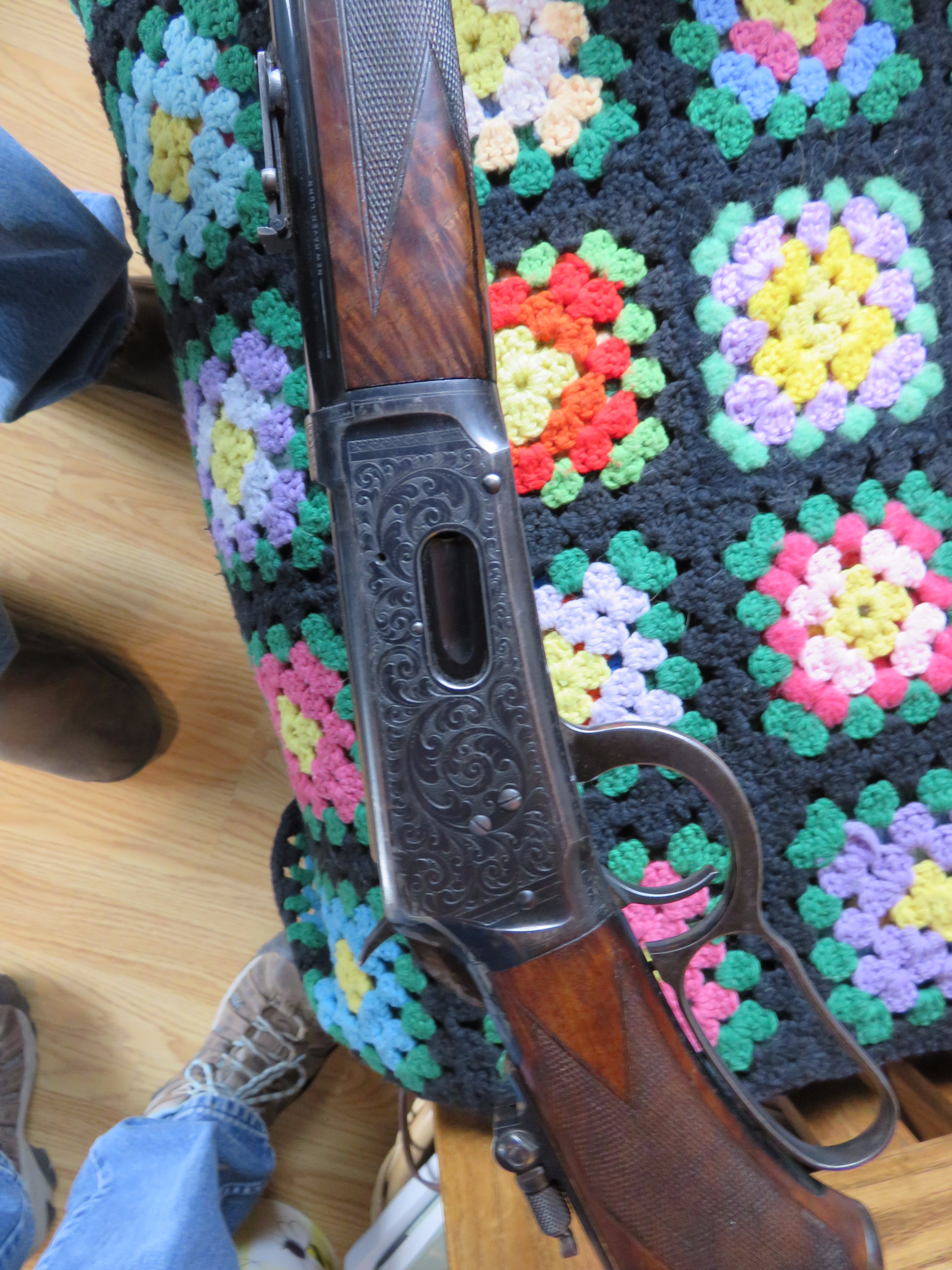

Bert, there is no saddle ring, and the barrel is 19 inches.
It’s a shame that someone treat a nice carbine like this.
The same fellow has the 94 rifle that I asked about being a 94 trapper, someone cut the barrel off, this fellow didn’t do of this
He inherited them.
Thanks Again
Bill
Forum Posts: 14937
October 12, 2017 - 4:21 pm
Bill,

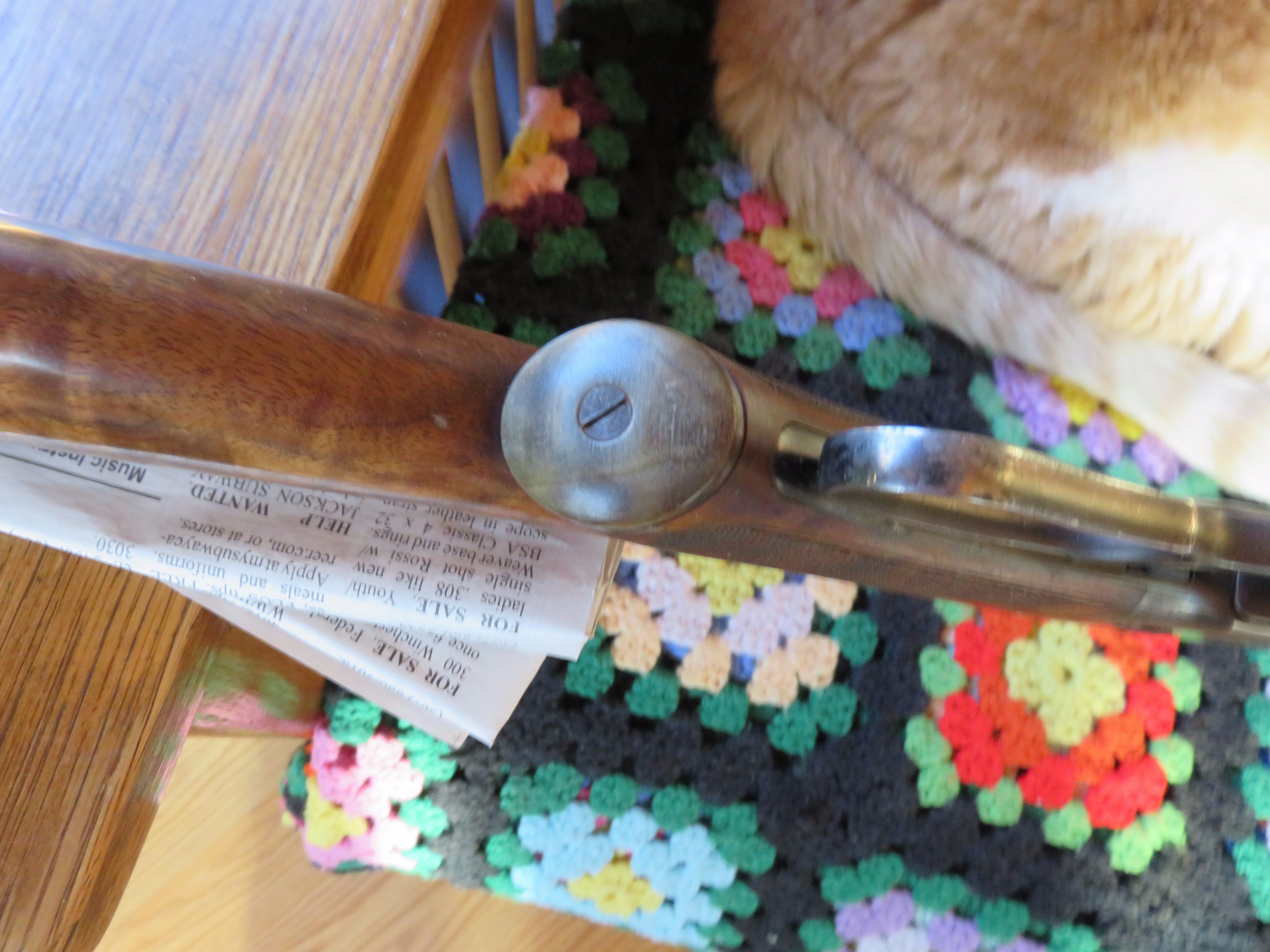

Actually, there was a saddle ring, but it has been ground down to almost nothing.  Can you post pictures showing the pistol grip cap, and the butt plate.  I am trying to determine how much of the gun is factory original.

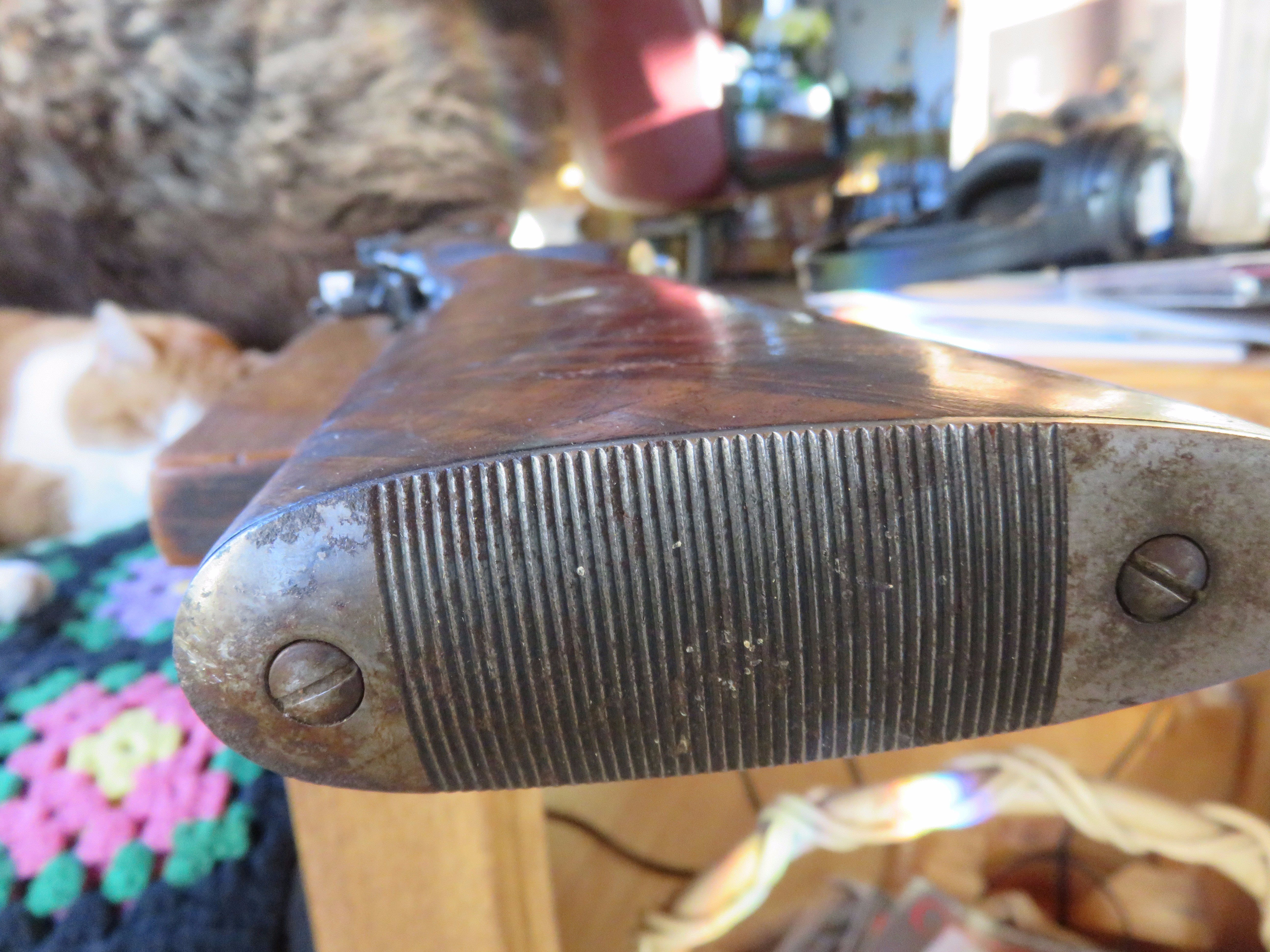

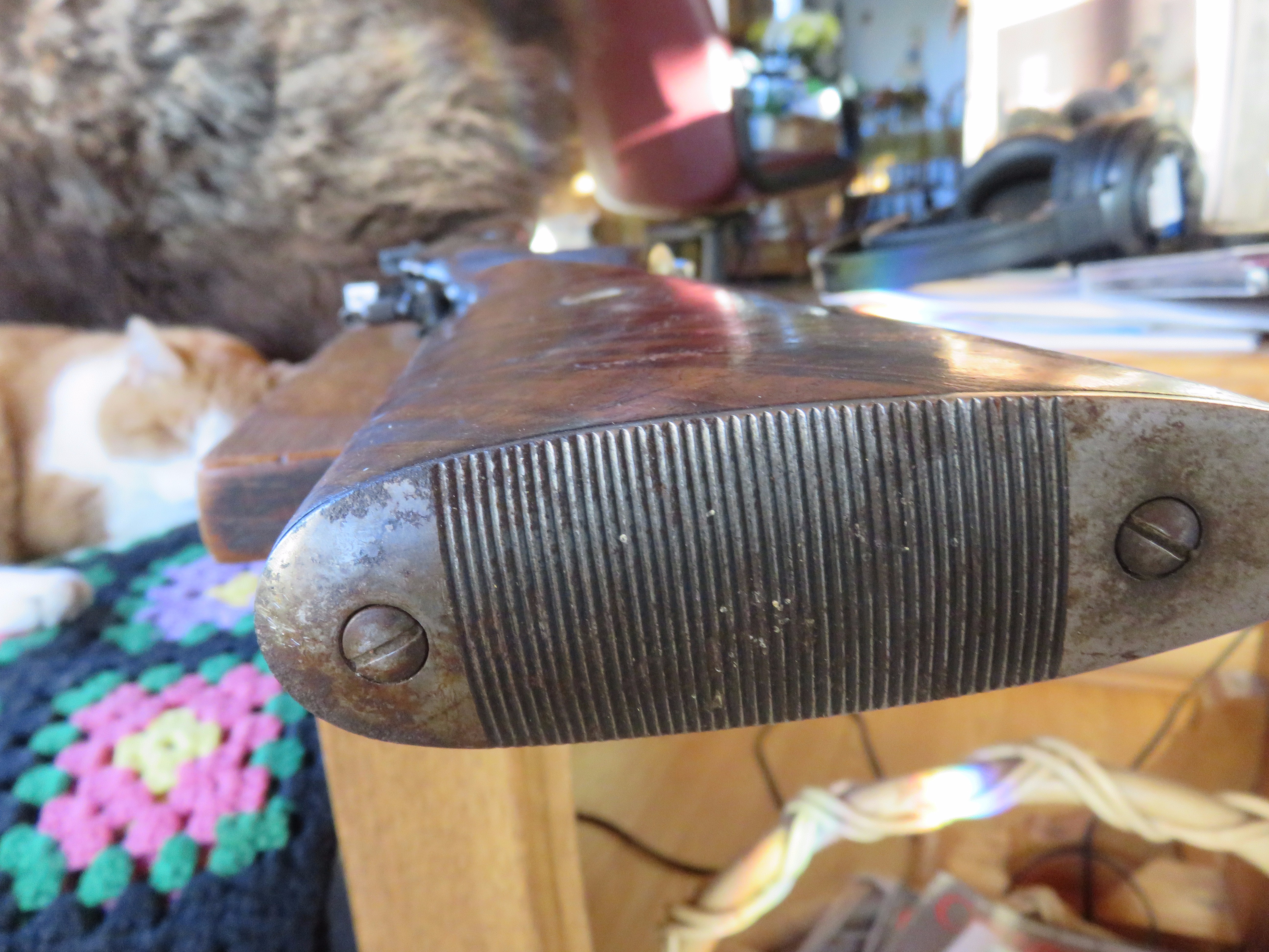

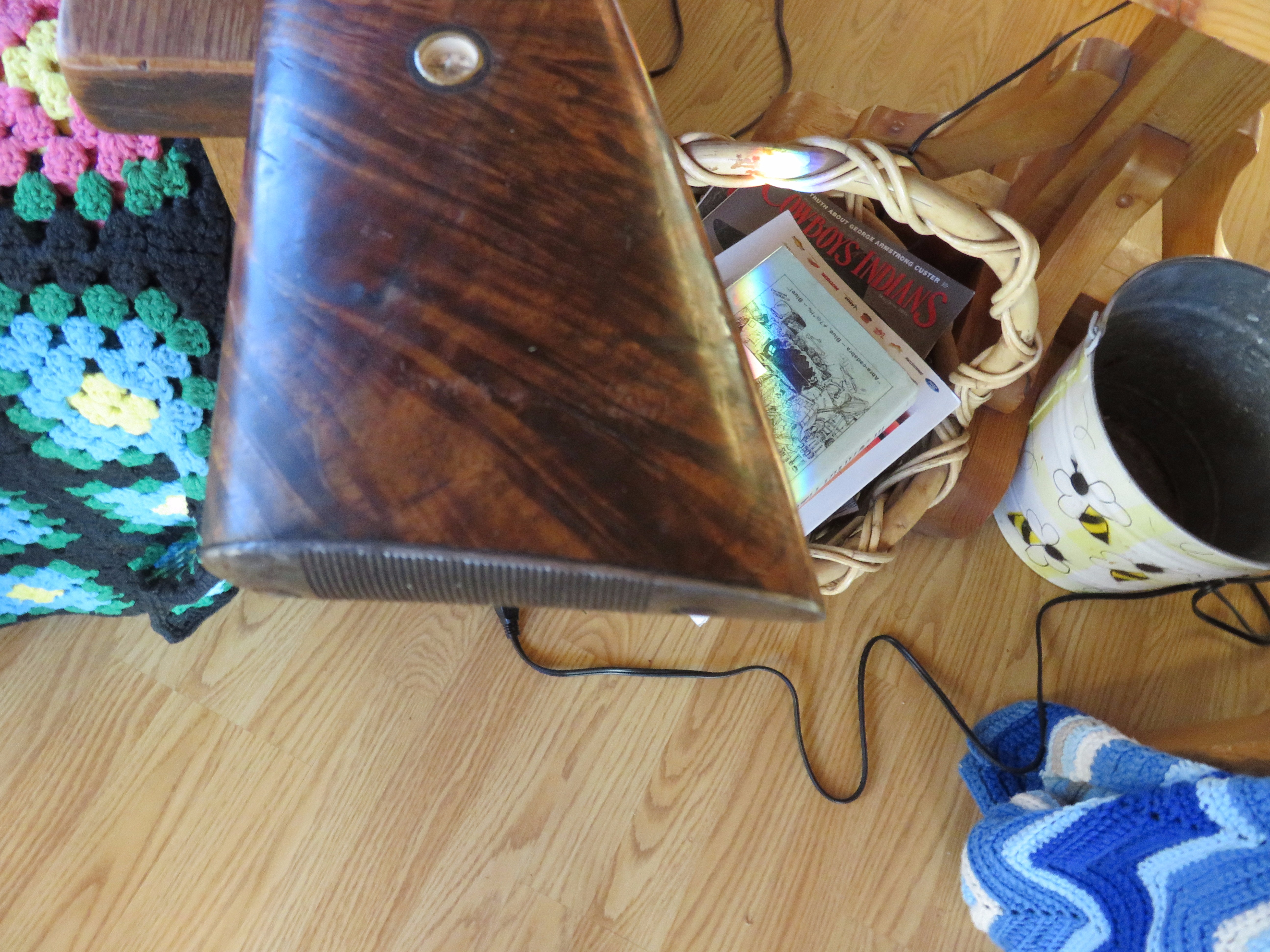

October 13, 2017 - 12:16 am

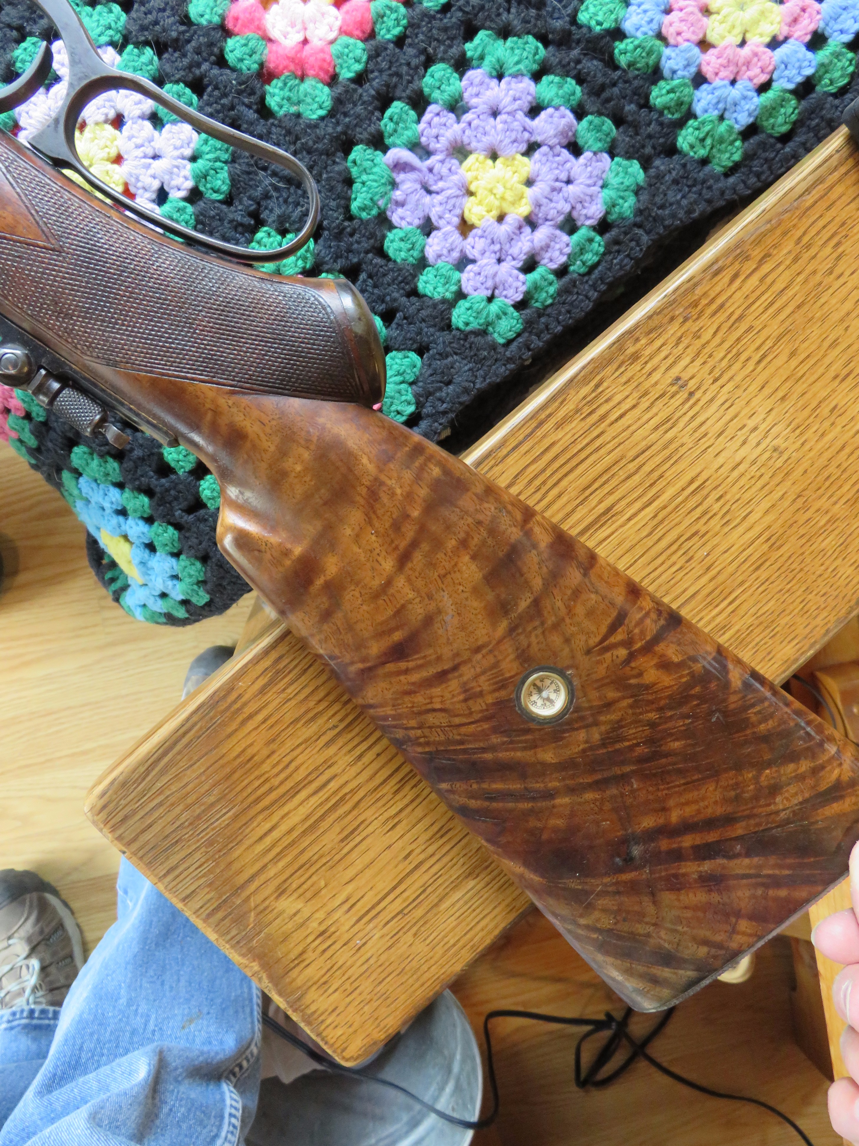

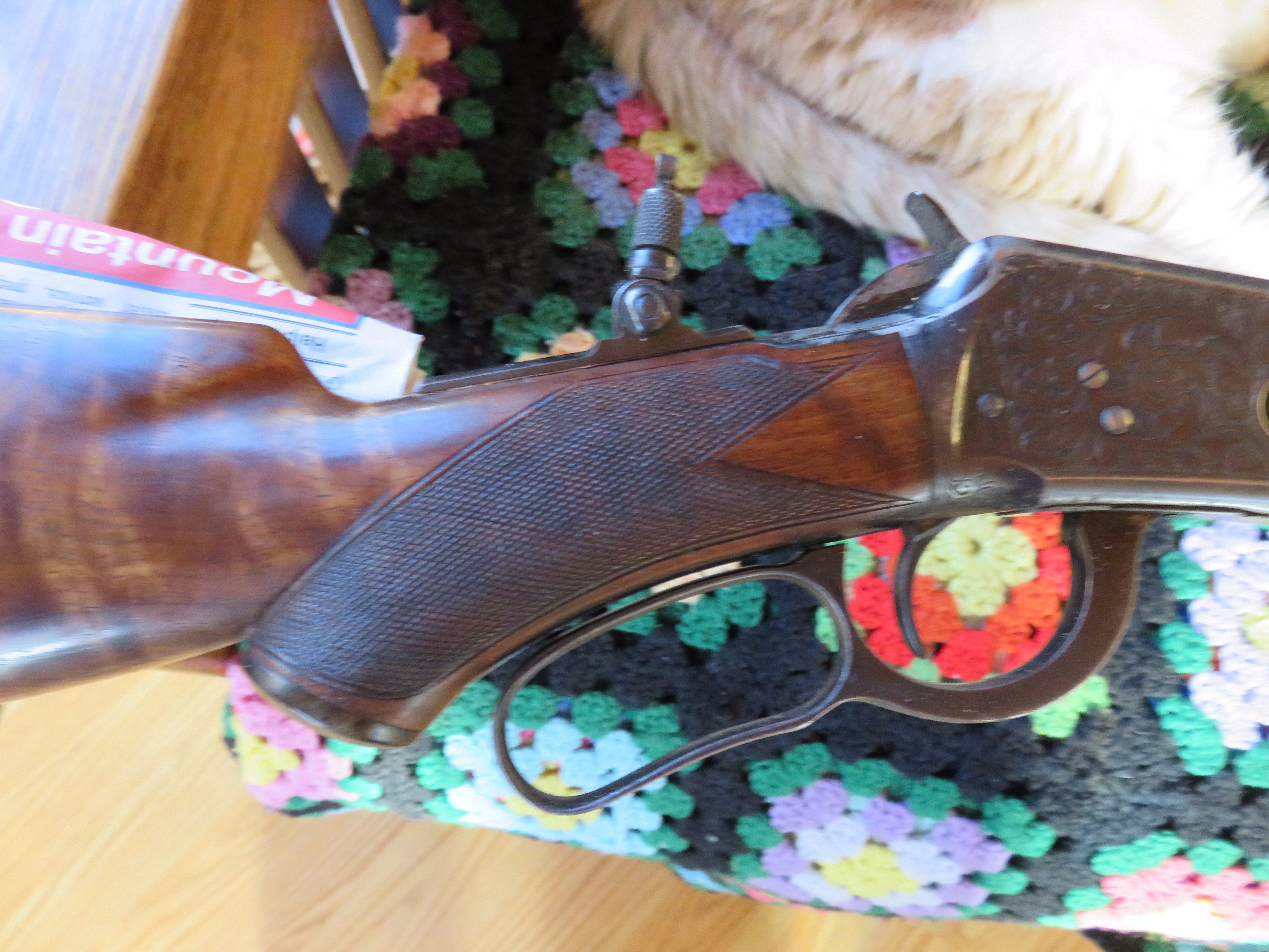

Bert, here the photos you ask for,the not great,if you want different ones I will get them.
It doesn’t have the normal steel butt plate and the carbine is a 30-30.
Bill
Forum Posts: 14937
October 13, 2017 - 2:14 am
Hmmm… the grip cap is not Winchester original, but the butt plate is.  The wood appears to fit very good, but that can be easily accomplished by a talented stock maker/fitter.

October 13, 2017 - 1:44 pm
Bert, I will see if I can find some history on the carbine. Someone put the compass in the stock,maybe he did the grip cap.

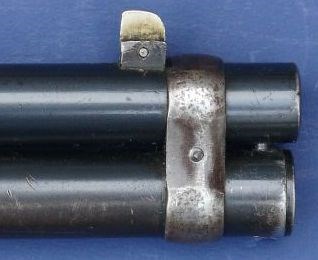

October 26, 2017 - 12:32 am
Bert what will be the correct front sight for this 94 carbine
Thanks
Bill
Forum Posts: 14937
October 26, 2017 - 4:45 pm
Thanks
Bill
Bill,
It should have the same sight that 99%+ of the standard Model 1894 SRCs have.  A small rectangular steel block pinned and silver soldered to the barrel, with a pinned blade.
