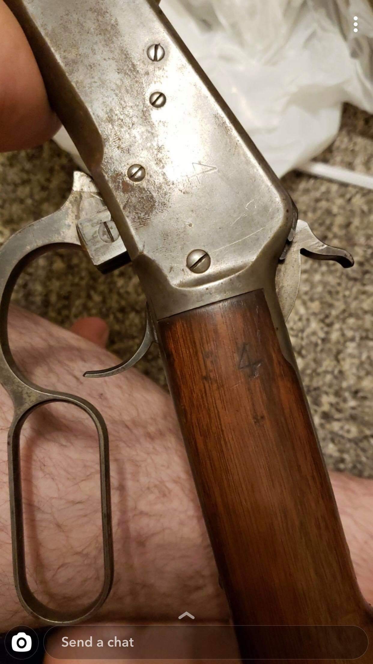

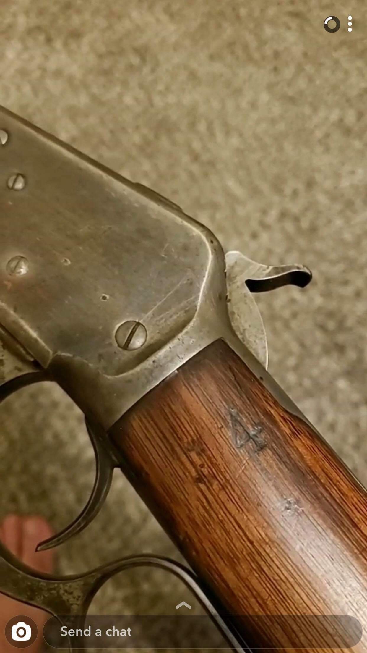

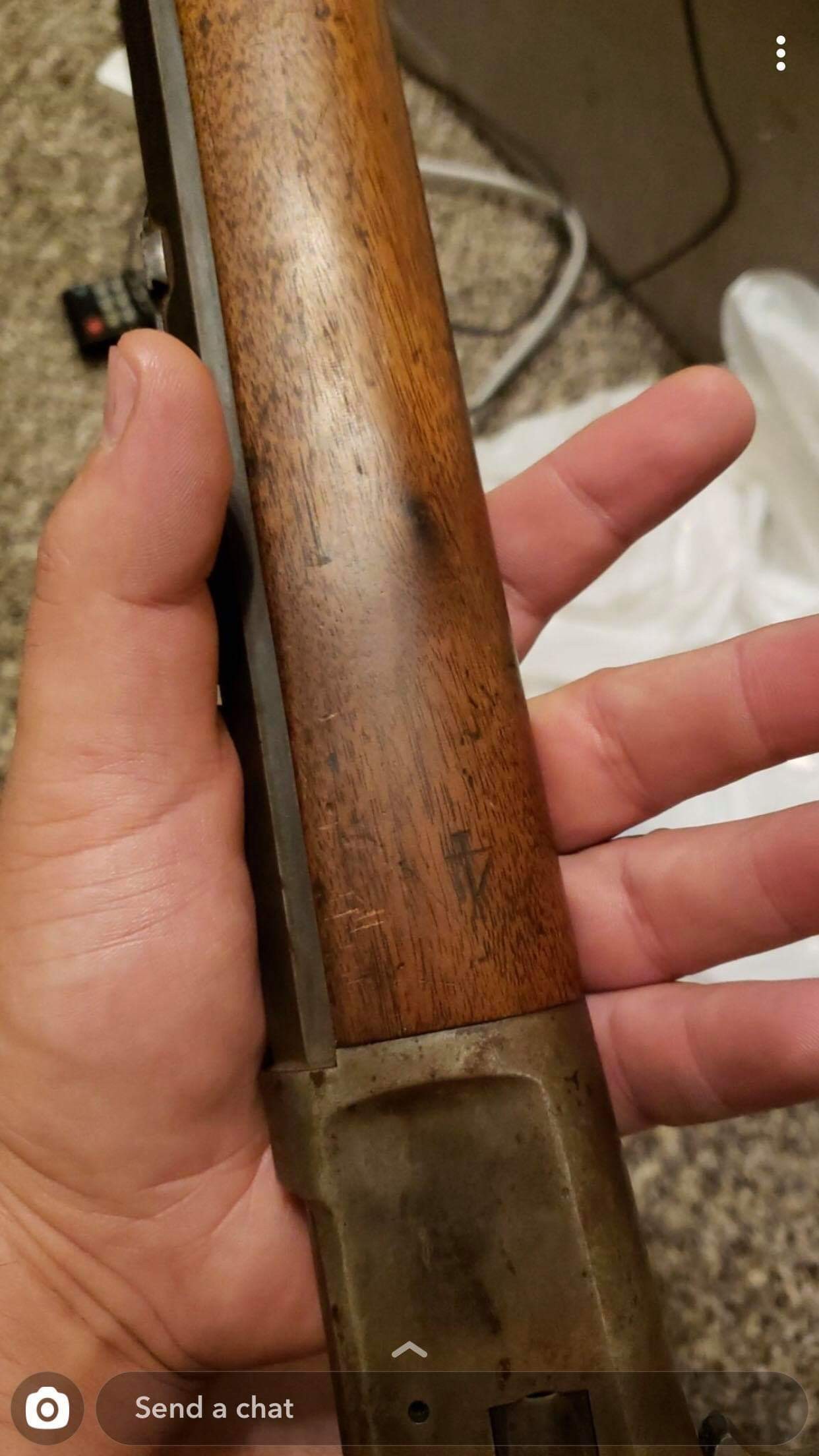

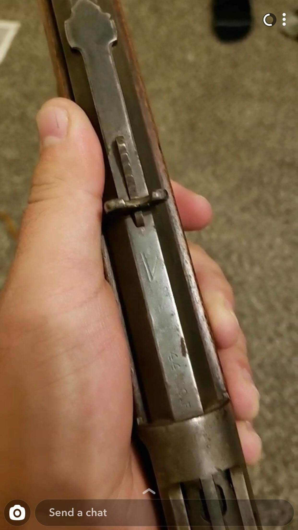

Posting for a friend who has a first year 1892 standard oct brl rifle in 44wcf. There is a number 4 stamped on both sides of forearm near receiver, on top of barrel in front of receiver, rear side of receiver and on the side of the stock. Any thoughts from the gallery?received_3016715251696513.jpegreceived_492862614665340.jpegreceived_486496615557209.jpegreceived_2430246390636861.jpeg

Hello Mark,
I have looked at more than 13,000 Model 1892 rifles and have not seen similar marks to those.  They are most likely “rack marks” which were applied when an entity had numerous identical rifles and wanted to easily identify one from another.  Can I get the ful lSN of the gun so that  Ican add it into my survey of the 1892’s?

Michael,
Thanks for the reply. Rack number was my thought but odd marked on all major parts. Serial is 19298.
Mark
Forum Posts: 2755
December 9, 2019 - 8:34 pm
Mark,
One would have to assume that the rifle was marked repeatedly so that when disassembled the parts would be put back together into the same rifle.  Thus, the entity who marked it had at lest 4 of them.  Is there a small set screw on the right side of the front sight base?  Can you please post pics of the tang stamp and the barrel address?
