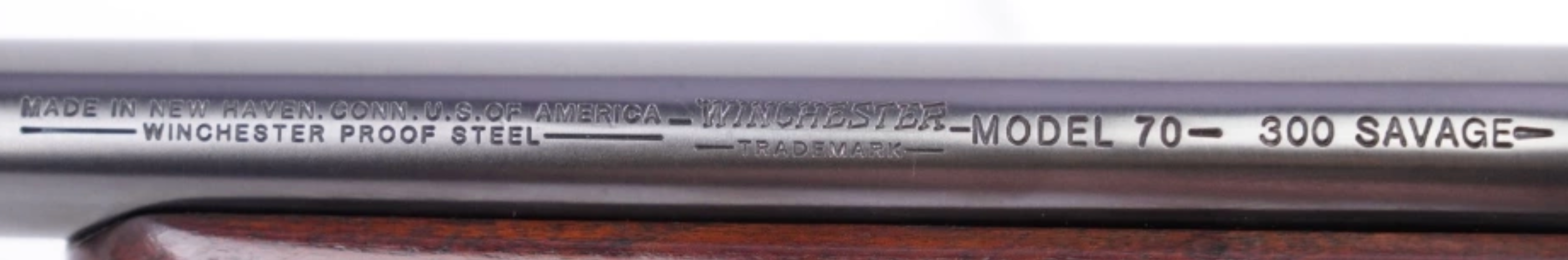

Before I go putting marks on the bottom of a barrel indicating that the Robert was a fake, I would certainly want to have some good answers on more than just two examples of a possible fake. Just my thoughts.

You are certainly right that there is more than one way to detect whether a “Winchester” barrel is factory or not.
The rifling is an important one, as many manufacturers of reproduction barrels start from commercial barrel blanks that were rifled using different processes than Winchester used before 1964.  Likewise, people creating barrels in oddball chamberings by reboring/rifling an original barrel, e.g. 358 WIN Featherweight from 308 WIN Featherweight, 308 WIN or 358 WIN Standard from 243 WIN Standard, 35 WHELEN from 30 GOV’T’06, etc. tend to rifle their rebored barrels using non-factory processes.  The number of lands/grooves and rates of twist used by Winchester are known from existing documents and are usually correct on reproduction barrels, but the borescope is your friend for comparing cut versus button rifling, tool marks, etc.
Front ramps (when present) are also important to examine.  Making a 20″ Carbine barrel from a 24″ or 26″ Standard barrel, e.g. Carbines in 220 SWIFT or 300 MAGNUM, requires “moving” what was an integral front sight ramp.  Not easily done to perfection as the weld seam tends to show flaws under high magnification.  Sometimes the stippling on top of an integral (or later silver brazed) ramp is a poor imitation of factory work.
There has been enough discussion of proof marks to not be worth belaboring.  Barrel and receiver proofs were applied at the same time by the same worker at the same bench after proof testing a finished rifle.  In general they should match.  Non-matching proofs, while not necessarily an indication of a fake barrel, at least suggest a barrel swap.
Still, I find that the roll marks are often the quickest/easiest way to raise doubts about the authenticity of a barrel on a Model 70.  IIRC, during the prewar period the roll dies and caliber stamps (which were separate on the M70 before 1950) were made in-house and usually cleaned up by hand by factory engravers.  Hence there is some variability, but still aspects that are common to all genuine dies, like square corners on at least some of the letters/dashes, die wear notwithstanding. OTOH… Some makers of reproduction barrels mark their barrels using what looks like laser engraving or rotating bit pantograph.  These techniques cannot make square corners.  Everything is rounded.  For example…
In 1950, Winchester adopted the “one-piece” dies that included caliber along with the barrel address.  These dies were commercially outsourced, e.g. made by Nobel and Westbrook or Industrial, and are generally quite consistent.  Moreover, the caliber stamp made by these dies should be perfectly aligned with the rest of the marking since it was on the rim of the same disc.  If the caliber stamp was applied separately (even if made to look like it was integral), then questions arise in my mind at least.
And yes… Winchester “should” have made one-piece Standard (not Featherweight) dies in 308 WIN because they specifically cataloged Target Models and National Match rifles in 308 WIN for a brief time in the early 1950s as available on special order.  Maybe not some of the others, e.g. 300 WIN MAGNUM Featherweights (of which a couple genuine ones exist), but it bears looking at…
I’m not saying that making a reproduction Winchester barrel is criminal.  Look at Mark Douglas’ video posted yesterday in which he examines a repro barrel made by Winchesterbarrels.com.  The unscrupulous act occurs when one of these non-factory barrels is used to build a “rare uncataloged” rifle that is represented for sale as genuine.
Just my take…
EDIT/ADDENDUM:  I have chosen to delete two images of barrel roll stamps from this post that I consider “questionable” because I obtained them (screen shots) from the internet.  They were not important in making my point in any event.  The other images shown above were either photographs that I took of a rifle that was in my presence at the time, or photographs taken by Pre64win.com and shared with me of a couple of rifles (subjects of this thread) that were in their possession at the time the photos were taken.  Cheers… Laugh
