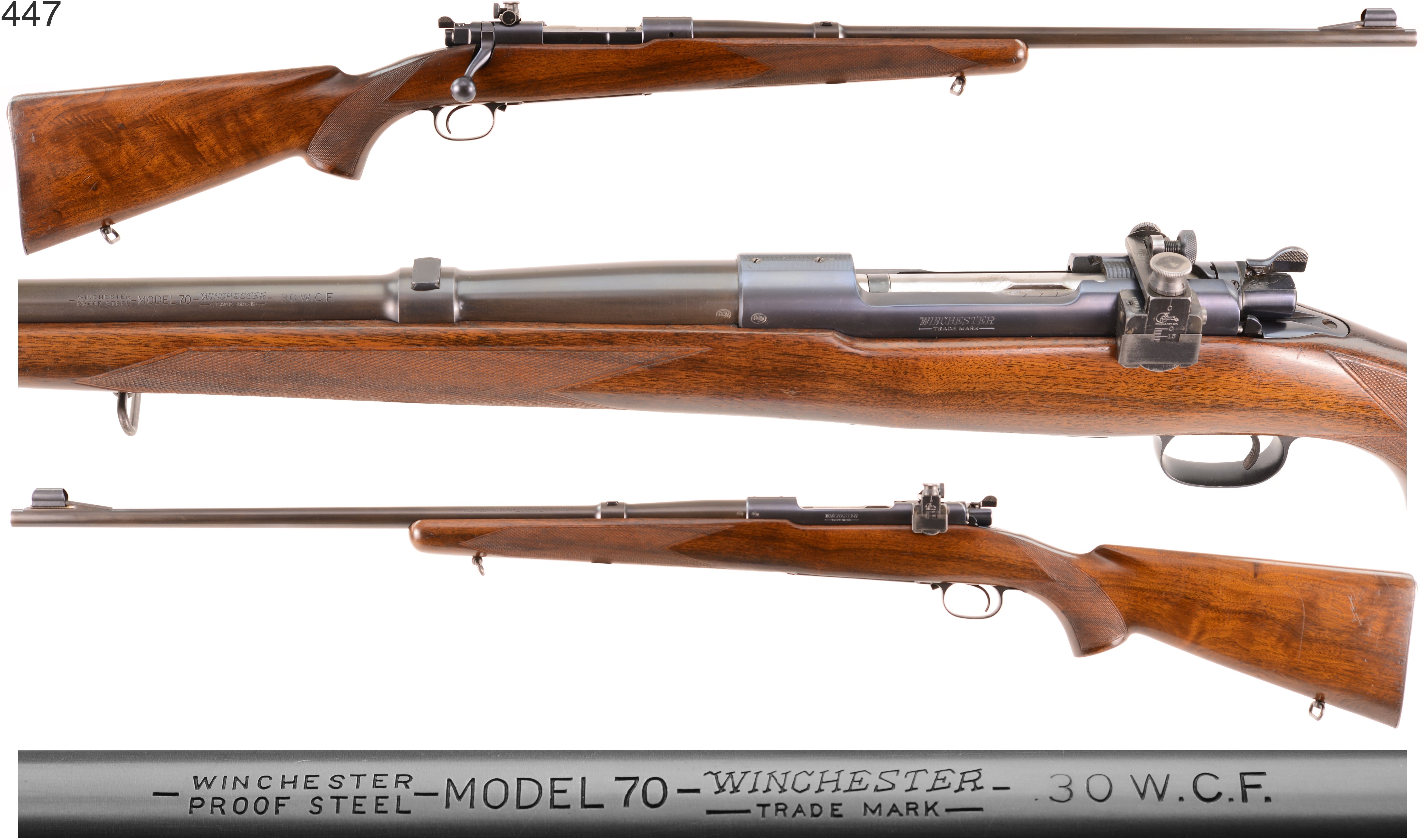

First off…  There are no existing factory records from any period of pre-64 M70 manufacture that can document style/chambering by serial number.  I wish there were, but there aren’t…  So without some kind of believable provenance, like a receipt from the factory R&D vault or solid record of ownership from day one, all M70s in “uncataloged chamberings” are, at best, “real” in the eye of the beholder.  This is as true of guns I own as it is of any others…
Second…  Winchester offered via their catalogs a fair number of special order options.  In this vein, rifles in CATALOGED chamberings but uncataloged styles, like National Match rifles in any chambering (except 375 MAGNUM) or Target Models in NRA style standard stocks, were specifically mentioned in the catalog.  What was NOT mentioned in any catalog I’ve found, were rifles in any style in an UNCATALOGED chambering.  This is not to say that a few such rifles weren’t built, either for eccentric well-to-do clients or as R&D projects, but then we circle back to provenance…
Third…  The M54 was cataloged for several years in 30 WCF, just as it was in 7.65 M/M and 9 M/M Mauser.  It is likely true, given Winchester’s reluctance to throw anything away, that any leftover M54 barrels in those chamberings were ultimately used to build M70s.  But the prevailing opinion (meaning George Madis) was that such rifles were built to “dump” unwanted parts, not as prized “special order” deluxe rifles.  So most, if not all, were in Standard Grade….
Fourth… The 30 WCF was particularly unusual in this regard, as the chambering had been dropped from the catalog before the adoption of Winchester Proof Steel (CMS) barrels in 1932, with their integral forged front sight ramps.  Factory 30 WCF M54s had Nickel Steel barrels (marked as such) with pinned front sight blades…  In other words, Winchester had no reason to make 30 WCF barrels from CMS in the M70 style.  Did they make them???  Apparently they did make some, as a few legit ones have been claimed…
Finally… There was, apparently, at least one M70 built in 405 WCF, just as there was at least one M21 double rifle built in that chambering.  Those came from the factory R&D department/vault, apparently with documentation.  Yet I know of a single individual in PA who has personally owned/sold about (10) “legit” 405 WCF M70s…  Either he has/had a direct connection to the factory or something smells funny… You make the call… Wink
Do you have serial numbers on either the 30 WCF Super Grade or 405 WCF you handled?  I’d like to check them against the M70 survey to see if they’ve turned up before.  Sadly, it has not been uncommon for today’s 30 WCF Super Grade to have once been recorded as a 30 GOV’T’06 Standard rifle…
Short story is “caveat emptor”. Frown M70s are one of the, if not the, most often faked Winchesters and I’ve recorded many more of them in 30 WCF and 405 WCF (etc, etc) that it’s likely the factory ever made…
Just to prove I’m F.O.S… Here’s a 30 WCF Standard rifle… One of mine… Is it “real”???  It’s “provenance” only goes back to 1990…  I’d have my doubts… Laugh

Yes… The barrel on that gun has a flat breech and 6 groove rifling with 1 in 12″ twist, not 4 groove with 1 in 10″ twist like the 30-06.  The reason that doesn’t give me comfort is that the M54 was regularly made in 30 WCF and the breech/bore specs are well known.
In the interest of FULL disclosure, the stock on the rifle in my photos is not the original.  The stock that was on the gun was cut slightly short, albeit still with the metal butt plate, there was a superficially addressed chip behind the bolt handle, and the pistol grip had once been flattened off for a (now absent) grip cap. All fairly subtle issues, but definitely altered from factory.  For “display purposes” I put it into an intact early standard stock with similar wear, but of course I’ve still got the original wood…
