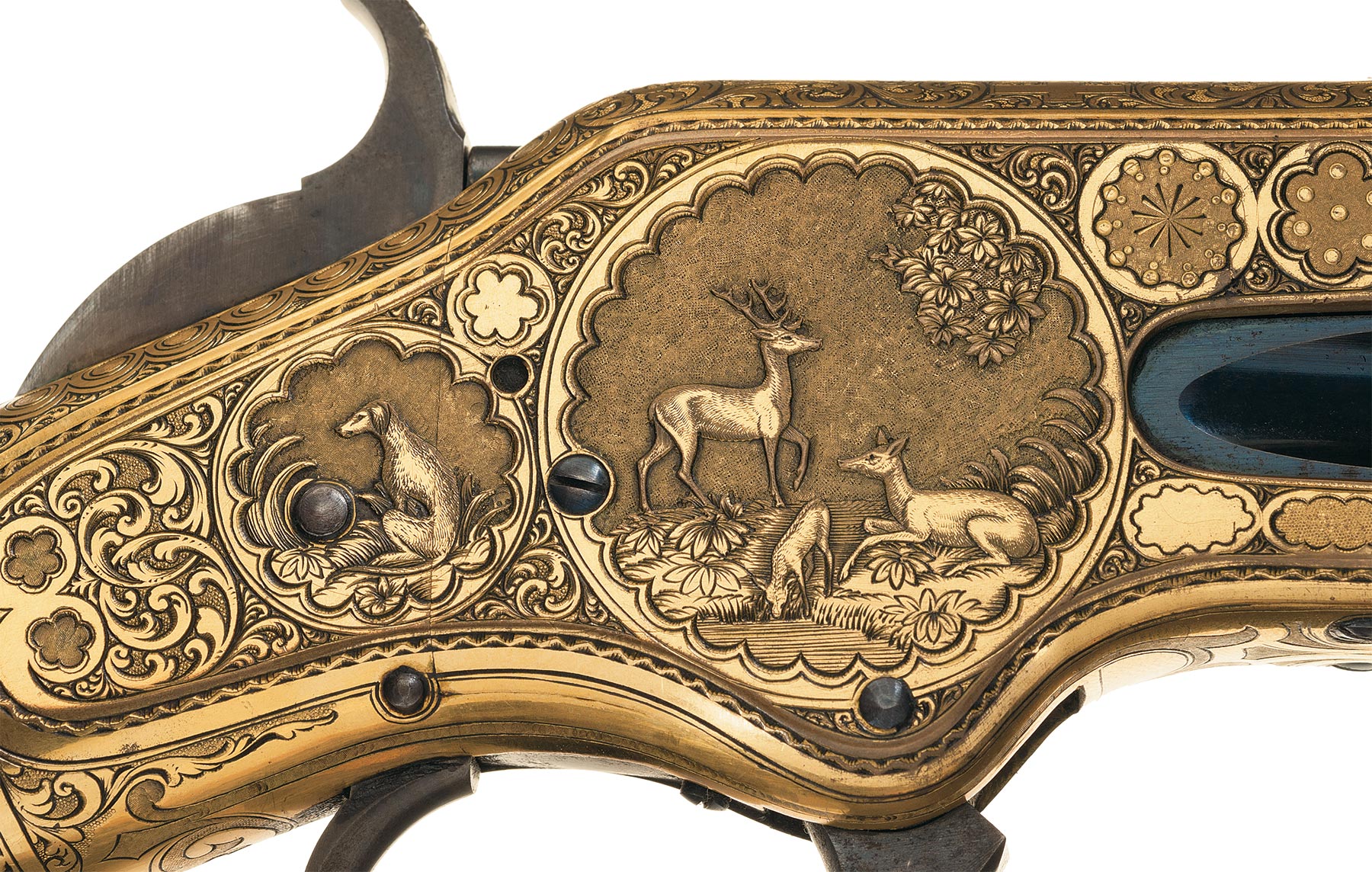

You want to contact Pauline Muerrle At paulinemuerrle.com. She was a Winchester engraver and can give you a idea who did the engraving with good clear closeups.

The engraving of the deer in the circle looks like it was done by a different, less accomplished engraver than the rest of the receiver.  Perhaps it was shipped with the center blank.
Here’s what a Conrad Ulrich engraving looks like:

I have a John Ulrich engraved Model 1890. I’ll send a couple pictures to anyone to post for comparing the engraving on the “86”. I don’t have posting privileges.
I agree.  The deer are poorly done.

For $5 the engraving is fairly plain, I would of expected a more elaborate engraving.

Here is my take on your Model 1886 Engraved Rifle:
It appears that the rifle has seen considerable use, Case Colored Frame that has a slight remnant of color on the bottom of the loading port spring cover, the wear of the forend wood in picture #1, plus the lack of definition in the engraving.
It appears to me that it is a Special order Model 1886 with Factory Engraving,
Of the Style #10 with a Vignette of Style #7,
Looking at the Border Scroll of the Engraving, it is in the style of John Ulrich,
Taken from the Winchester Engraving Book, Chapter V, Signed Arms by John Ulrich, pages 168, 169 pictures,
The Vignette was taken from the Winchester Engraving Book, Chapter VII, Winchester’s Highly Finished Arms, page 231. (the deer were substituted for the moose)  The Vignette on your Model 1886 has the same fancy border within the circle of the Vignette.
The Deer within the Vignette don’t appear to be stick figures to me at all. They do lack definition, because of wear, but you can plainly see they are not stick figures and appear to be of character, (#5 on page 231) of the time frame your Model 1886 was produced.
The time frame that your Model 1886 was manufactured, seems to be the normal coverage of Style #10 with a Vignette of #7 with what I would say was a good amount of coverage for $5.00, but I am guessing it cost $6.25.

Well a very !! Pleasant turn of events . Pauline Muerrie was so kind as to state ” definitely Ulrich engraved ” I have sent appropriate funds to Pauline to supply a letter of opinion to me and also any research she may do with records onhand, available to her . Thx guys for the help !!

Hey there Accumulator,
Was there ever a doubt about it?
Glad you kept us in the loop with updates….http://www.cumminsforum.com/forum/images/smilies/Thumbup19[1].gif

July 19, 2016 - 9:34 pm
Lol , well , ” no doubt ” or others , always leaves doubting Thomas’s the opening of ” possible ” maybe , or that and a $1.70 gets u a cup of coffee. Now if ? And when , she comes off the wall , those nay Sayers can argue with Pauline . I appreciate all the help and motivation to Persue this as far as I can to a conclusion .  Cheers
