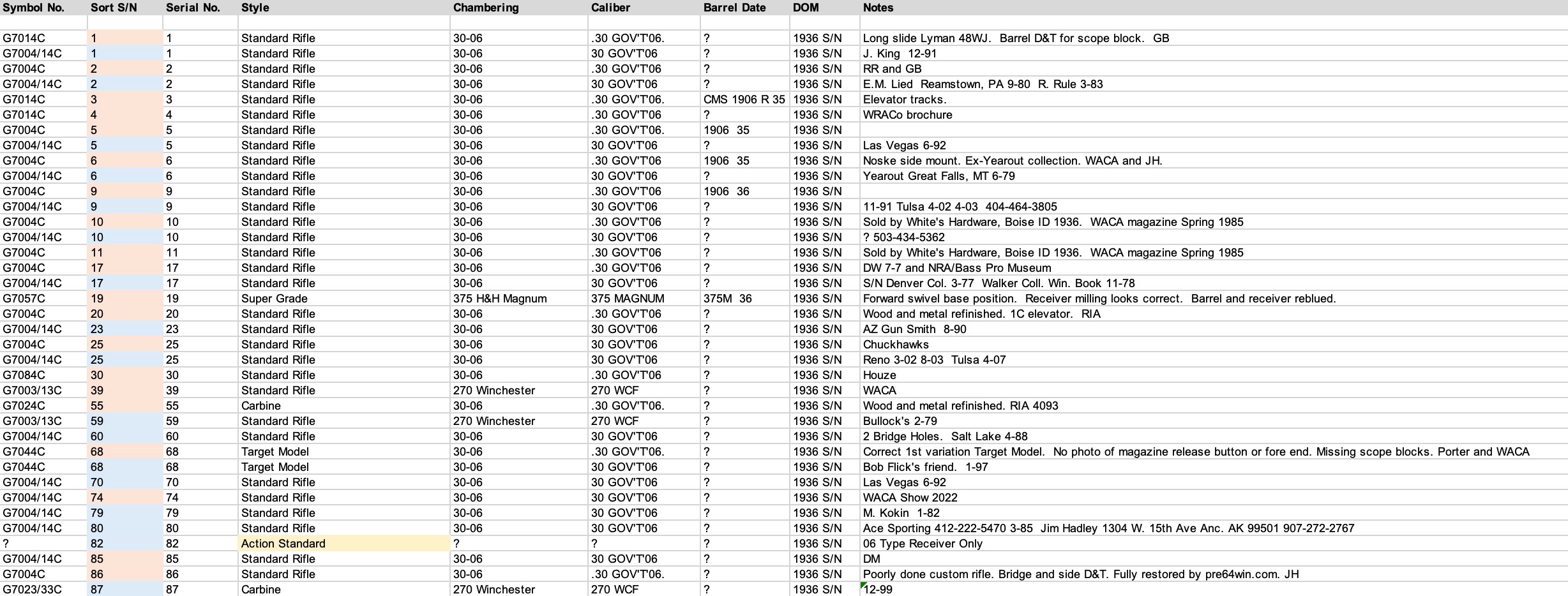

Forum Posts: 1540
January 30, 2026 - 8:54 pm
Dave and Bert-
Below is a clip from the “combined/condensed” M70 survey covering the first 100 serial numbers.  Guns recorded by Bob Porter have blue shaded serial numbers, while mine are pink.  Hence there are duplicated entries.  My survey sheet is much more detailed, but this is limited to the information on Bob Porter’s cards.
In any event, we have (29) of the first (100) recorded.  Twenty-eight here, plus I picked up s/n 12 (30 GOV’T’06 Standard rifle) since I last merged the surveys.  It’s clear that most of the first (100) were 30 GOV’T’06 Standard rifles, as has been claimed.  I know s/n 68 is a legit Target Model, as I’ve handled it.  I’ve also seen s/n 19, now a 375 MAGNUM Super Grade, but I don’t know what to think of it.  The first “batch” of H&H receivers shows in in the mid-600’s.  The receiver on s/n 19 looked OK to me (not a modified Standard receiver), and if it was a 375 Magnum it would have been a “pencil barrel”.  It does have the early front swivel position you’d expect on a 1936 Super Grade, but  it’s such an outlier that I’m suspicious…
Short story is that an “observational survey” will never take the place of a factory record, but it does have its uses… Laugh
