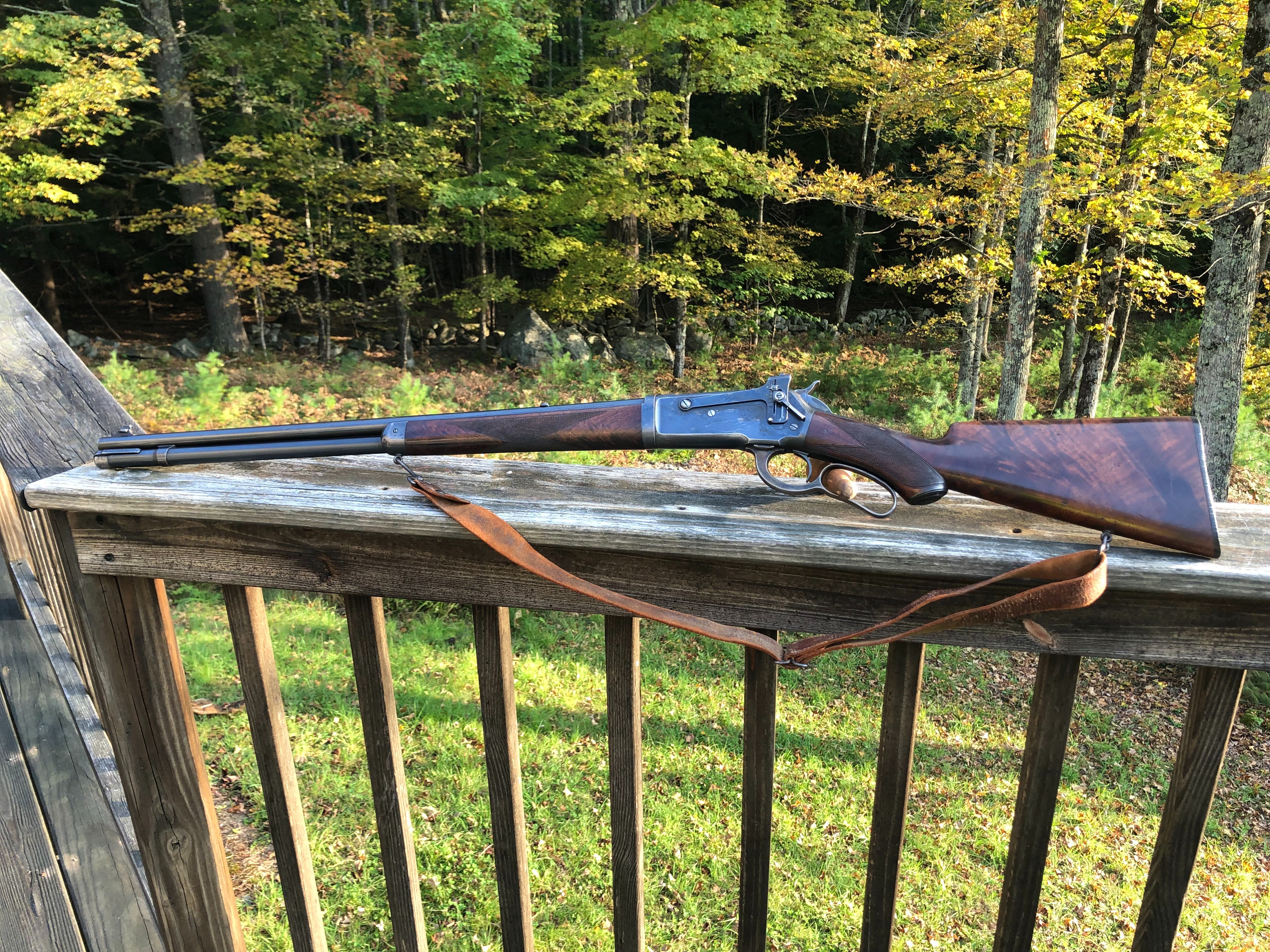

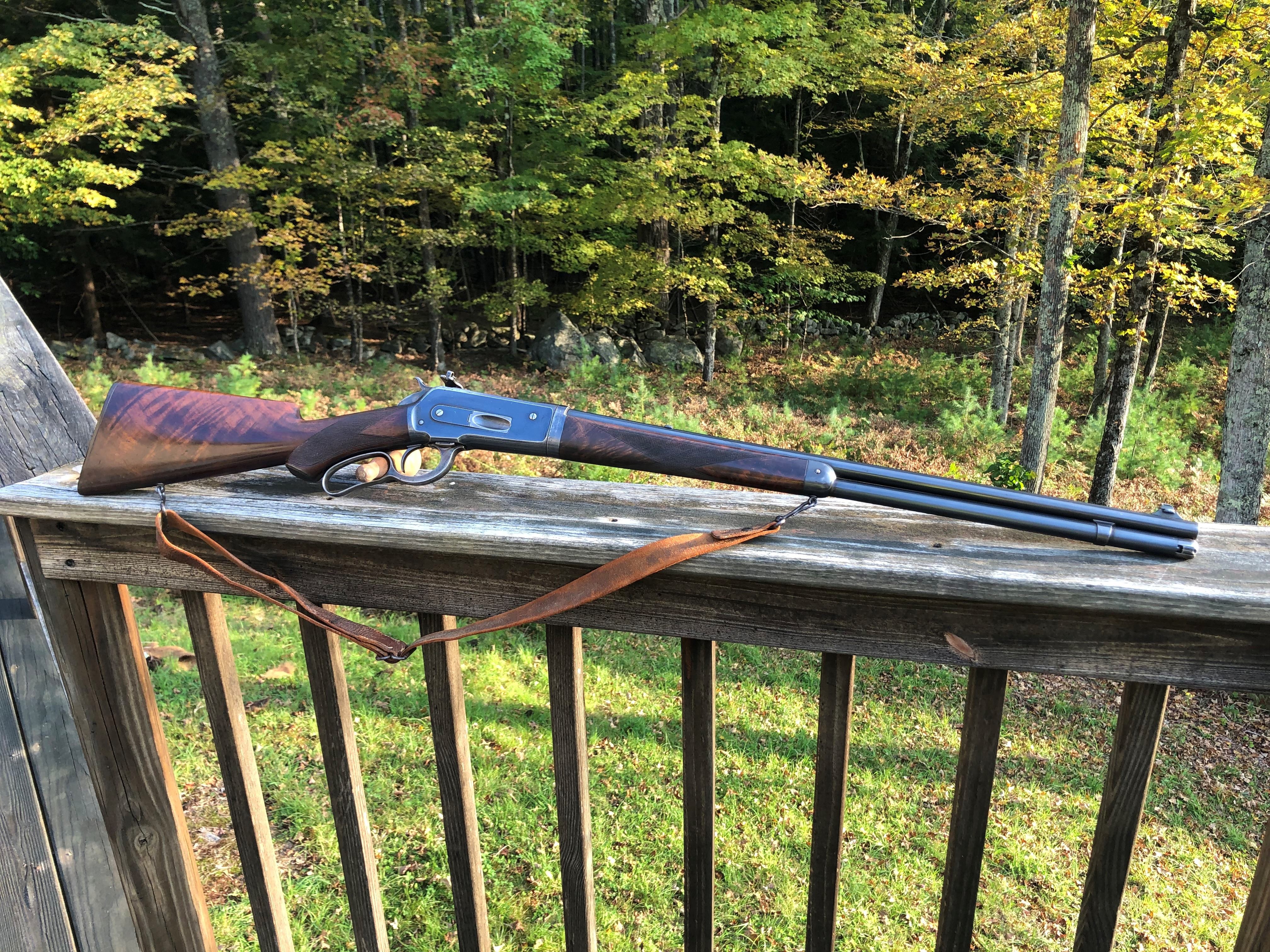

Can’t help much here, but will throw it out there, as my earliest 86 in 33 is #128934. Received December 24, 1903. No R&R. must have been a Christmas gift, Was to me!
