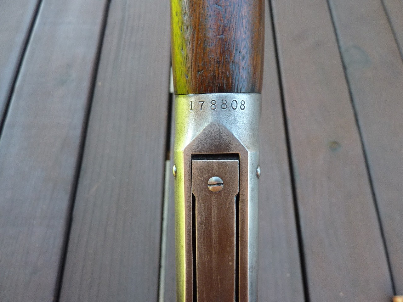

Ya’ Don: here’s another one of those “impractical”, carbines. I like ’em to.20240109_093757.jpg20240109_093815.jpg
Henry,
You have been holding out on me… I did not have this SRC listed in my research survey!
The correct date of manufacture for it is June 1911.
