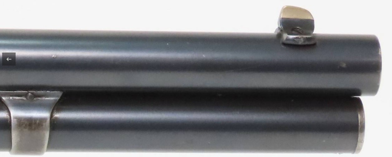

The front sight that you used is not a Rocky Mountain Sporting (RMS) sight, and per the factory ledger information, the front sight should be a standard “sporting” sight (No. 21 series).  A true RMS sight continues to taper all the way to the barrel on the front (forward) end of the sight.  Further, they were blued steel unless specifically ordered with a different color blade (German Silver, Copper, Brass, and Ivory).
Thanks Bert. A couple of questions:
What kind of front sight do I have? Is this sight at least period appropriate for this rifle?
How do you know from the ledger info that it was a standard front sight? Is it b/c nothing special was called out? I was a little disappointed when I got the ledger info that the column header information was not provided.
-Fred
December 5, 2025 - 6:34 pm
I am not sure what type of front sight you have, but it is not common to any of the Winchester lever-action models that I am familiar with.
The basic rule of thumb for the Winchester warehouse ledger records is this… if nothing is mentioned or listed, it was standard (per the catalog).  Barrel lengths were only listed if they were something other than standard, magazine tube lengths were not listed unless shorter than full length, butt stocks & butt plates were not mentioned unless special ordered with a non-standard feature.
Model 1894 Sporting Rifles were standard with a No. 21 front sight.  The height of the sight varied depending on the specific cartridge.
Roger all. Sounds like I should be on the lookout for a 21C at about 0.38″ height?
I believe you need a 21A (the 21C was for the smokeless powder cartridge, e.g. 30 WCF, 25-35 WCF, and 32 WS).
